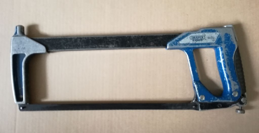

                                        Nicholas Farr
                                          @nicholasfarr14254
                                          Hi, I had three of those Eclipse tubular hacksaws from the seventies, but I gave one to one of my sisters. However this Draper Expert one I've had for about twenty odd years is my favourite, it's a quick release one and is very ridged and has provision to hold the blade at 45 degrees, but one of the pins that hook onto the blade is missing.
                                          Regards Nick.
