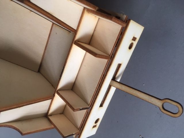

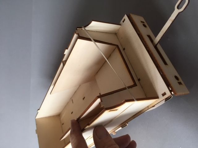

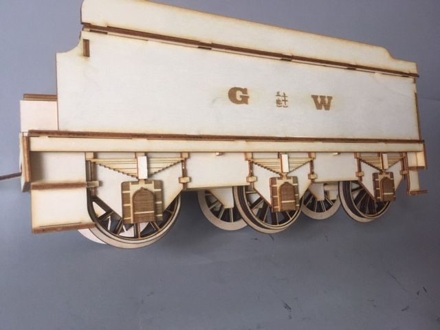

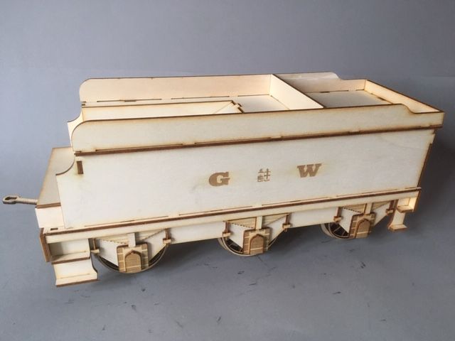

      Creating the footplate that is the forward most part of the tender and showing the sides of the tender being glued in place .
      #467452
      RICHARD WILLS 3
        @richardwills3

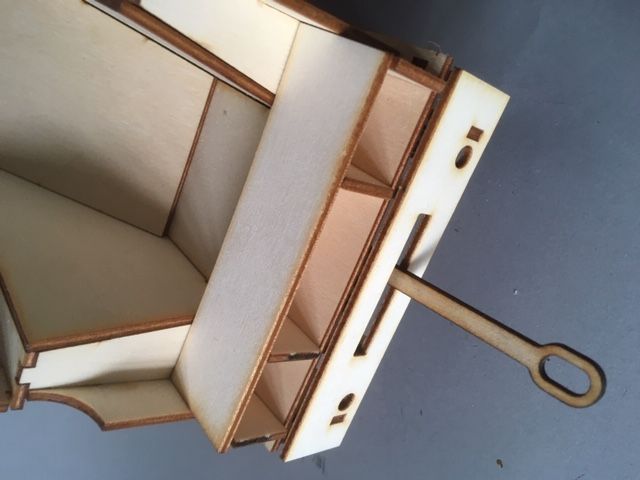

        Top plate goes on for the fireman to sand on .

            Tender finished apart from a few small details like the water tank dome and coupling hook .

              Lower shot of the axle box detail . Quite effective and appears " busy" enough to look believable .
              GW is pre etched on the Tender sides , although this could be deleted or changed .

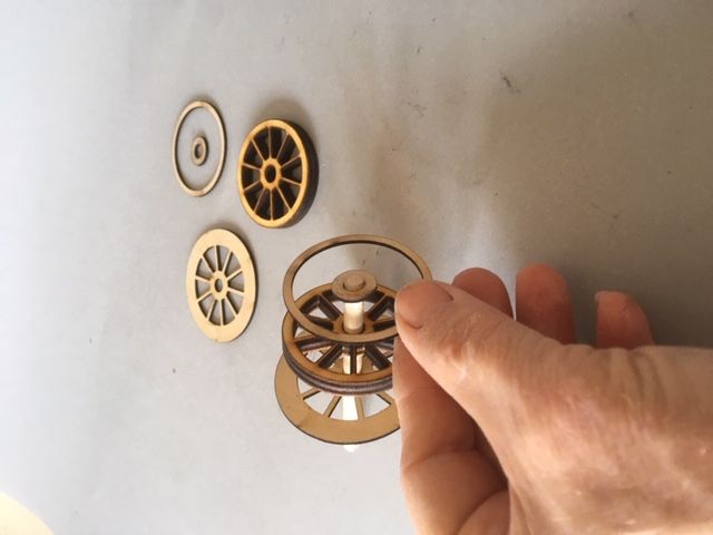

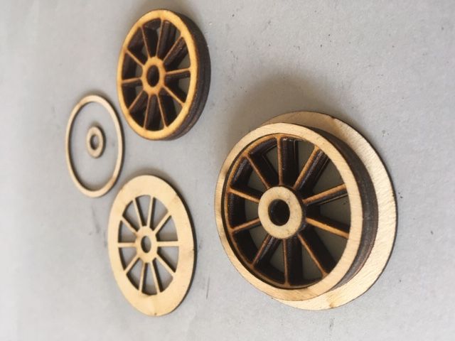

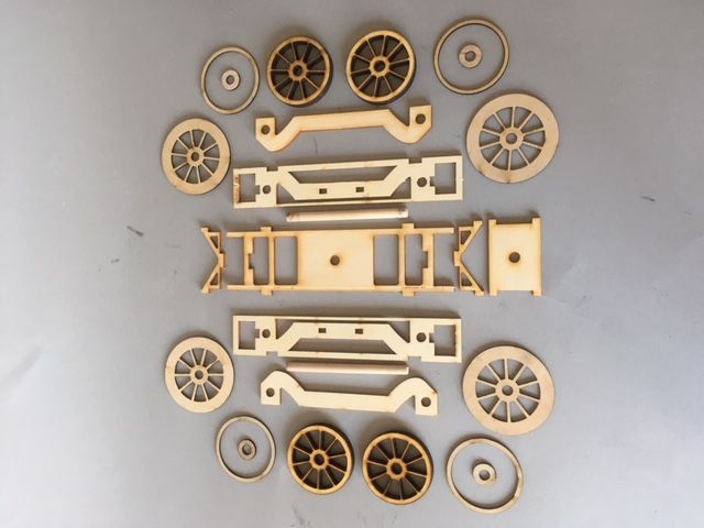

                Ok , so lets move onto the Loco itself . Starting with front bogie .bog1.jpg
                #467574
                RICHARD WILLS 3
                  @richardwills3
                  As with the previous tender wheels , we are making the laminates up on one of the axles , taking care to minimise the glue and get none on the surfaces that show . Notice that these wheels have an additional front hub disc compared to the tender wheels .
