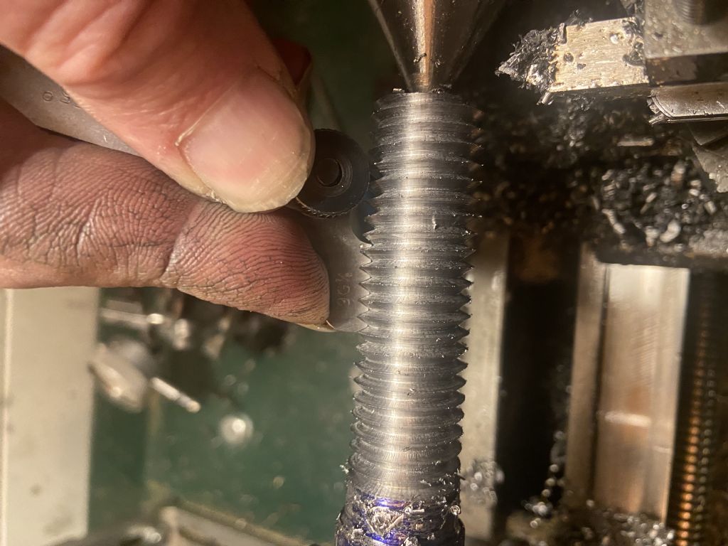

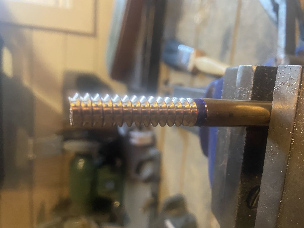

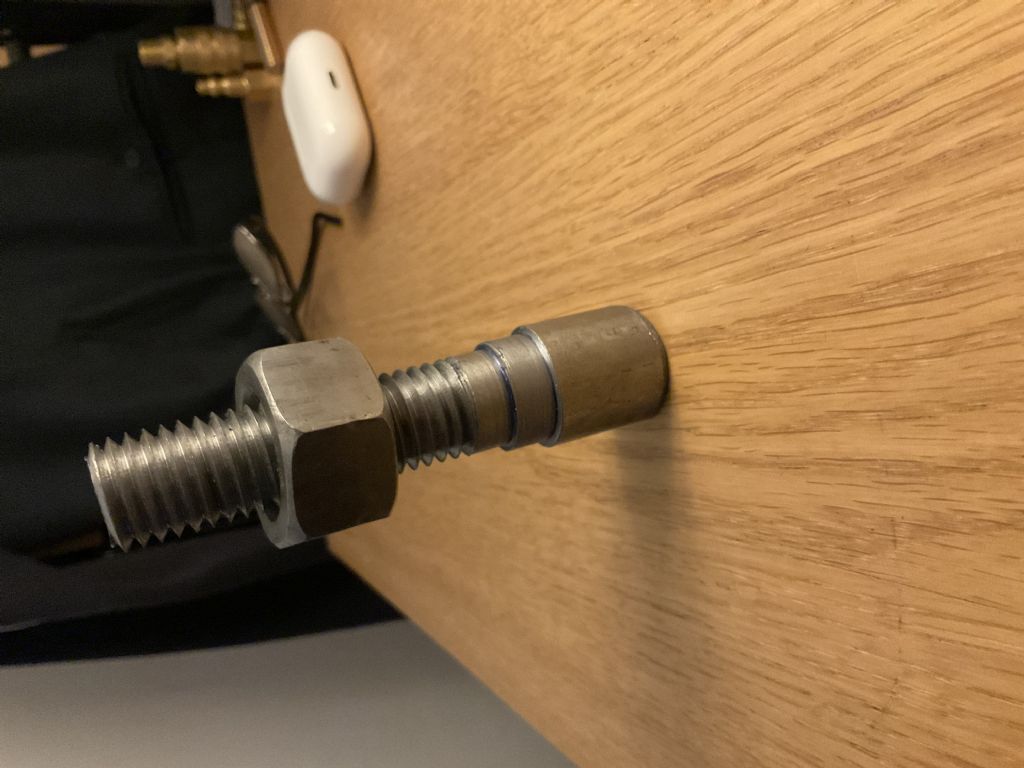

                7/8 9 TPI BSW in steel
                Unfortunately it’s not 7/8” cos I had to start again and turn off the first thread, but once I’d solved the problem (play in lead screw) it started working properly. But very nearly right, getting better every time. It actually holds a 7/8 nut albeit rather sloppy.
