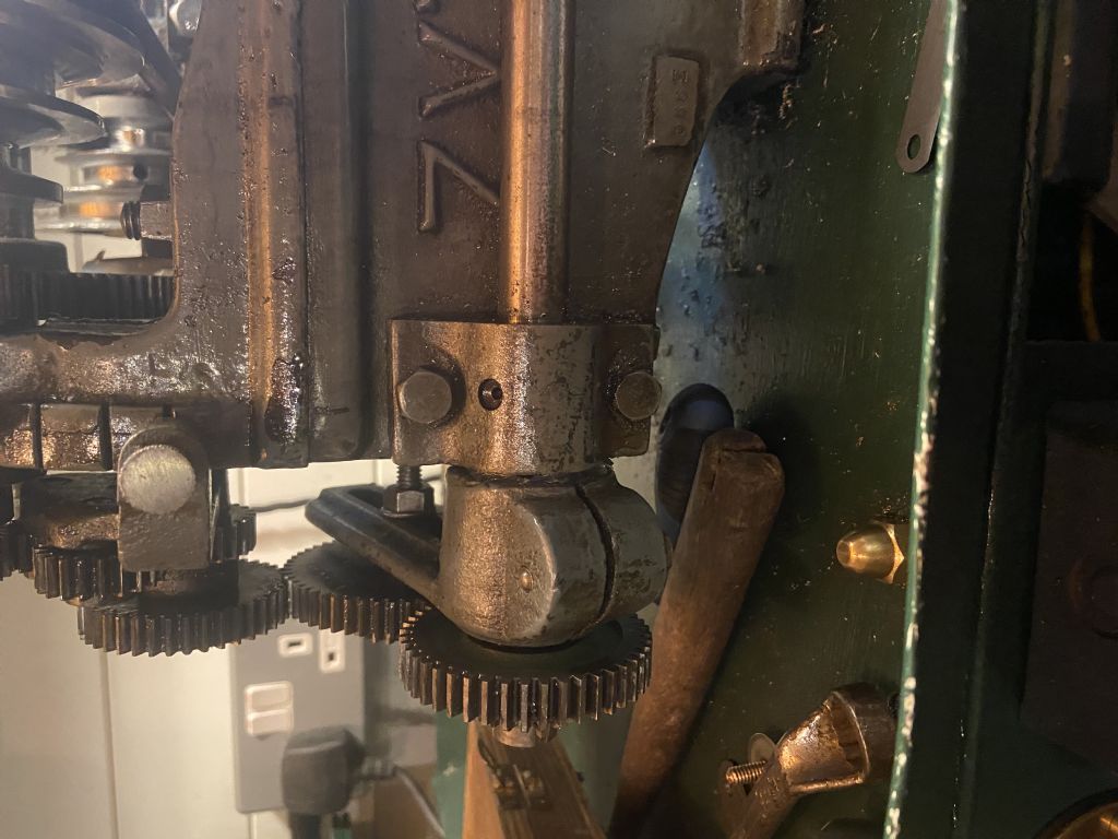

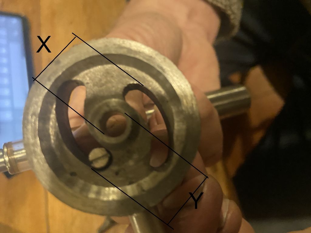

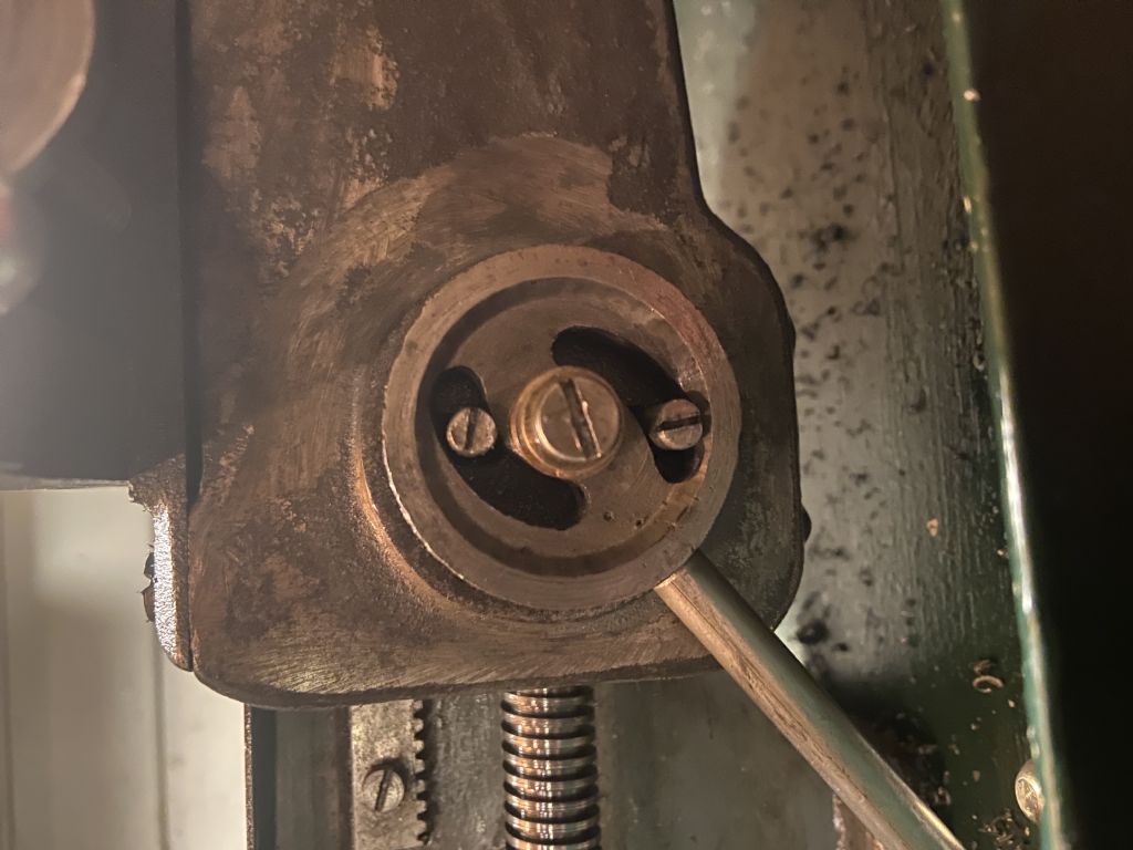

        I agree Howard. So I have had it all apart again and this time I have worked on adjusting the gibs, so that the is no slop in the movement of the half nuts. Now gravity plays no part and they basically stay where the lever/cam mechanism puts them. This removes another variable.
        I’ve been looking very closely at how the half nuts disengage. The lower nut disengages properly, but occasionally, the upper nut sticks. When the apron is off, now I have adjusted the gibs, the nuts behave in a very predictable way, with no movement other than that caused by the lever.
        So I think the upper half nut must be catching somehow.
        The whole mechanism that supports half nuts is interesting. When the half nuts are closed, they stand a 50-50 chance of landing on a trough rather than a crest of the lead screw. Usually, one doesn’t notice this, the lead screw turns and the half nut just slips into the thread. For me, for some reason, that isn’t happening correctly.
        The top half nut is in bad condition with 2 of 8 threads basically stripped. Whereas the lower half nut is in good condition.
        I have also turned around the lever to match the other Zyto lathes on YouTube. This seems to make the pins look the right size.

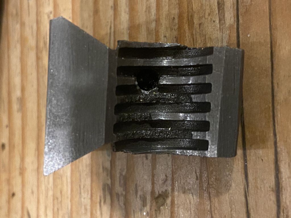

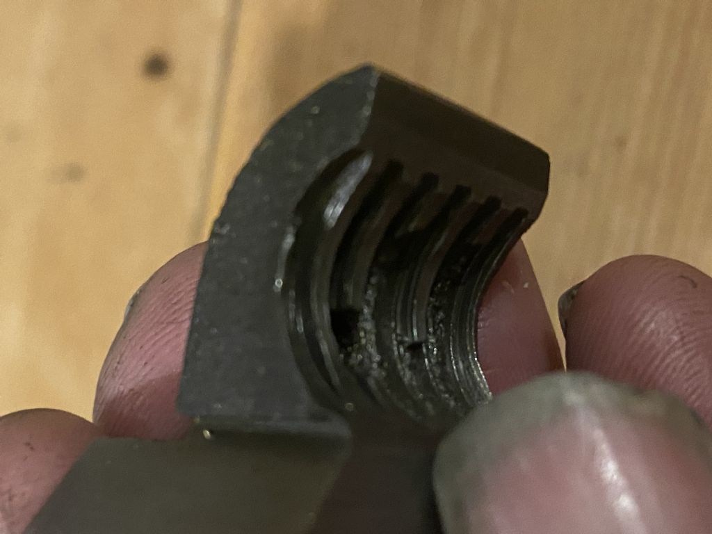

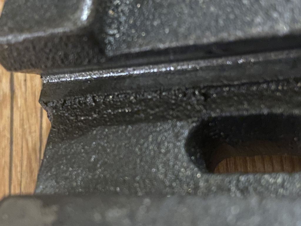

          Closer look….
          Bottom half nut in good condition
          Top half nut with 2 1/2 knackered threads. It also has a threaded hole bored in it to accept a screw which hold the lead screw guard. It looks worse in the pic than it actually is… and indeed has worked like this until recently. But clearly it needs renovating.
          More importantly, there is a burr on either end of the top half nut which could be impeding the correct engagement and disengagement of the lead screw.
          There is also some “bobbling” of the metal surface next to the dovetail, which has probably always been there, but it may not help the half nut to move smoothly when the gibs are tightened.
          So, plan A is get to work with a file in the morning and fix these bits as best I can, and see what difference it makes.
          Plan B is to renovate the top half nut, which clearly needs doing. I’m getting some ideas for how to do that.

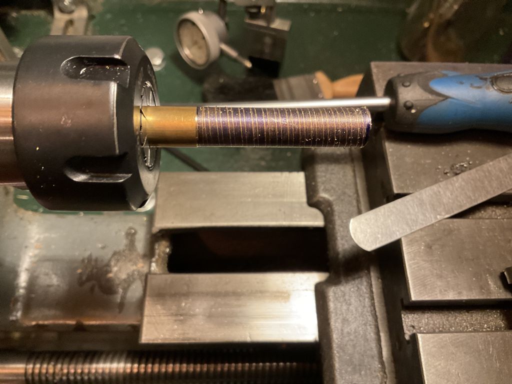

              Have you got a threading dial and are you using it correctly? That multiple pass looks just like the result of engaging the half nuts in the wrong part of the leadscrew. You are getting a perfect helix but not in the same place each time.

                Posted by Martin Connelly on 27/11/2021 08:37:24:
                Look at this album for information on the threading dial Understanding the threading dial
                Martin C
                Hi Martin, yes and yes, you kindly provided that document to me a while back. The trouble has been that when I engage the lever, the half nut hasn’t been engaging, it skips and engages 1/8 of a wheel turn after. If you see the pic of the upper half nut above, frankly it’s amazing it works at all.

                              I’ve taken a look at the lead screw mechanism as you suggested. The lead screw itself has very little wear at .625 pretty much everywhere, so that’s good. Using a m&w depth micrometer, the distance to the lead screw from the bed is .614 at the tailstock end and .592 at the change gear end, so it is slightly slanted down at the headstock end. I’m not sure if 0.022 is enough to make a difference, but I may as well sort it.
                              I also realised that there is about 2mm longitudinal play in the lead screw, which I’d think could make a big difference. Again, I will sort that.
                              I have a feeling that all this started when I reconfigured the changewheels for the first time a couple of weeks ago. The V bracket that holds them was very stiff and took quite a bit of freeing up. Looking at the location of the change wheel bracket (whatever it’s called) right next to the lead screw adjustment, it’s easy to see that I could have knocked the lead screw out of alignment.
                              When I escape from the kids I will sort all these things out and see what difference it makes.

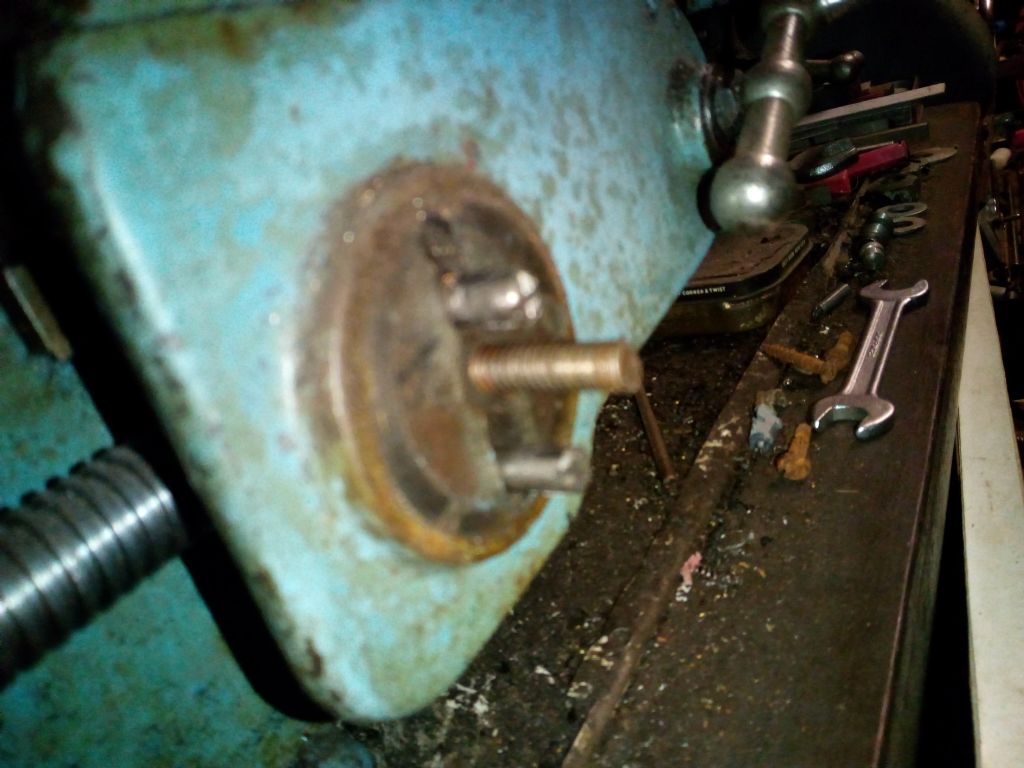

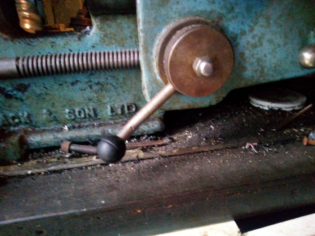

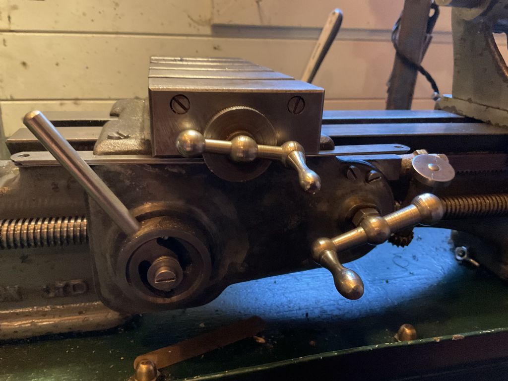

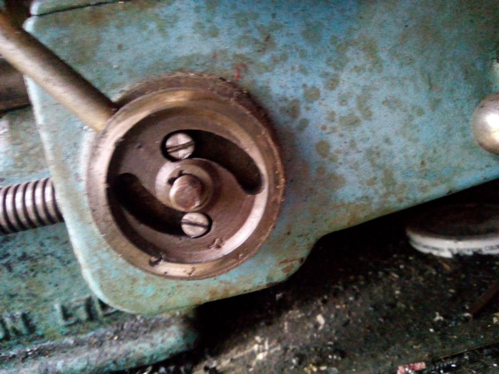

                                Steve,
                                I've just had a closer look at my Zyto and taken a couple of shots of it.
                                When i look at your first photo there appears to be a substantial clearance between the scroll slots and your pins,( wobbly threads on another query) On my machine the pins are a reasonably close fit to the slots and my take is that your slots are badly worn or maybe modified. It is the proper fit of these pins in the slots that gives you the lock in of the half nuts. You need a, uniform width slots and b, good fitting pins in the whole length of the slots to keep the half nuts engaged.
                                Not to be recommended but strictly speaking a single thread on your top half nut should be sufficient to produce a good screw thread on your workpiece, at least for a limited time!
                                I notice that you do not show a large washer over the lever assembly. For what its worth mine has a full diameter cover washer which has a tapped hole in the centre. The pivot shaft has a screwed extension onto which the washer screws and then it is locked in position with a domed nut, which is then used to control the fit of the lever assembly . Too tight and you can't turn the lever.
                                Depending on your skill level I would be filing out the slots to a suitable drill shank al the way along the slots, then making two oversize pins to suit the slots and having another go.
                                Regards Bob D

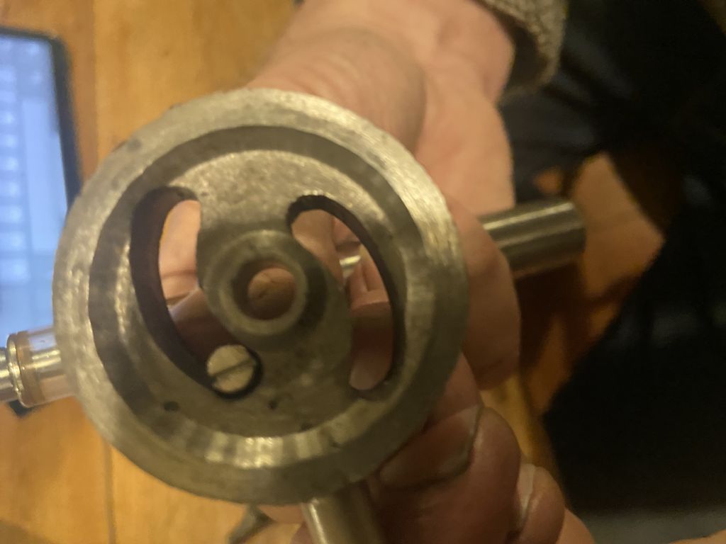

                                  Bob
                                  it’s great to hear from someone who actually owns a Zyto lathe! It’s been a bit of an uphill battle for me, having little experience myself, and not knowing how the lathe should actually be. I’m sure they have all been modified over the years, and there would’ve been numerous revisions from the manufacturer as well.
                                  Can I ask a question, what diameter are your pins, and what diameter is the slot?
                                  My pins are 3/16, and several other Zytos I’ve seen look to have the same.
                                  My slots are just under 1/4”, about 0.230.
                                  Are there any shims between the apron on yours and the top of the carriage?
                                  Another pic of mine with the pin in the same position as yours, looks remarkably like yours.
                                  The problem really does seem to be the pressure that it is putting on the lead screw,
                                  cheers and thanks for your input.
                                  Steve

                                    Robert Dodds
                                      @robertdodds43397
                                      OK Steve,
                                      My pins measure 0.250" -.001 and the slots take a letter E drill shank (0.250" end to end whilst a letter F drill (0.254"is tight in spots. With the lever assembly off it's pivot pin the two pegs slide freely up and down as long as I align the nuts and leadscrew. Move the saddle a 1/16", lifting the top nut up out of mesh while the.bottom one falls out of mesh under it's own weight and the two half nuts are restricted in movement until I move further and realign with the leadscrew.
                                      I've never had occasion to remove the apron but I cannot detect any shims or need for any. Remember, adding excessive shims also affects the engagement of the rack and pinion associated with the manual feeding of the saddle. With the half nut mechanism reassembled and the threads aligned to the leadscrew I can engage and disengage the half nuts and detect no movement or strain on the leadscrew anywhere along the length of the saddle movement.
                                      The earlier thread of yours about wonky threads on the pins that screw into the half nuts may have some bearing on the problem . There has to be some symmetry about those pins, the half nuts and the leadscrew. A wonky screw will cause one half nut to engage before the other and that, together with excessive clearances to the two slots and you will get the sort of disengagement problems you are seeing.
                                      Get your slots uniform in size and round particularly at the nut closed position. then produce two pins of a diameter to suit your slot size less 0.002" to 0.005"and get the thread as concentric as possible . I would remove shims at initial tryout as I doubt that it left the factory with shims. After all they cost less than £20 in the thirties so didn't get much individual attention.
                                      Clear out any burrs or dross that may still be in the dodgy half nut and whilst loose, check it's engagement with the leadscrew. Put it all back together and with the nuts/ leadscrew aligned check to see if the leadscrew is being lifted/ lowered as you engage the nuts.
                                      Once again I would say, not as a recommendation but as matter of fact, your machine should be able to screwcut with one half nut just a plain bore to suit the O/D of the leadsrew. The other half would do all the work and feed the saddle along. After all your quick release engineers vise only has a half nut and see what forces that can stand!!

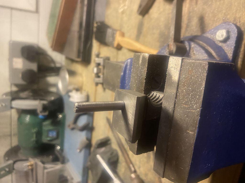

                                        Robert has confirmed what I suspected, that the 3/16 pins were a later, incorrect, modification.
                                        The problem with any pre owned machine, particularly a really old one, is that there is little way ofknowing what incorrect modification shave been done.
                                        The half nuts jumping out, probably caused by the incorrect pins being fitted, may be the reason why the lathe was sold,
                                        Getting it back to original specification, as closely as possible, has to be the first step along the road to correct operation.
                                        With regard to Leadscrew alignment, may i suggest the following as means of effecting an improvement?
                                        (Having made two new 1/4" diameter pins, with 3/16 BSW threads, hopefully the half nuts will engage satisfactorily. )
                                        1 ) Slacken the bolts retaining the Leadscrew bearings at both ends of the bed.
                                        This will allow the Leadscrew to move in the vertical plane.
                                        2 ) Move the Saddle to the Headstock end and engage the half nuts. It may be necessary to rock the chuck to and fro to obtain engagement.
                                        3 ) Tighten the bolts
                                        4 ) Disengage the half nuts, and move the Saddle to the Tailstock end.
                                        5 ) Engage half nuts.
                                        6 ) Tighten bolts.
                                        Disengage half nuts and recheck Leadscrew alignment measurements. Hopefully they will now be more alike!
                                        This may be the time to reshim the Apron to ensure optimum alignment with the Leadscrew.
                                        These processes might need to be repeated to get the best fit and operation.
                                        If the banjo is tight to move, that is another problem to investigate and solve, but AFTER the above has been completed and finalised., without any further movement of the Leadscrew bearings!
                                        Eliminate one problem at a time, or you will merely confuse matters and not know what is causing what.

                                          That makes a lot of sense Howard. The thing that’s perplexing me though, is that there is no adjustment at the tailstock end – the support for the lead screw is cast into the bed. There is adjustment at the headstock end, but I unbolted it last night, but surprisingly the amount of adjustment available was very, very limited. Maybe 1mm of play up and down, essentially the play in the holes that hold the bolts. I was able to lift it slightly and re-bolt it, which seemed to place the lead screw parallel with the bed, as confirmed by a depth gauge.
                                          I came to the conclusion that the adjustment available was only to enable the lead screw and bed to be parallel, and the vertical placing of the half nuts was done by shimming the apron.
                                          Or something else, but I’m running out of ideas!
                                          Pic shows the bolts I unscrewed,

                                                Robert Dodds
                                                  @robertdodds43397
                                                  Steve,
                                                  Will your 6mm rod pass through the vertical slots in the apron or are they designed for 3/16" rod.in which case you will need to make them look like cheese head screws.
                                                  Reference the symmetry I wrote about, check the two dimensions indicated on your edited photo and see if they are near equal. They will determine which of your half nuts moves most when you rotate the "banjo"

                                                    Here we go…l
                                                    So….. it feels much more solid and decisive. It hasn’t skipped at all. Much better.
                                                    This is a .236” (as suggested) pin with the end turned down further to 3/16 for the thread into the half nut.
                                                    it does still flex the lead screw upwards slightly as it engages. Not sure why – might be because I haven’t got the measurement Bob pointed out quite right. Or something. I will try to cut a thread before work tomorrow.
                                                    Right now I need a rest from the damn thing!

                                                      Steve,
                                                      That looks more hopeful
                                                      You have a PM
                                                      Howard
