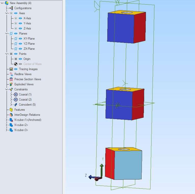

David, here is a good one that would have got Nigel confused.
Central cube is anchored to the origin.
Coaxial 1 & 2 set the top and bottom holes to the anchored one.
Coincident 5 sets the top red face true to the middle
Nigel then comes along and clicks the middle red face and the bottom red face and the bottom cube does not rotate and gives a red coincident on the tree. It can be done if you use the ref geometry for the lower cube or rotate it a bit by the mouse and then constrain the faces but won’t move otherwise
Is there a limit to how far it will rotate 2 faces about an axis?

Not sure if I understood your description correctly. Have just tried it here and when I try your final step it all works as expected – lower cube rotates to match the others, and the added constraint is healthy.
Obviously I did that using my own cube parts – which may have some differences form yours.
Can you add the failing constraint, then create a Package file from the assembly and send to me (I’ll PM you an e-mail address). I can take a look and report back.

Jason clarified the issue he reported above to me – it can be confusing!
If faces to be aligned are more than 90° displaced, the solver can’t decide which way to move things to satisfy it. This may actually be a bug (which I’ll report).
It can be resolved by either

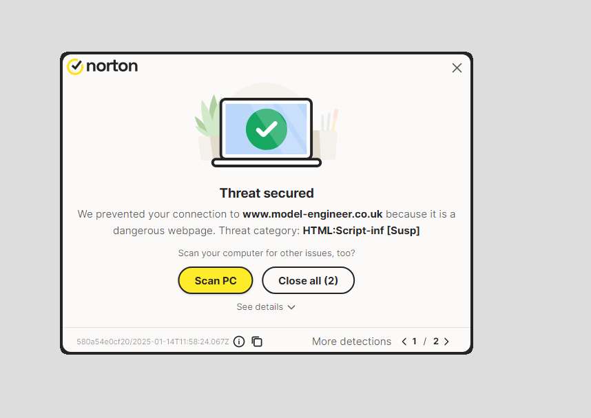

Has the image appeared now? I had forgotten to add it before I posted the message so had to use “edit” to put that right.
Oh, to add to the fun, I later closed the site. Then on re-opening it, Norton pounced:
Obviously threats to the civilised world and even the Internet, are cubes with hollows in them. Norton blocked the site, tried to sell me all sorts of digital placebos, and I used its “review” form to complain (it seems the only way to contact the company).
Though I have now regained access, this is not the first time Norton has obstructed legitimate access. It “quarantined” (destroyed) a genuine TurboCAD addition intended to allow up-dates. Luckily the loss of those up-dates probably does not affect my use of it.
