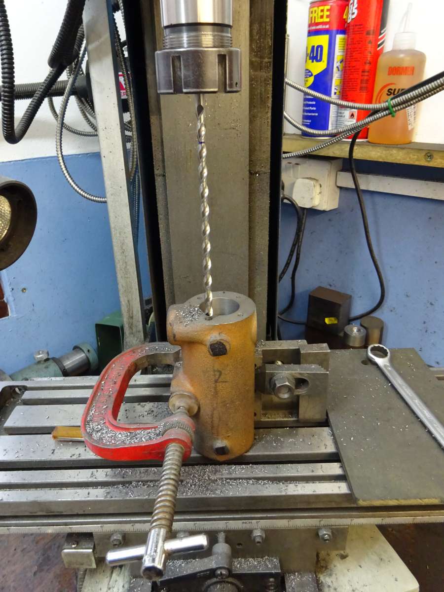

A resin print, even with the Mage Pro I had to split it into three parts. The surface finish on resin parts is exceptional.

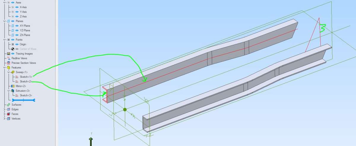

Chassis rails with gentle bends – could be done as a single feature using Sweep, or it could be built up from straight extrudes, and revolves to do the bends.
As for ‘fitting cross rails’ – you can use geometry from one part in an assembly to help modify another, this is possible even in Atom3D. This is done using ‘Edit Here’ mode and using ‘Project to sketch’ to transfer (say) section profile of one member into a cut feature on end of another. This is in the Help file, I’m also happy to show in a screenshare.
Part at ‘wrong’ orientation in assembly – remember you can hold down the Shift key, and drag with the mouse to ‘free rotate’ a part in the assembly space into roughly the right orientation. Final positioning is best done with assembly constraints. There is also a ‘precise placement’ tool which lets you specify exact moves and rotations (access this from ‘component placement’ icon on the assembly ribbon).
As David said your lazy Z shape lends itself to a sweep of the basic C section along a sketch that can be the inside edge of a rail. Mirror to get the pair and then another sketch to do the angled cut at the front.

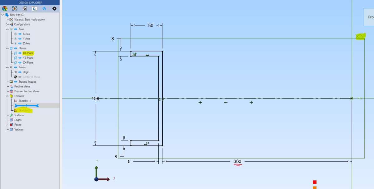

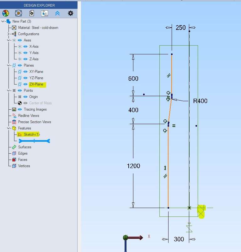

4 steps to a pair of chassis rails.
1. Select the YZ ZX plane on the tree down the left of the screen and click “activate 2D Sketch. The axis and plane swill move on the screen but the orientation is looking at the top of the chassis, rear at the bottom of the screen, front at the top.
Draw three lines to represent the rear, angled and front inner edges of the left hand rail. You can then dimension their lengths and the distance from the centre line of the chassis. I have just used random numbers but assuming at the rear there is 600mm between the two rails you can enter that dimension as 600/2 and it will then show it as the 300mm from ctr. This is an important dimension for future work. Don’t worry about the angle of the middle part it will sort itself out from the lengths and offsets of the straight parts.
If you want use the fillet tool to add some large radii to the bends but probably leave that off for now, you can go back and edit the sketch later to include them.
When you deactivate the sketch it will give a warning that it is not closed, this is OK as it is just a guide line so click ignore
2. Click the XY plane, again the orientation will move about and leave you looking at the rear of the chassis. Sketch the C shape of the left hand chassis leg. I did a rectangle then added the three inner lines and trimmed the bit of rectangle to open up the C but any way will do. Symmetry tool set it equally above and below the mid line. It is important that you enter the same 600/2 or 300mm dimension so that in the next stage your guide line meets the inner edge of the C shaped sketch. You can then deactivate the sketch, should not get a warning on this one and you will see the two sketches in red meet each other.

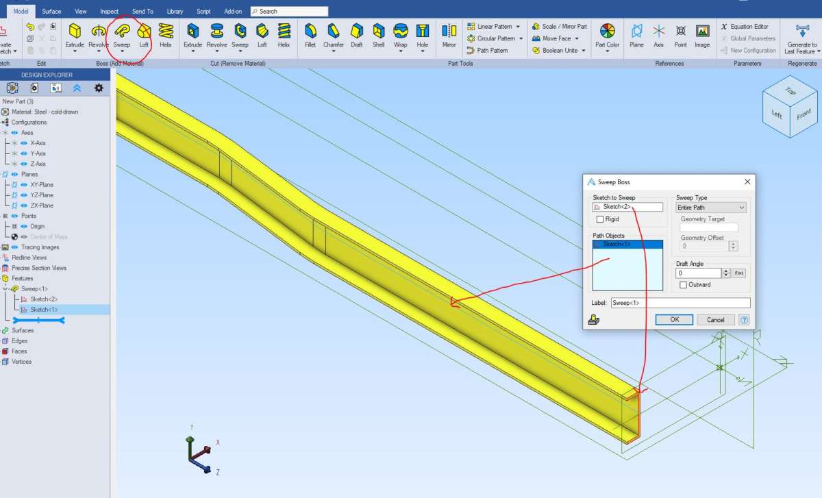

3. Now rather than just do a straight extrude of that C shaped sketch we want it to follow the line of the first sketch. So select “sweep” my icons are a bit differently arranged but it is the same icon on yours. The sweep box will come up an dmay well already fill in some of the boxes but you want to click on sketch one as the path object and sketch 2 as the sketch to sweep

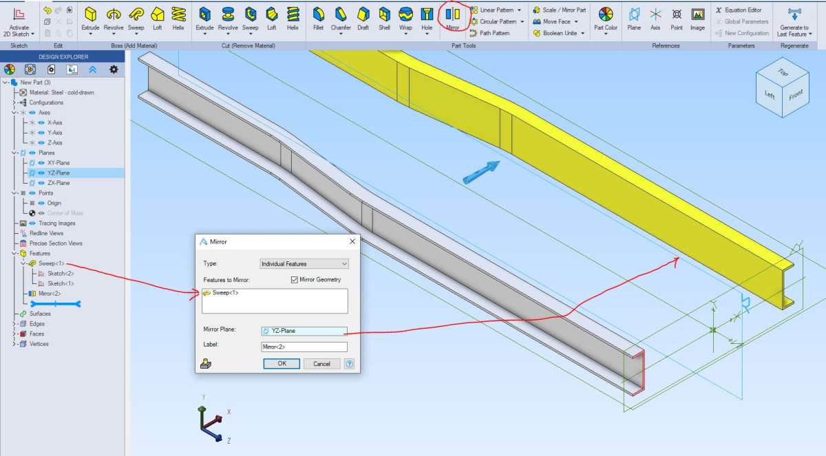

You could do the mrror in the assembly but may be easier here. Click the mirror icon, select the sweep as the item you want to mirror, you can click it from th eleft hand tree or simply click the part on the main screen. Select the central YZ plane a sthe one to mirror it in.

So back to getting some bits drawn, have you had another go at those chassis rails like I showed? Spend the time you took on that long reply to Dave’s even longer post practicing with Alibre.
Have a go and if something goes wrong just take a screen shot and post it here rather than deleting.
Your other two methods of drawing the part were also quite viable so again if you want to try those do so and if it fails save and post a screen shot. Even if it does not help you there are others following and learning.
So back to getting some bits drawn […] Have a go and if something goes wrong just take a screen shot and post it here rather than deleting.
Speaking as one of those others … Yes, Please !
It’s worth trying the other methods, as they are all the virtual equivalents of different fabrication methods – model using a sweep is the same as using heat to shape a single piece rail; modelling three separate but joined pieces is how you would weld it together. Neither would be done by you calculating the joining angles, as the computer can do it for you. In fact it can do it far more precisely than you can, which saves you time and effort later on. This is another reason how designing in CAD can save you lots of time and effort when actually making the part(which is the only bit in the process that matters) as you will already have thought through some of the problems. It’s quicker, easier and wastes less material than discovering any problems half way through mangling an expensive piece of metal…
