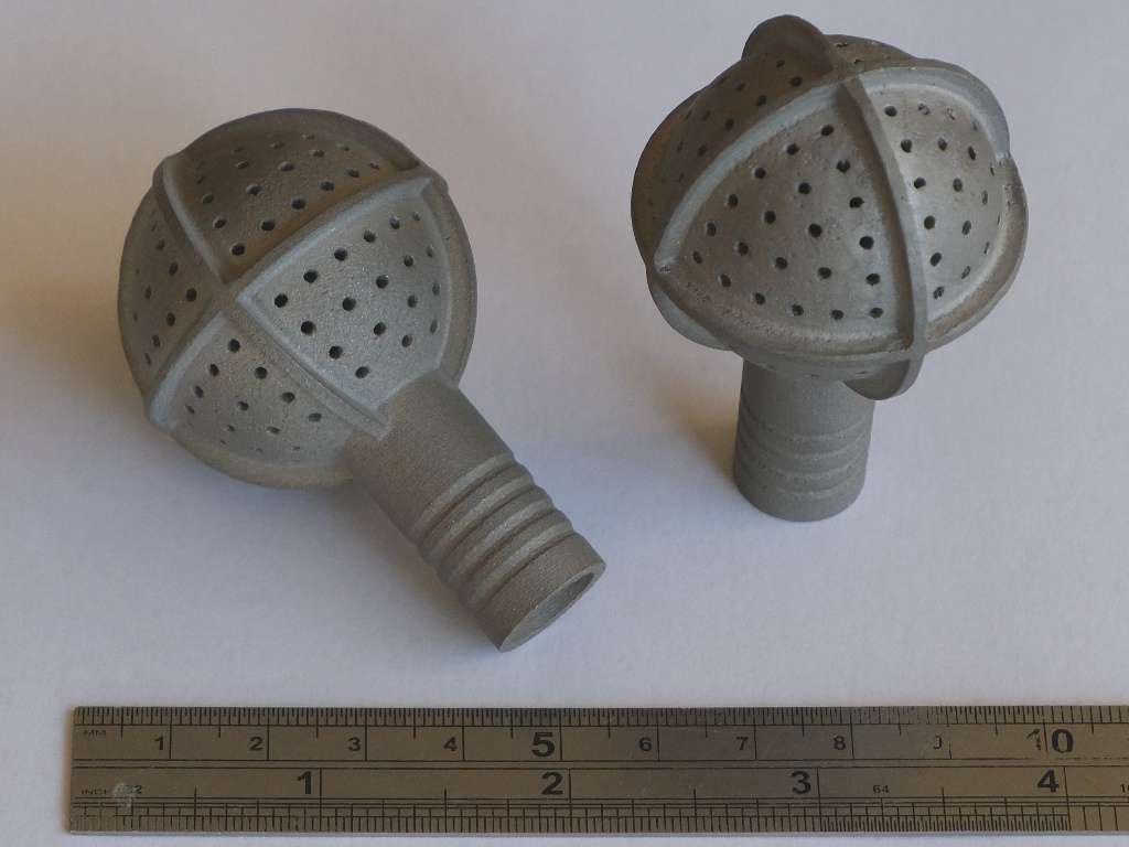

          Here are a couple of parts recently 3D printed in stainless steel by PCBway:
          Water Lifter Roses - 3D Printed
          Surface finish is fairly good; I prefer to exchange CAD data as STEP files where possible as they are more accurate than STL. The parts are surprisingly accurate dimensionally, within a thou or two. There are internal support structures, so not quite prototypical, but the structures are not really visible.
          Total cost was about $100; $60 for the two parts and $40 shipping via DHL. I paid with a credit card and got a lousy exchange rate. I have Euro and US$ accounts, so if I use PCBway in the future I’ll try to do a direct bank transfer. Time from order to delivery was less than two weeks.
          PCBWay look to be very competitive on PCBs so if I start dabbling in electronics again at home, as I am no longer involved in electronics professionally, I’ll use PCBway for the bare PCBs.

              Julie Ann, They look to have come out well, it will be interesting to compare the finish and cost of the lost wax ones when they arrive.
              There is another thread over on MECH that may be of interest as it shows work by a couple of other similar companies. And also this one on HMEM where you can see the better quality from the more expensive prints that Barry had done. But for a part that got slung in the nearest pond or ditch what you have should be fine for your engines.

                                    There is one lost wax casting of the part on order from Stanier Engineering in New Zealand. It should be on it’s way now. It was ready before Christmas but we decided it would be wise to avoid the Christmas delivery chaos and ship in the New Year. One casting is significantly more expensive than the PCBway parts. I won’t be using it on my engine as it will be cast in silicon bronze.  But I am curious to see what standard the professionals can achieve.
                                    After a mess up in December when I ordered a 3D resin printer, had second thoughts and cancelled the order, then third thoughts and tried to uncancel but couldn’t, I’ve created a new order for the printer and matching washer/drier/curer today.
                                    I’ve been using as filament 3D printer for 12 years so it will be interesting to see how the resin printer compares. Certainly the slicing process is more involved, particularly with respect to supports.

                                              I like those strainers!

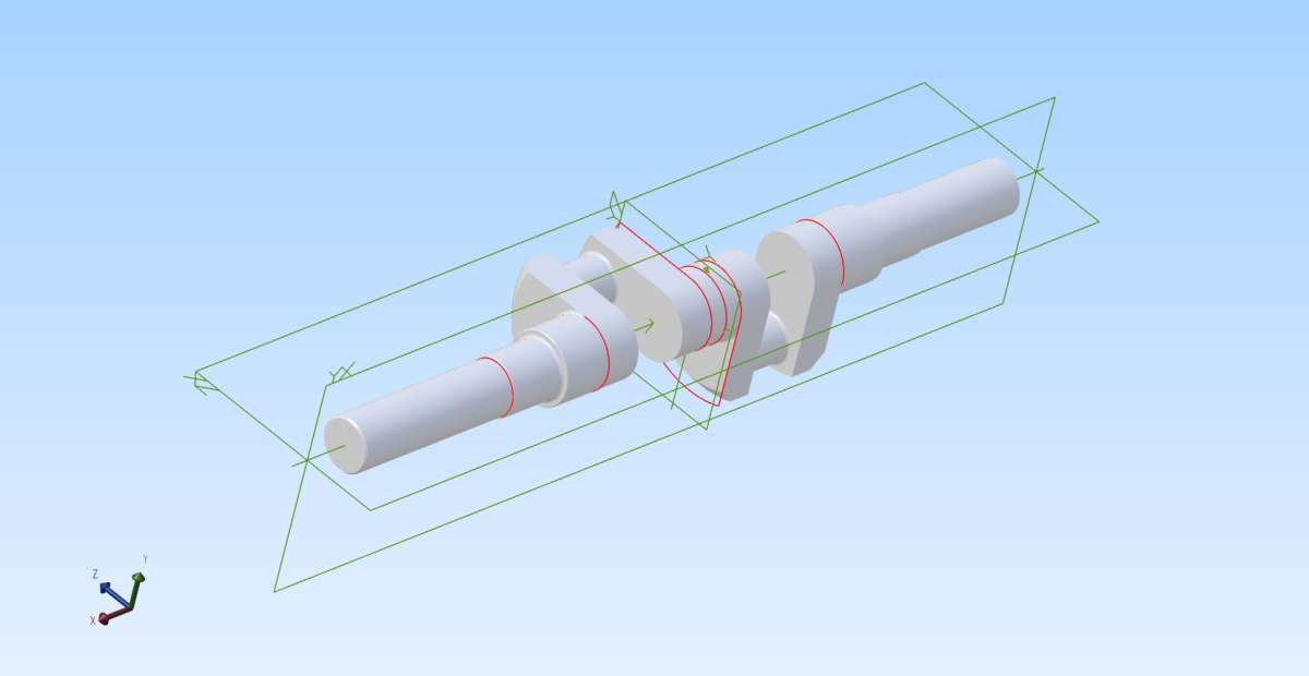

                                              Been busy:
                                              I have already made this crankshaft but need still make the bearings, transmission coupling, etc.
                                              Crankshaft
                                              #774332
                                                Not much wrong with that crankshaft. Keep it up.

                                                  I went the simple way: using Mirror to form the second half of each crank based on the face of a half-length pin, but plotting the second crank itself rather than trying to rotate a copy of the first. I also found a shorter way to plot the 2D figure to start the webs.  The ends are were all just extruded cylinders, then the chamfers and fillets for appearance.
