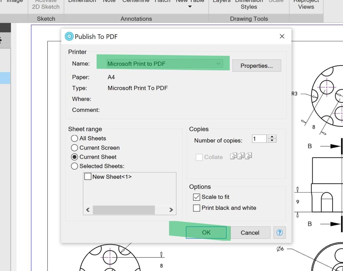

      Just tried making a pdf copy of one drawing but I have no idea where, if anywhere, it has gone because the system offers no way to name it nor to select its directory path. It just offers two or three pdf variants and what appears to be a printing option, and no information to help you. I have never previously created any .pdf file, from any application, and really know nothing about them, or even their point.

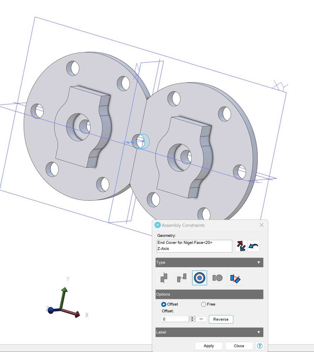

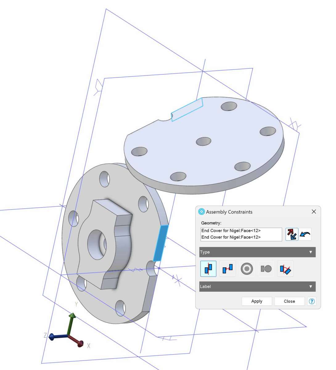

        I imported two copies, anchored one, and tried fitting the other to it.
        While “Undo” will reverse several previous moves, it doesn’t tell me what I had done wrong to need its services.

          Nigel,

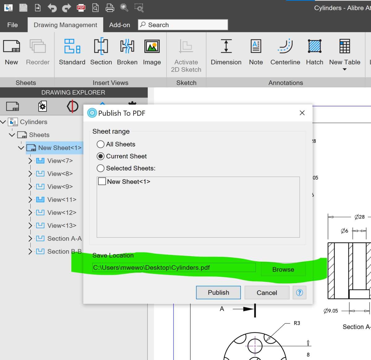

          Click on pdf icon.
          Screenshot 2025-01-01 220937
          Box selected as highligted in Green.
          Click OK.

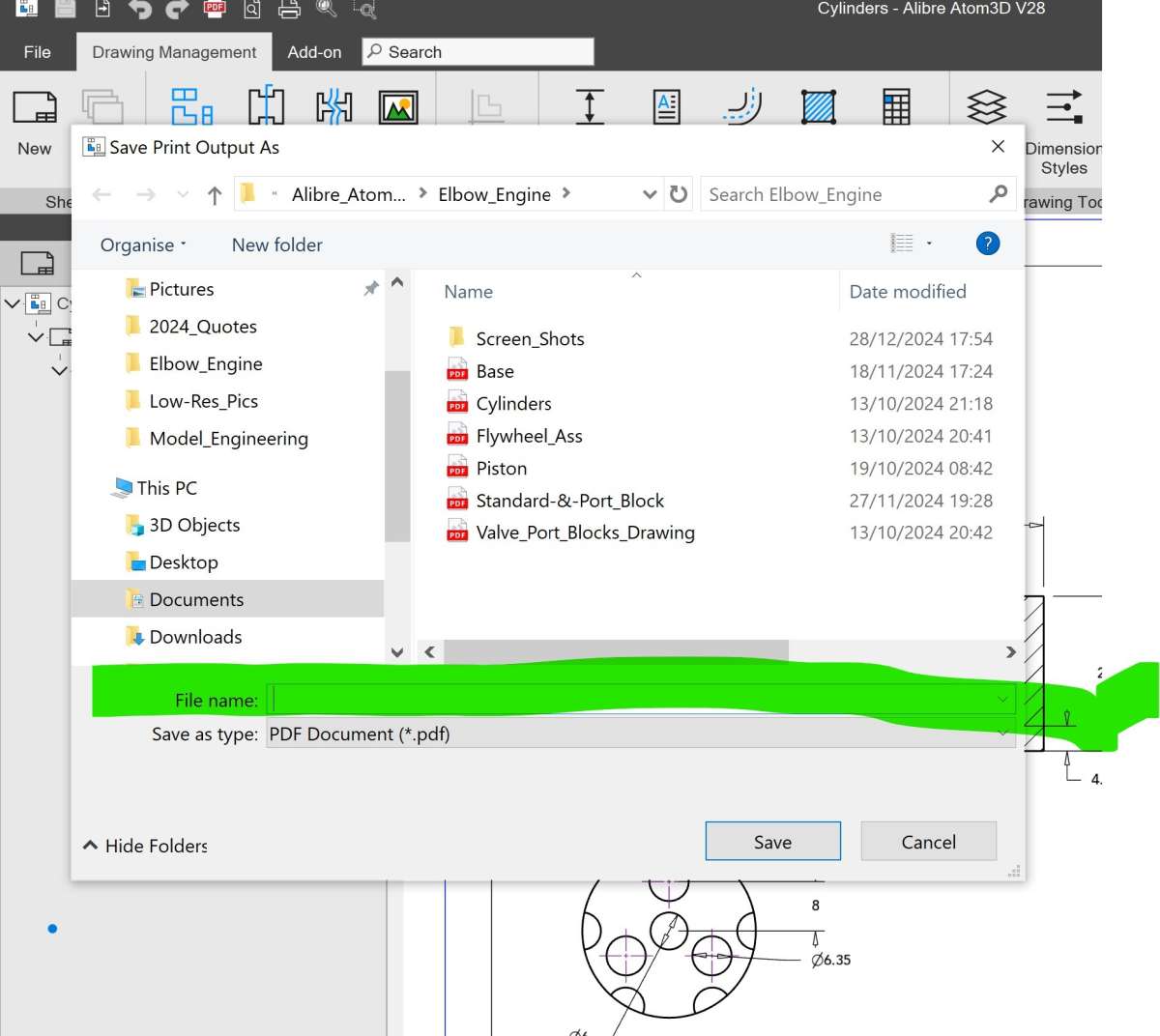

          Screenshot 2025-01-01 221149
          Then name file in box highlighed in Green.
          Click Save.
          In the above example the file is saved in “Documents, Alibre_Atom, Elbow_Engine.”
          (Note folders on LH side and top address bar.)
          This is Windows 10, but 11 is pretty much the same.
          Edit: If you haven’t already created a folder for your files, you will need to create one first, or from the above, by clicking “new folder” and then naming it.

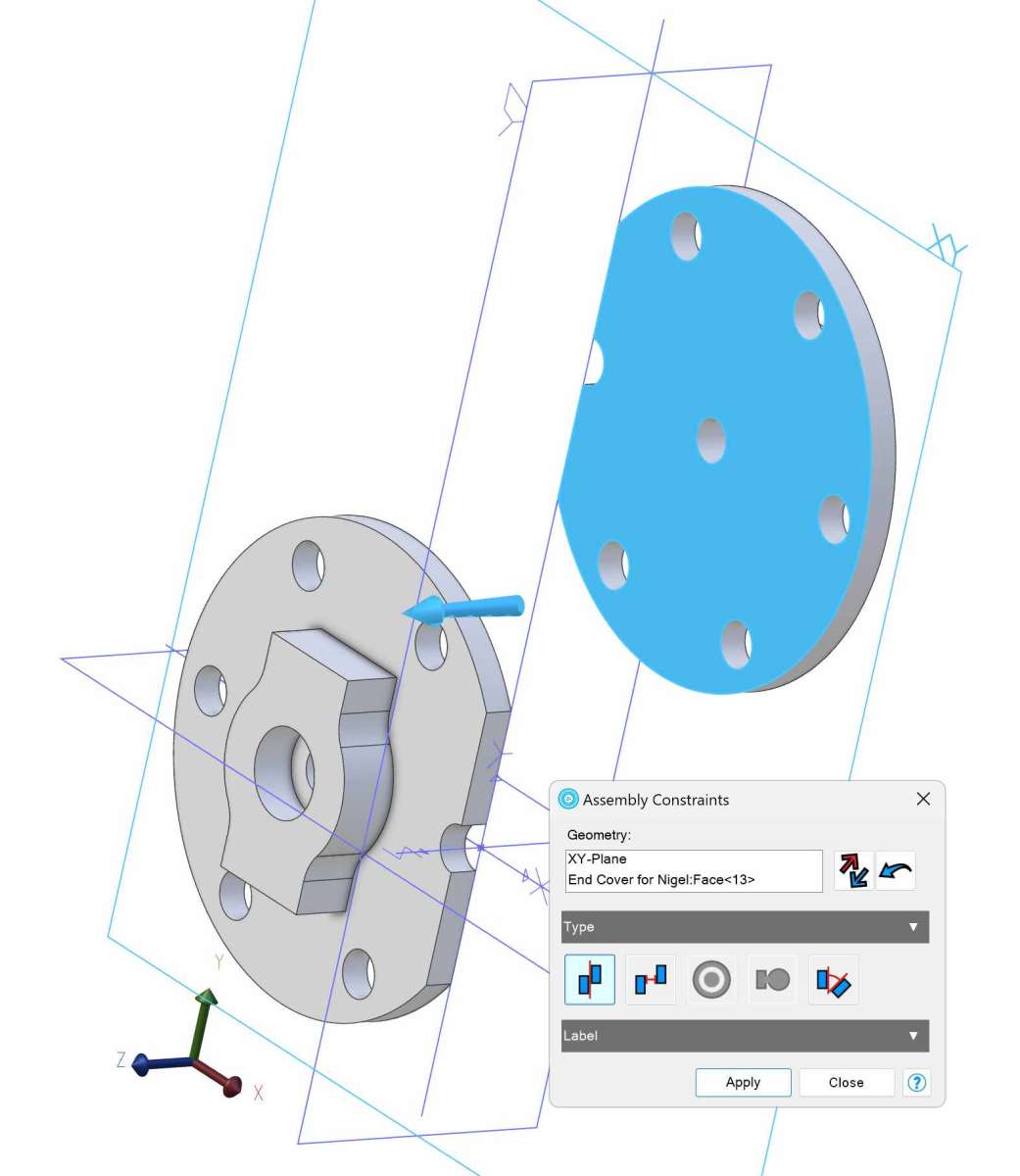

            No need to make the part half thickness. Just like doing the solid extrude mid plane you can also do a cut extrude the same way and cut out the cavity equally each side of the central plane ( or if you choose duel then an unequal amount)
            OK if you just had the two covers and one anchored you could right click them and select “show reference geometry” which brings up the three planes for each in brown and you can then constrain those planes and mate the two flat edges. Depending where you anchored the first it may only need the ref geometry of the unanchored one.

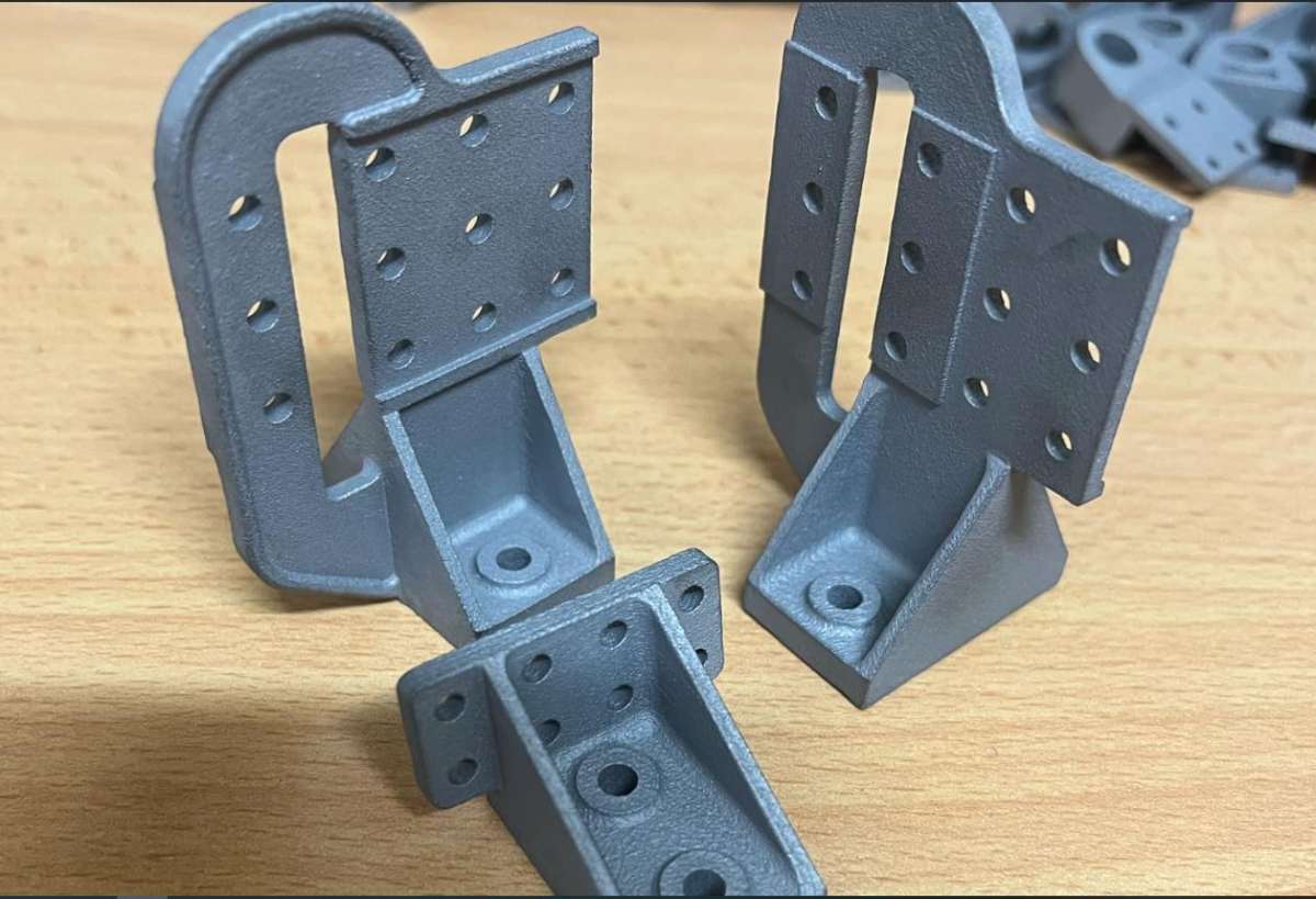

              As for the advert, you would not have this forum without them. Amadeal just moves around with any others in rotation
              If you actually looked at the advert you would see that PCBWay are one of the companies that a lot of hobbiests use, not only for PCBs but also 3D printing in both plastics and metal. I’ve an article due to come out in MEW at some time and that will show an example of an engine crankcase printed by them, less expensive than a similar size one can be bought as a casting. They will price in other currency.
              Other forums where people get on and make things feature items printed by them and other similar companies, I’ve a couple of engines that will probably have a metal printed part or two in them so watch this space.
              No affiliation with PCBWay or Mortons just not a biased view and an open mind to how we may source parts for our hobby.

                I strongly suggest that you DO NOT use Microsoft’s Print to PDF for making PDFs from Atom/Alibre – when the models get a bit more complex it really does not work well.  It also has a badly thought out file save dialogue which makes it all too easy to overwrite the model you just spent ages on, with the PDF that you are creating.  You can lose work that you’ll never be able to recover.
                Atom3D / Alibre Design includes a ‘built in PDF writer’ that avoids both the above pitfalls – it should be set as the default in System Options -> Drawings -> PDF   (use the check box for Built-in PDF Writer).

                  True Nigel, I suggested it as a simple way to ‘back out’ and try something else.
                  Actually assembly constraints and the like offer a preview before you finally commit, so the Undo should rarely be needed.
                  In terms of ‘what you’ve done wrong’ – most commonly there are 2 possible ways round that an assembly constraint can be solved.  Murphy’s Law dictates that the one you didn’t want will be tried first – there is a ‘flip’ button available that allows you to reverse the application of the constraint.
                  If you still can’t work out what went wrong, consider saving the file anyway – then create a ‘Package’ from it to send to someone who can diagnose the issue.

                    I tried various bits of the drawing as constraints, having to Undo each step. None would work. The Constraints menu evidently didn’t have enough evidence because its type options stayed faint. Each move just threw the mobile copy randomly anywhere.

                      I bow to your greater knowledge of Alibre, so I have ticked the box. I was tho’ only refering to saving a PDF of an already saved drawing, not making a PDF of a model. I would use, File, Export etc to save a model, is this correct?
                      Wouldn’t it be better if Alibre made this setting the default option?
                      Nigel,
                      PDF files are very commonly used, easy to email, share and open without special software. You can save word documents, drawings, and even this page, or any other web page as a PDF.
                      Using the recommended route you should get this dialogue box, just check where you are saving it in the highlighted box/browse button.

                        As David has said the PDFs will be a lot better quality particularly if enlarged than a screen shot or image taken from Alibre. Even if just printing at home it will be clearer and should save you some ink/toner as the printer is not trying to do a photo but just black lines.

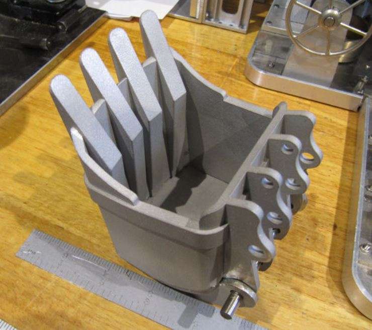

                        As I said real model engineers use PCBWay, etc not just companies. click the Euro button if Dollars are  a problem for you. What is the problem with buying from other parts of the World? They are a legit company and add our VAT on at source just like any of the other far eastern companies like Banggood, Aliexpress etc. Pay with paypal or similar and they will do the exchange rate for you. You simply drag the file onto their web page, select your options and they post it to you and you have your part in a couple of weeks. A lot easier than dealing with some UK companies.
                        A Few examples of other hobby users prints from them and other similar sites who will all take orders for individual items or batches if you want

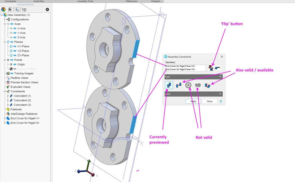

                          The Assembly constraint tool highlights only those constraints which are mathematically viable for the entities selected by the user.  You have to select 2 entities to have any constraint types highlighted – this only means they are mathematically plausible – it doesn’t mean they are what you want, and at that stage there is no validity check as to conflict with existing constraints.
                          If the options remain feint, then you haven’t selected 2 valid entities to constrain OR there is some other issue.
                          As to the ‘random movements’ – I suspect that’s usual, as per below.  After fixing one cylinder cover completely, I’ve chosen 2 flat faces to make coincident – note that the initial preview has both faces pointing in the same direction (not what I want).
                          Constraint4
                          So I use the Flip button – that only solves the condition, anything else about orientation is left random.
                          Constraint4a
                          So I have to apply another constraint to get the cover facing the right way again….  but again it assumes the opposite of what I want, so have to Flip again
                          Constraint5
                          And after flipping – add yet another constraint to do the final alignment
                          Constraint6

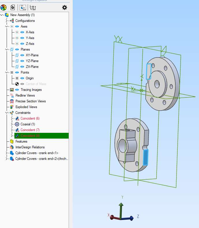

                            Well, I tried it..
                            and tried it…
                            and tried it…..
                            With your instructions open (though it’s a bit awkward switching back and forth between Alibre and the forum).
                            This was the nearest I reached: no nearer but basically round and round in circles with one “over-constrained” error after another no matter what I do. As I said, I find this Assembly system very hard, probably the most difficult area of Alibre, where it should be fairly straightforwards.
                            Screenshot 2025-01-02 171218

                              Nigel,  that’s nearly there.  If you save a package file from that assembly, e-mail it to me.  I’ll check out the conflicting constraints, and can advise on next steps.

                                  Here you go, three constraints is all it needs, I tried to do it slowly for you.

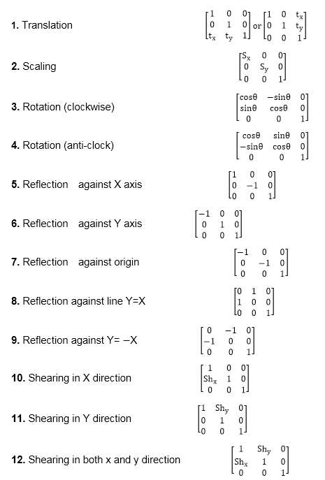

                                      There are 13 graphical transformations and the maths for all of them can be expressed by plugging values into a 3 x 3 matrix.   When an XY coordinate in a 2×1 matrix is multiplied by 3 x 3 matrix the transformation is a new 2×1 matrix.  The transforms are:

                                          Thank you for the demonstration, but I am not sure I followed it properly. I knew it should be easy, but the more I tried it the worse it became.
                                          Earlier I tried drawing the crankshaft, another part already made. Not as an Assembly of course, but a single Part. I took about an hour laboriously plotting one throw. I could mirror it to make the second, necessary anyway because the outer webs are a bit thinner than their companions.
                                          The two throws are at right-angles. I could not turn that copy through that right-angle. So I tried copying it radially but that gave a four-way mass, not four separate images. I returned it to 2-throws pointing the same way, to try to delete the copy and plot the correct replacement. Then totally lost its orientation. Knackered and disillusioned, I closed Alibre without saving the drawing.

                                          You tell us you struggled to understand matrices then go and show us Degree-level ones so we who need our Tracy Tools charts to see how many “thous” make 17/64-inch, remember our innumeracy!
                                          Essentially what you’ve quoted means absolutely nowt to us who were only taught to add or times two boxes of innocent little numbers and the answer has a fancy name – without ever being told the fancy name’s meaning, what you have really done and why, nor any link to any other branch of Hard Sums. Let alone any real use.

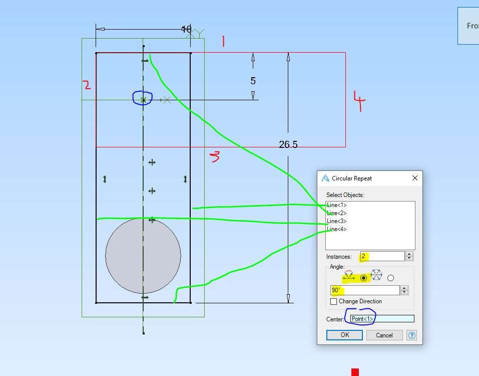

                                                You only got a “4-way mass” as you left it on the default 4. For a job like that you would want to do it by angle so again change the default from equally about the ctr of raitation to angle and enter the angle, in this case 90deg. This would give you two throws and you can then trim th elines of teh first away. However unless it is a very complex counterbalanced one then just sketch the second one.
                                                I have  afeeling I did a video of the crank before fort you will have a look

                                                  I tried to use a simple rotation by angle but that just did not work. It did not give weird answers. It just did nothing. So that’s when I tried using the Copy tool.
                                                  Copy with just 2 objects gives the original and copy 180º apart. Copy with 4 objects gives 4 at right-angles as a single unit.
                                                  I’ve looked again and realised “rotation”, is one of the extrusion types so it would not work.
                                                  In fact I cannot see any method simply to rotate any object through a set angle. I can’t imagine there is no such tool, but it is very well hidden.
                                                  Entering “Rotate” in the search box says it means rotate the view.
                                                  “Revolve”? Adds or removes material.
                                                  “Angle”? No result.
                                                  These in both Sketch and Model modes. I don’t know if you can copy a sketch entity by that rectangular array tool, but surely you must be able to move and rotate it too?
                                                  Otherwise, drawing something like a multi-throw crankshaft or a set of Tee-slots needs each iteration plotting individually.

                                                    Some confusion. I was referring to the “circular repeat” or pattern tool.
                                                    Here you can see I have selected the four sides of the original vertical web and do a pattern by angle of 90deg which is giving the new red outlined crank web. After this trim the black lines away so you are just left with the new ones
                                                    circular pattern

                                                      Dave –
                                                      LOL!
                                                      Did you not say you’d done A-Level maths at school?   I don’t believe Nigel is innumerate, I think he’s stubborn and misguided.
                                                      Indeed, simply arcane boxes of easy or Extremely Hard Sums, as innocent as a Victorian spinster Sunday-School teacher; a Century before mere trades like Finite Element Analysis and Computer Programming sullied them way beyond Oxford’s ancient stone Dreaming Spires and Latin-speaking Pure Academics. And yes, I have spotted the accidental but rather appropriate double meanings there….
                                                      All of which doesn’t help me design a model of a steam lorry introduced only a few years into the reign of Queen Victoria’s successor – but it’s just as well that doesn’t need more than fairly simple, real-world arithmetic.
                                                      Just CAD skill on a par with understanding Matrices.
