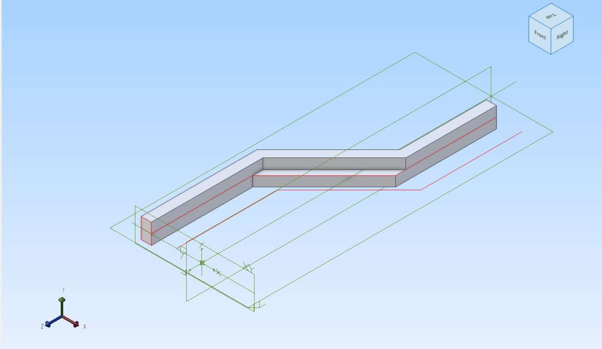

                  I had thought the sweep was parallel to the path, so the same layout and length, but displaced.
                  I’d read the manual as saying the sketch does not need be on the path, which seemed strange but I took it to mean the calculations would place it on the path. Only how would it be centred? On the sketches’ axis of symmetry, on one corner if a polygon, on some arbitrary point on the circumference of a circle?
                  Tht may not matter if the object is floating about as a Part, I suppose.
                  #780112
                  David Jupp
                    @davidjupp51506
                    Nigel,
                    The sweep feature always goes through the profile sketch.
                    The path that the sweep feature follows is parallel to the path sketch, and anchored to the profile sketch.
                    If the path sketch is offset from the profile sketch, the parallel application of the path sketch can result in some lengths changing from those in the path sketch, when the feature is generated.  It’s generally not a big effect, but can make a difference.
                    For your chassis rail, it can result in the angled portion getting moved along the rail slightly.

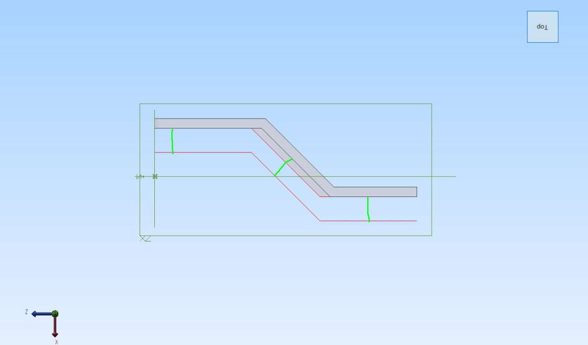

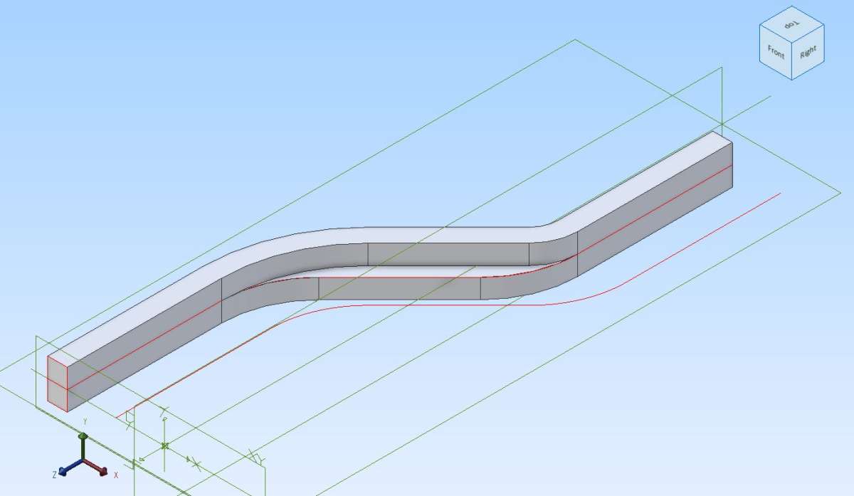

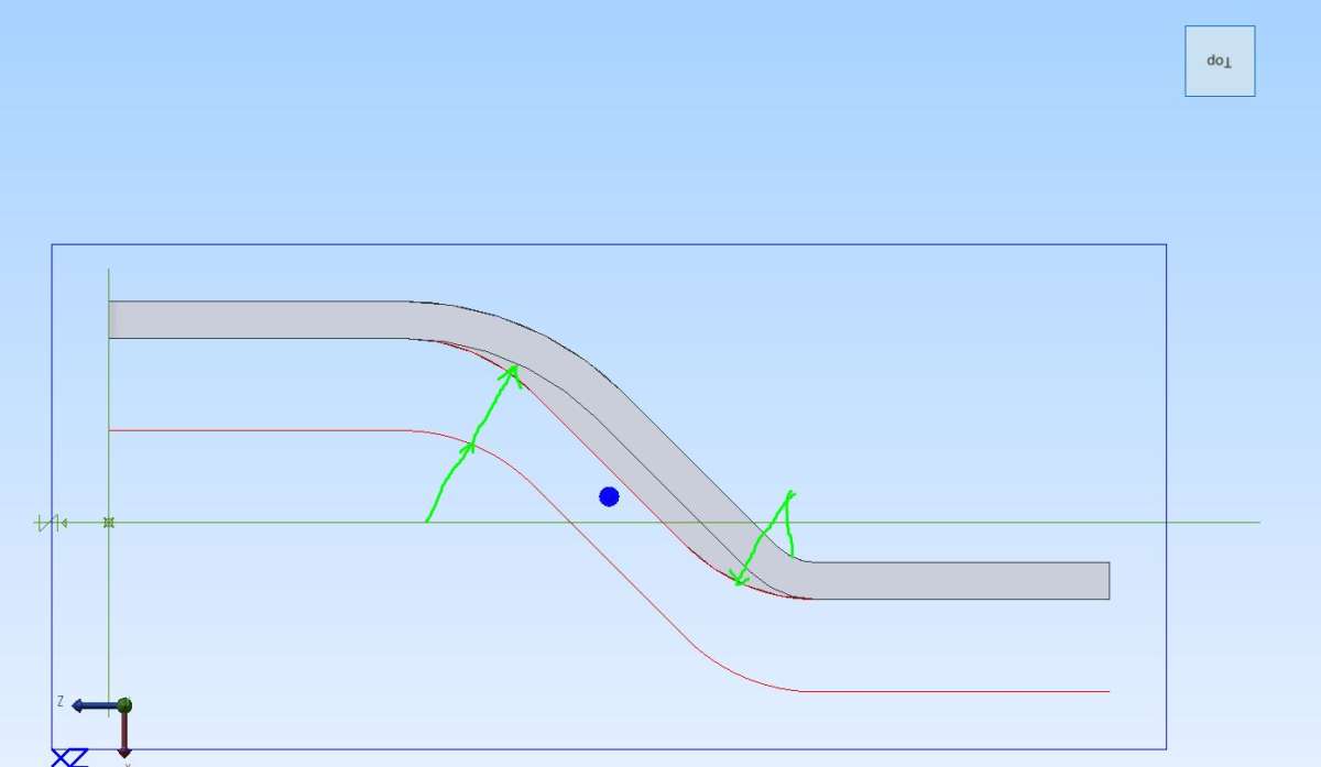

                    #780118
                      These are the couple of sweeps that I sent David with my Query.
                      In both cases the lower square has the path against it’s edge. However the upper square has the path sketch offset. Looking from above shows that the upper square remains a coonstant distance from the path so in teh case of teh angled one the main leg of teh chassis would be longer and the front section shorter. In the case of teh bent one then the vbend radii change as they are equally spaced from a springing point further away so the radius alters.
                      Sq1
                      sq2
                      Sq3
                      sq4

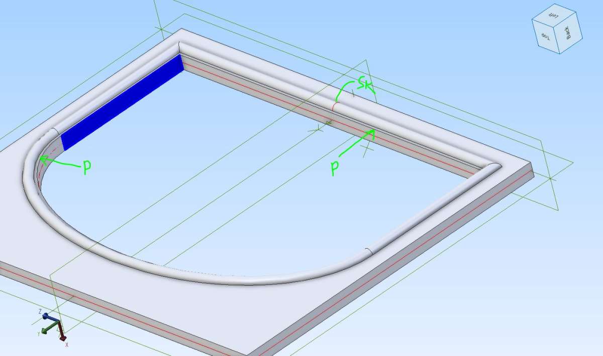

                      There are times when you want it parallel to the path such as this bead running around the opening but set 0.5mm from the edge which was the path.
                      sq5

                          There is no trap. If done how I first suggested then it will work fine and a bit of forethought will avoid any problems.
                          The only thing I would say is that I drew the path for the inside edge of the chassis to follow, if your dimensions were taken from the outside edge then that is where the path and C section sketches should meet. To me it made sense to use the inside edge as that is what all the other main cross rails fit to.
                          Don’t give up on sweep as it is a feature that can be used a lot and giving up will restrict you.

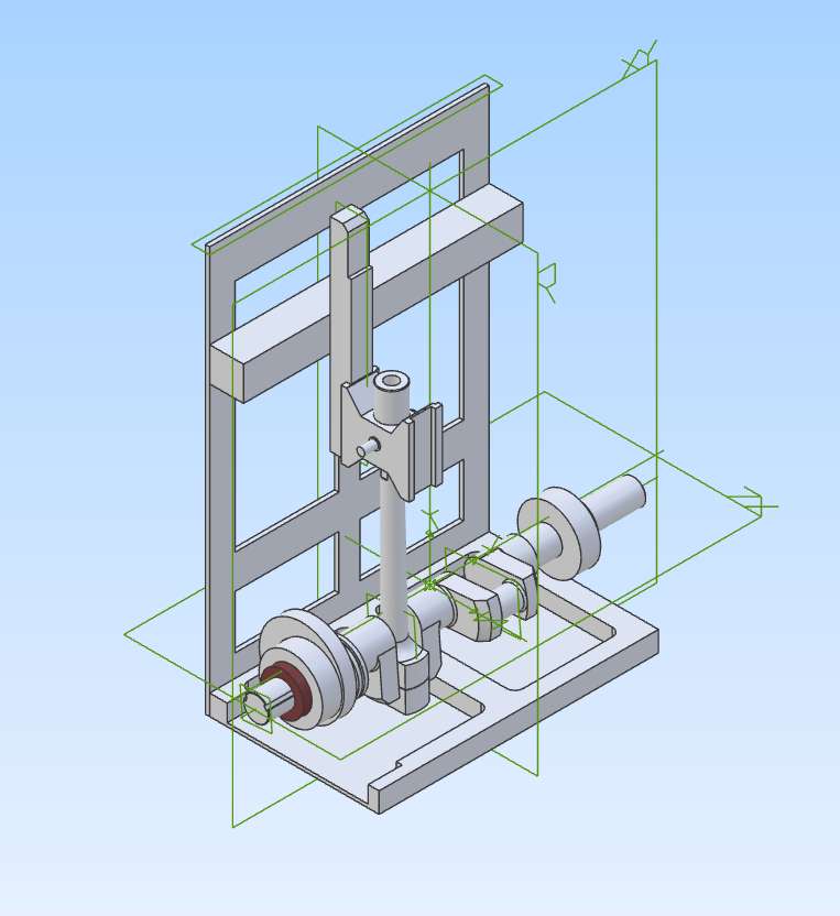

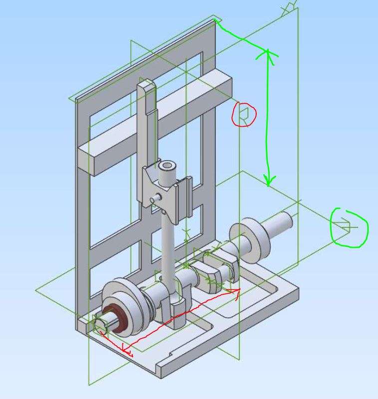

                                  Well, I decided trying to make that chassis into an exercise in using Atom as Alibre’s programmers intend, was going nowhere.
                                  I’ve not yet tried to model keyways part-way along shafts though David did try to describe to me. Every time I tried the extruded cavity just evaporated.
                                  However I had a go at partially erecting the engine, concentrating on just one half, and adding three “temporary” parts modelled simply to hold things together and assess how to squeeze the rest in. The temporary parts are the base-plate (with a big chunk cut out of the end so I could see where the big-ends go), back wall (upside-down!) and the cross-bar holding the guide-bar to the wall.
                                  The base-plate is already made but needs modifying, as I made it before really knowing how the crankshaft was going to look and where it will sit in the box. The conencting-rod shown is a simplified version. My first try had it with its bearing-brasses, but when I tried turning the shaft their effect was to throw everything of alignment. So I made a special copy of the rod with no liners.
                                  This image is hours old and a complete second-attempt, with forever running into “over-constrained” errors as the main and most frustrating problem, and having to cope with the crankshaft axis not on the primary axes. I’ve turned off (by the eye sign) many of the planes I concocted as they were covering the image with foliage.
                                  Screenshot 2025-01-26 221351

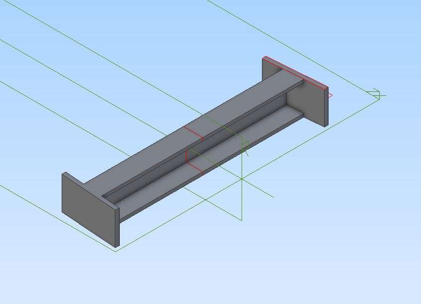

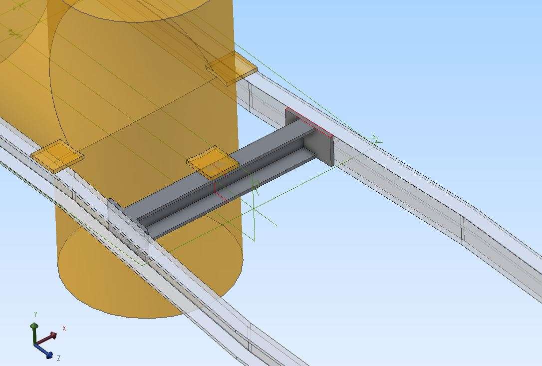

                                    There is very little you need in the way of measurements for the cross members, just the cross section and their position along the chassis.
                                    You can use the CAD to give you the length by using the geometry of the main rails, these will also give you the angle of the ends. I still don’t know the angle but the two fit together perfectly in the right position. I could pull the angle off the model or do a 2D drawing with it on.
                                    I did it by constructing the new cross rail within the assembly but could also have put a couple of guide lines in to get the length and angle so that I could go and model it in it’s own screen. One sketch for the “C” and I also did an endplate.
                                    cross rail
                                    It is saved as a separate part
                                    cross rail 2

                                      Is that lower half of the engine done as a part or an assembly? Would need to see the file to get the crankshaft where it should be as you probably have some constraints that are stopping it from being positioned.
                                      Also way too many planes if an assembly.

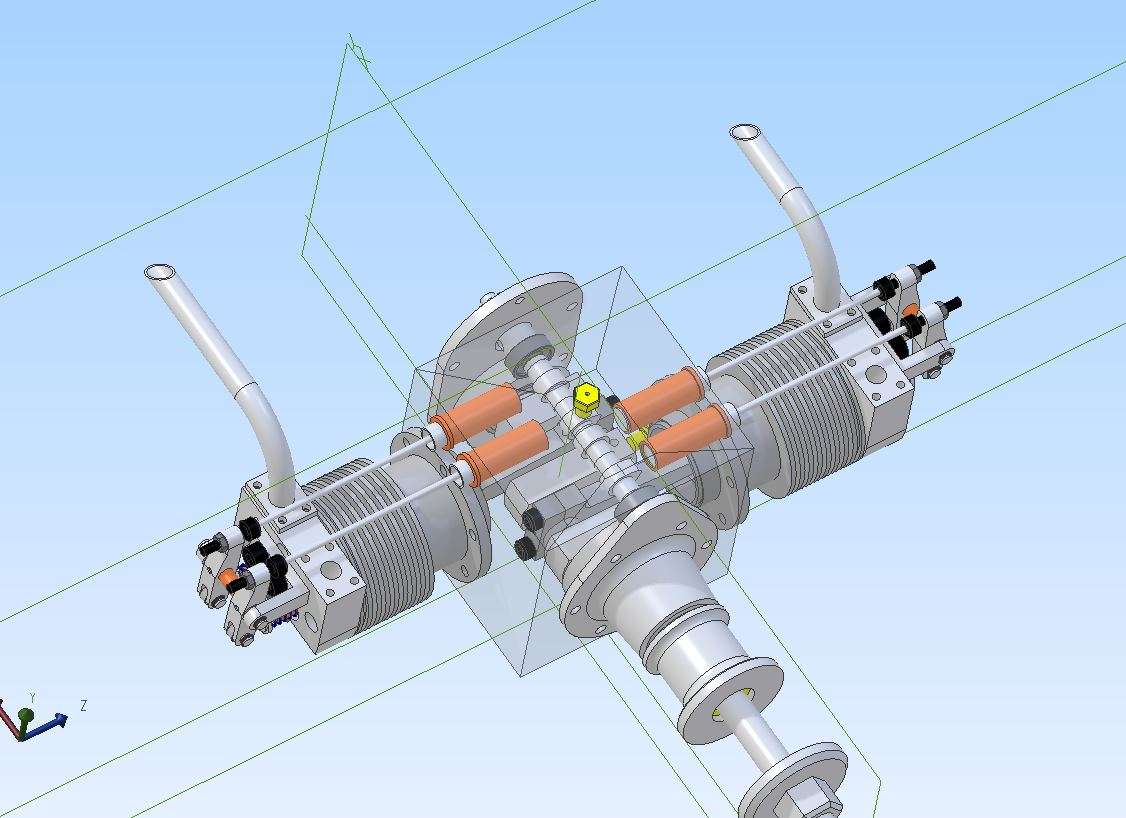

                                            The engine model is all-Assembly. The largest single Part is the crankshaft, but I’d not noticed it is away from the main axis until far too late – when I had put everything else together and was adding the base and wall.
                                            On that I placed one pair of eccentrics, one sheave (simplified to a plain disc), the two outside main bearings (ball-races simplified to plain cylinders) and oil-seals, and crosshead.
                                            Those Parts and the base-plate are all ready-made in reality, but some may need modifying.
                                            I’d also added the connecting-rod, as a new design not yet made physically. At 6 inch centres it threatens to make the entire engine too high. The whole thing is not supposed to be more than 16 inches tall, 17 at most; and that back-plate and guide-bar top are already 12″ above the underside of the base.
                                            I’ve made a pair of connecting-rods at 4-inch centres but the resulting centres / stroke ratio of only 2 is too small. It should be at least 3. They would also need a longer piston-rod to stretch the engine enough to fit the valve-gear, which I’ve not yet tried to design (adapted from a published design).
                                            The guide-bar is shown in temporary or unfinished form. I created that, the back wall and guide-bar support purely as representative to help build up the CAD model.
                                            I’ve just looked to see if Atom has opacity as well as colour controls. It does but I’d not spotted that at the time.
                                            All those planes were the only way I could see to try to align everything hopefully in the right places, and centrally on them; but there are still location errors somewhere in there. The bearings and possibly the whole crankshaft are displaced slightly towards one end, and probably because I could not constrain the bearings to their tiny location steps on the shaft. (The eccentrics are bored to 0.80″, the bearings are of 0.750″ bore.) The model’s probably full of needless, wrong or missing planes and constraints.
                                            E.S. Hindley & Sons’ design department never had these problems….

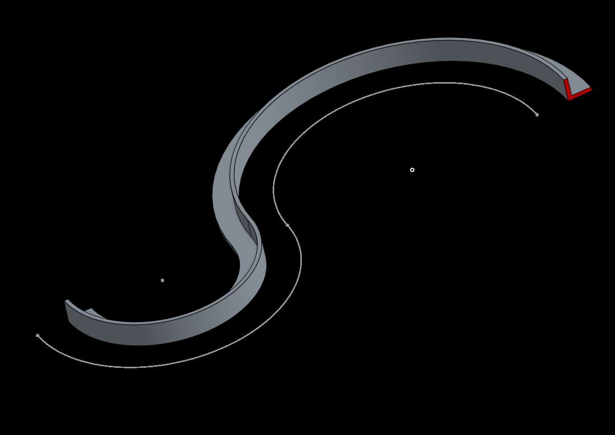

                                              Nigel, it is good to see you are making progress. I just tried out the offset sweep thing in Onshape and this may make it clearer how it works.
                                              Sweep path 2

                                                Never too late to alter things but best done as soon as possible.
                                                David and I have said about right clicking a part and selecting “show geometry” this will give the main planes and axis that were used to model the part.
                                                So in the case of your crankshaft it’s own axis could have been aligned with one of the main axis on the assembly screen. This will then allow it to be rotated about that axis so you can watch the conrods move and the cross heads go up and down.
                                                You do not generally need to add planes to position the various parts as they are inserted. You should be using an offset constraint or the above mentioned geometry. So for that back plate you should select the Horizontal plane and the top of the plate and entered a distance. Again as your crankshaft is not central to the engine you could have selected the vertical plane and the end of the crankshaft and entered a offset distance.
                                                If something is “small” and you are having difficulty selecting it then just zoom in to make it larger. It is something you have to do a lot.
                                                offsets
                                                If you want to send me the individual part files for those items and the cylinder I will assemble them so you have an example to look at, right clicking any constraint down the left will show what I did.
                                                This is an example of a transparent crankcase so I can see what is going on inside.
                                                clear case
                                                #780400
