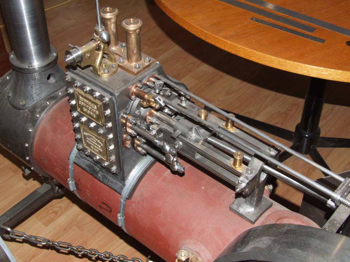

It’s only now, to design and make the engine and transmission-gearing, that I need half-decent workshop drawings. Unfortunately that machinery will occupy the area I can’t draw properly in CAD, and that area might be the wrong shape anyway!
The two bits of steel are the same despite rather rough-and-ready fabrication methods. I placed some primary bolt-holes by clamping the rails back to back, but with it now assembled, drill through from the components I am fitting.

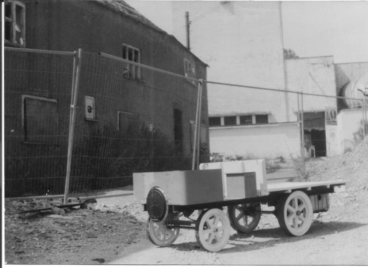

The horrible thought, from the one useful works photograph, is that I should have swan-necked the chassis in the very short area between the front of the machinery space, and the rearward front spring mountings – a displacement of over an inch sideways in about four length. (20.6º)
That would need completely new longitudinal members, probably need new boiler mounting brackets. It could give give major difficulties for the steering-column and gearbox, right in that transition area. (Ackermann steering)
The two pairs of joints would need hefty filler and cover-plates bolted or rivetted on. Possibly the full-size method impossible to determine from the surviving photographs – and every Hindley wagon seems different from its brothers in details anyway.
On the other hand it seems more true to original, relatively easy and quick to do, allow correcting one or two other mistakes, and facilitate putting the road-gears all within the chassis, as correct, in a nicely-rectangular area.
A further option is an all-square layout, basically two rectangular frames end-to-end with the smokebox forming the front cross-member. Simple and mainly hidden detail, but possibly not very structurally sound and prototypical.

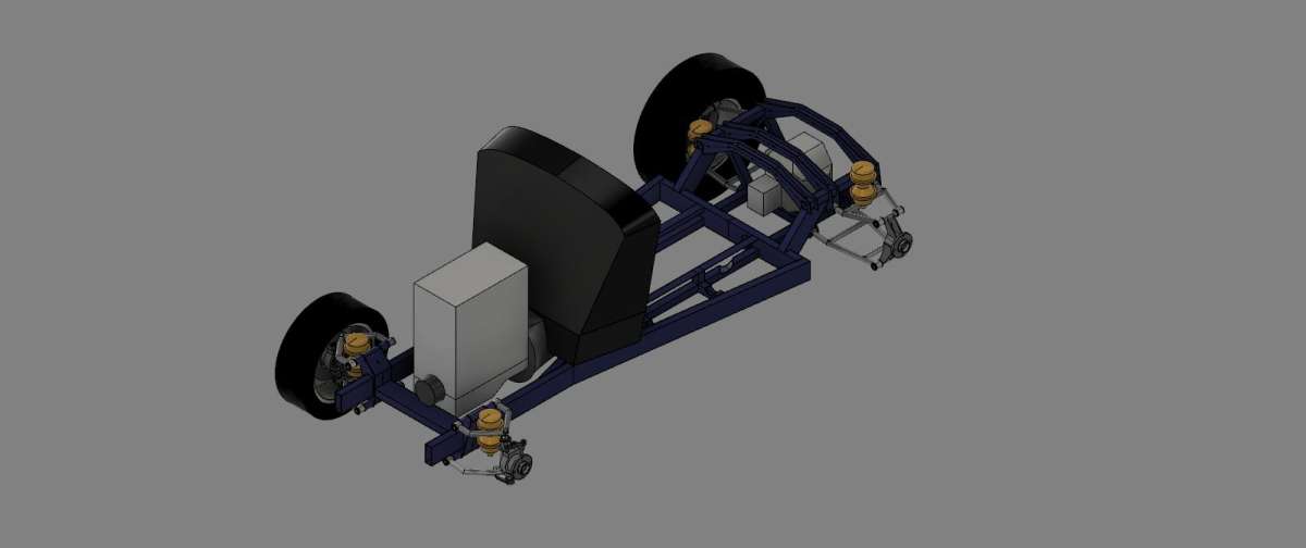

Meanwhile, everything here(and the rest of the chassis)
was designed on one side, and then mirrored around the centre line. You can see the join in the rear crossmember:
All of the flat parts are copies of the first part and are intended to be laser cut to save time, work and be self-jigging because slot and tab construction is effectively free. The wishbones and hub carriers are intended to be built in the same jigs, although the caliper brackets will need to be handed.
Although it looks complete, it’s mostly guesswork for a general arrangement and ‘what else do need to know?’ For example, the rear suspension geometry is atrocious.
Mirroring the parts saves so much work!

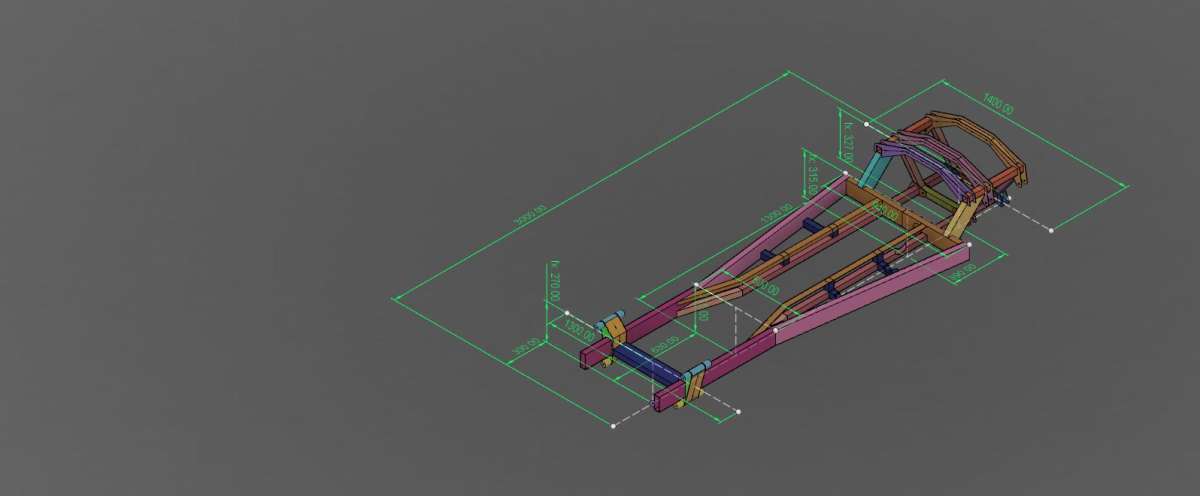

Nick – you are right in what I had wanted to do. My lorry’s chassis is simple (well, in physical form it is) and symmetrical in all but small details. Also I had not realised the Mirror tool is such a trap for a novice like me. Best avoided then…. along with Sweep.
Here she is, some 18 years ago and not much advanced since (two house moves in that time don’t help), posing outside the ruins of her ancestral home in the Dorset village of Bourton. The building on the left is recogniseable in some of the advertising photographs taken almost a century earlier. I had the boiler and some other parts with me, but left them in the car. Sorry about the low-quality scan of the proper photograph.

This is where I disagree with many of the other posters here, and suspect is some of the cause of your problems. Many of the CAD oddities that bamboozle new users are what make operations like assemblies or copies(mirroring is a specific type of copy) both feasible and predictable.
For instance; my main chassis rails are to be 100×40 steel box, and making the two separate parts meet properly at the bulkhead took ages due to the angles involved. When If I ever get around to building the car, I will sweep a 100x40x3mm thick profile along the outside line and split them at the angle with a plane through three of the corners to make the separate pieces. I’ll do the rear kickups by using the crossmember to subtract the desired cutout, instead of working it out for myself.
Here’s the chassis with the sketch that drives the dimensions I know, like the wheelbase and trackwidth, axle centre heights(different wheel sizes), width of the body at the bulkheads and their distance apart etc. The relevant points were then projected into whatever part I was working on:
If those examples seem familiar to you, perhaps you’ll better understand the reasoning behind many of my previous suggestions….

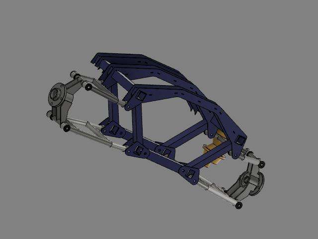

It certainly wasn’t a quick or easy process, even after ditching Turbocad. I’m still finding things I don’t know how to model. If I had to do this on paper I’d still be struggling how to mock up the wheels. Doing it without a good idea of how it all fits together would mean a huge amount of wasted time, work and materials.
What you’re seeing is the fourth iteration, and lots of vital information is missing: accurate details of the engine, gearbox and differential, working rear suspension geometry, a final decision on whether the mooted Hydrogas displacers are viable or to break the piggy bank for coilovers, as it currently ‘exists’ the crank pulley wants to go where the steering rack must fit(which is why there isn’t one shown), I don’t know if the throttle body needs to be moved from the back to the front of the inlet manifold, there isn’t room in the k-member for an exhaust and I really want the lower tube to be one piece from the rear suspension when it would fit better level with the top of the frame, and so on.
All of those need a physical mock up of the body, wings, wheels, bonnet, grill shell and existing frame to determine if I like the look(important for a hot rod) and provide actual measurements instead of a mix of informed and wild-arsed guesses. Then it will be time to do the whole lot again from scratch using what I’ve learnt so far.
Re-measuring the chassis and using various clamps and straight-edges to see where things will lie, suggests I don’t need modify it, which is a relief! Though if I do need modify it, I could also see a simple way to do so without making awkward angly bits.

Nick – Impressive project, and a hell of lot of work. I’m certainly interested in its progress!
Julie – For all practical purposes the two side rails on my model wagon are a mirrored pair. Yes, they do have a few holes on one side but not the other, but those are only details – typically holding pipework and the like. So there was no harm from that point of view modelling them in CAD as a handed pair, and omitting minor details like bolt holes. Those could be put on the part drawings. Especially as I built it years ago anyway!
If I was starting again, or at least making new chassis rails as I did briefly think I’d need, then yes I would carefully measure the existing components and record them on proper drawings.
Something like Nick’s car is a very different matter. That is far more complicated with very many critical components, identical pairs, handed pairs and unsymmetrical one-offs; difficult clearances and conflicts, and obviously the vital matter of ensuring the vehicle’s safety as well as performance. He can only approach it with a lot of preliminary, proper designing.

For the Chassis Rails if you wanted to detail all holes etc the time to use Mirror would have been at the initial modeling stage.
Produce one rail, save and call that rail left or Rail right depending on which you drew
You can then Mirror that whole part and “save as” Rail Right/left
You then have a left and right rail that can be detailed but the mirror saved having to draw it twice. Infact you could detail all the shared holes before you make the mirrored copy so less work again.
The two chassis files are then imported into an assembly.

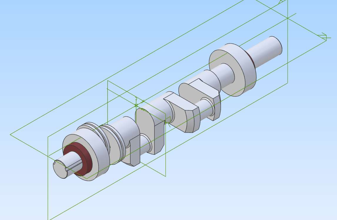

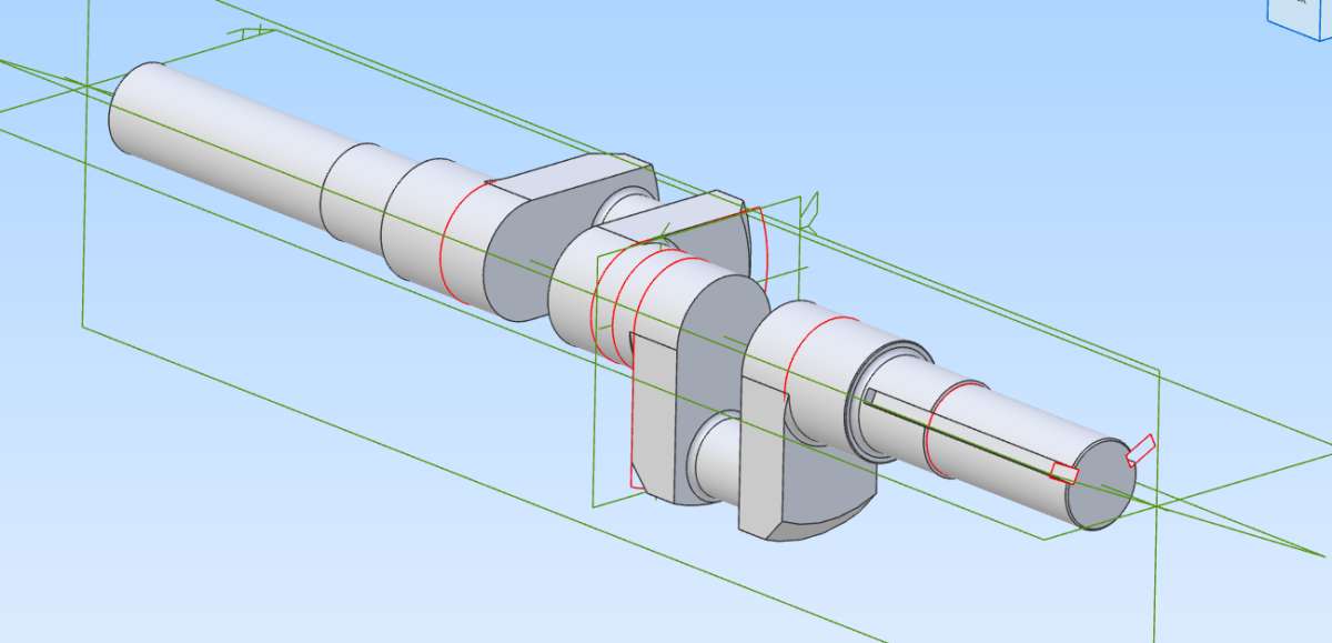

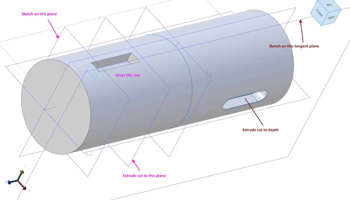

Nigel,
Re the keyway that extends into the main bearing journal. Looks like the extrude cut used just goes too far. So either edit the depth value OR change the cut into a ‘to geometry’ type and specify the step face on the end of the bearing journal.
Looks like you are definitely managing to model more complex parts.
Thank you!. No, the keyways do not go too far, but they should not be continuous.
Two are needed on the section beyond the bearing (which I represented simply as a big plain disc), symmetrically placed at about 25º each side of the neighbouring crank. Each of those keys drives an eccentric (the thin discs with the groove round them).
It also needs at least one keyway on the outer end of the shaft.
They should be quite separate, not cut into the bearing seating. Less still where the oil-seal (the brown disc) fits!
I made several attempts but could not see how to represent that properly, so concentrated more on their basic forms and placing.
When I modelled the eccentric I spent some time on geometrical constructions and examining the physical components I am drawing, to see if I could use a single keyway in the shaft and eccentric in such a way that the latter can be handed. So the two eccentrics are identical and simply turning one over would place it in the opposite angular orientation. Obviously, if you could, thousands of steam-engines big and small would have already been made that way in the last couple of centuries! However you approach it, one component needs two of the locating features, and it was always normal to use identical eccentrics and two shaft keyways.
That wasn’t a CAD question, simply one of mechanical design geometry.

Nigel, sorry I obviously mis-understood your previous post and the comment on the keyways.
You could use some additional planes (or other existing faces) to place the sketch(es) on for the start of the keyways. You can sketch ‘inside’ a solid – though that may feel odd. A ‘precise section view’ can be helpful.
You can also produce keyways starting with a tangent plane touching the shaft, and cut down into it.
I’ll model a simple shaft with different keyways to illustrate some options.
For the Chassis Rails if you wanted to detail all holes etc the time to use Mirror would have been at the initial modelling stage.
You then have a left and right rail that can be detailed but the mirror saved having to draw it twice. In fact you could detail all the shared holes before you make the mirrored copy so less work again.
You could work on the side with the most bits attached before the mirror operation, then delete(if you can’t just ignore) any obviously redundant holes when the design is complete. Production parts often have mirrored features so that they can be used for left and right hand-drive. The later you leave mirroring the part, the more efficient it is. It’s better for you too, as the mental effort can be spent on the design rather than keeping track of the parts.

Julie’s point about realising that starting again using what you’ve learnt from the previous attempt is also important. It’s slightly easier to do in CAD, because at least you won’t be scrapping expensive materials as well as time and effort.
So in a CAD model, if the Mirror tool works on such objects is there any design reason not to use it, before any holes in the webs and flanges? In effect it is an upside-down copy, simulating that stacking to compare the real beams’ shapes. (I’m not asking how the software creates the reflection, only about the result.)
I was trying to model merely two identical lengths of steel formed but not further modified; one turned upside-down and slid sideways!.
I feel it depends on the job in hand and the abilities of the user. Just like there are different ways to make a part in the workshop depending on tools and skills
For your rails if you had mirrored and saved the opposite hand early you would be having to add the common holes such as cross member fixings twice so better to do as much common work as possible. If there were very few or no common features except for the basic bent length then mirroring and saving as at that stage would be the better optiion.
Or If we take Julie’s traction engine wheels. A lot could be assembled such as rim, strakes, spokes and possibly the hub and saved. A second mirrored copy could then have the brake ring added as that is possibly the only handing difference, the mirror will take care of the handing of the strake angle. This would be a lot faster than assembling two complete wheels from scratch. Or if Julie modelled both left and right strakes then the left hand one could be replaced with a right hand one which is another option in assembly and then no need to mirror, just assemble the correct wheel onto the appropriate side of the engine.
I realise I do not really understand the Mirror tool and when it can’t be used, but why do people use the engineering to say I can not model that frame by reflection? I appreciate their help, but the original part shows no engineering reason not to; and from the CAD aspect it would plant a central plane for further use.
If you plant the central plane at the start, it can be used to place the first part when creating it. Give the plane a relatable name, and select it from the browser rather than visually. That would have probably prevented your part moving the way it did, which has all the marks of selecting a different plane to the one you wanted.
If you position the the swept path half the chassis width from the vertical plane everything goes where you want without any extra work. As you should know this dimension before you even open the file, it ought to be a named parameter.
Creating dimensioned, mirrored, swept profile, fully editable chassis rails would be a good 5 minute in-person exercise to boost you up the learning curve. Some of your other parts could be used to similarly demonstrate other essential techniques. Your recent work shows you are very close to the so that’s what they meant cartoon lightbulb moment!
Considering patterns, copies, joints, mirrors(which is just a fancy copy), sweeps, construction features, etc to be advanced techniques instead of fundamental building blocks is very poor teaching.
Not quite – the path sketch defines shape, and length of the sweep. It’s the profile sketch position that defines distance from the vertical plane (at its plane), as well as the cross section profile.
While that’s true, placing the profile so that it touches the path reduces any potential issues for a beginner. And means that the part’s positions are predictable and editable.
