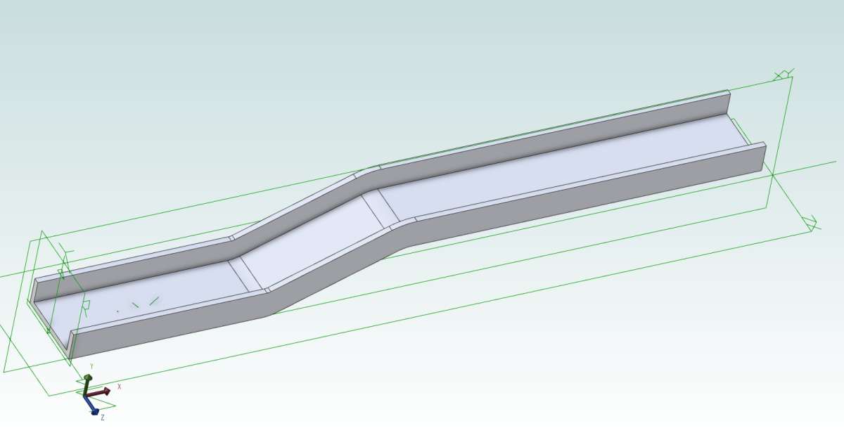

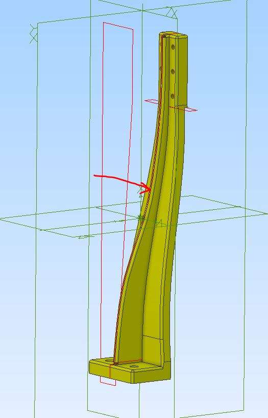

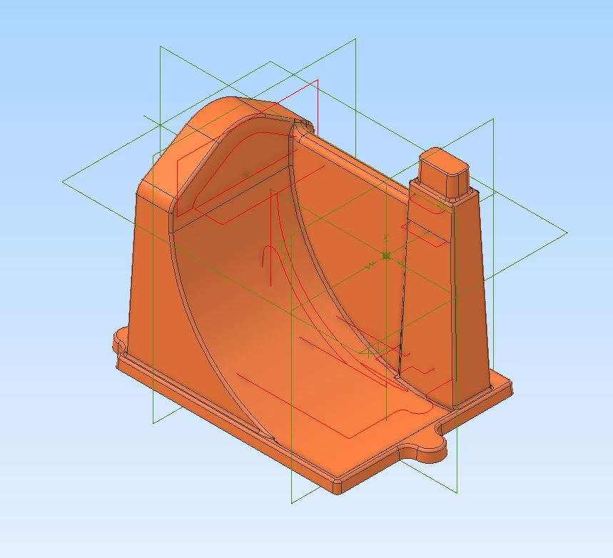

      Out of idle curiosity I thought I’d create a sweep, although it is not a function I use particularly often. Once I’d got the sketches in the correct orientation to each other it seemed fairly straightforward:
      Channel
      The sketch to be swept was an L shape; the final channel was created by a mirror as the last operation. I did learn one thing though. When creating a fillet on the path sketch the fillet radius for an inward bend needs to be larger than the width of the flange. This applies to the fillet/bend on the left. Note that the radius on the outer edge of the flange is smaller than the dimensioned radius on the vertical. If the specified radius is less that the width of the flange the software gets confused as the radius value goes negative before the outer edge of the flange is reached.
      Some other general points, learnt after nearly 20 years of using Alibre, are:
      •  When making parts align the part with the local planes, if the part is not aligned it can lead to odd effects, with lots of white space, when 2D drawings are created.
      • Do not add dimensions that define the position of a part within an assembly to the part; it just makes life more difficult than needed for zero gain. If the spacing in the assembly needs to be changed the part has to be edited rather than just the dimension the assembly. The planes in a part and in an assembly have no relationship with with each other, unless explicitly constrained when adding a part to an assembly
      • I don’t generally worry about the precise orientation of a part with respect to the particular planes when creating it. The only exception is when a part is to be CNC milled. It makes life easier in the CAM program if XYZ of the part align with XYZ of the mill.
      • When creating a part I rarely dimension at the start. Just get all the extrusions/cuts and other features drawn based on the picture of the part I have in my head. Exact dimensions can be detailed after the basic form of the part is completed.
      • When making an assembly align the first part, or in Nigel’s case the first two parts (left and right channels), with the planes in the assembly. All other parts are constrained using features on the parts, not reference planes.
      • Keep each extrusion/cut and so on simple. Complex sketches with multiple features can lead to a big muddle when tweaking dimensions. In the past I have had to abandon parts and start again.

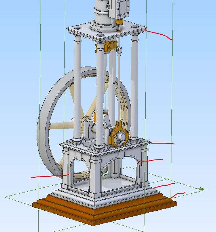

      • Patterns and mirrors are great! On the part below I was dreading having to detail all the small holes, as Alibre does not allow you to place a hole on a curved face. A hole has to be projected from a flat surface. Having thought about it only one hole needed to be done like this, hence the three angled planes at the bottom of the part, all other holes were created using circular patterns and mirrors.
      Water Lifter Rose
      I had initially planned to create a complete 3D CAD model of my engine, but have abandoned the idea. The resulting model would have been too large and unwieldy. Instead I create assemblies of specific areas like this for the motion work and tender:

      I am happy to provide a step by step picture book of how I created the sweep.

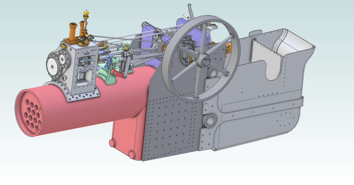

            Those example of Alibre’s power in the hands of experts only stress how limited my CAD skills can ever be.
            For my own steam-wagon project I need now draw “only” the engine and transmission, but those as properly as I can. The only other project in hand, best designed properly, is the drive for an ancient milling-machine.
            However, I could never use Alibre to anything like Julie’s and Jason’s levels.

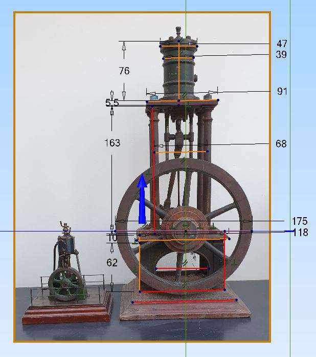

                I tend to work from photos quite  a lot much like you are doing with the Wagon so that is really my general assembly, other things are just in my head and I know roughly what goes where.
                Sometimes I will import a photo and pull a few dimensions off of that, not just individual part sbut also how far one part may be from another and then start modeling the main parts often not in full detail so that I can at least get a good idea of what teh engine will be like and that teh basic geometry of teh moving bit swork. I’ll then come back and ad dthe details.
                Example of the Vickers which I took Measurements from, these were the only measurements used the rest I just built up to suit what I saw in the photos and what nominal material thicknesses suited

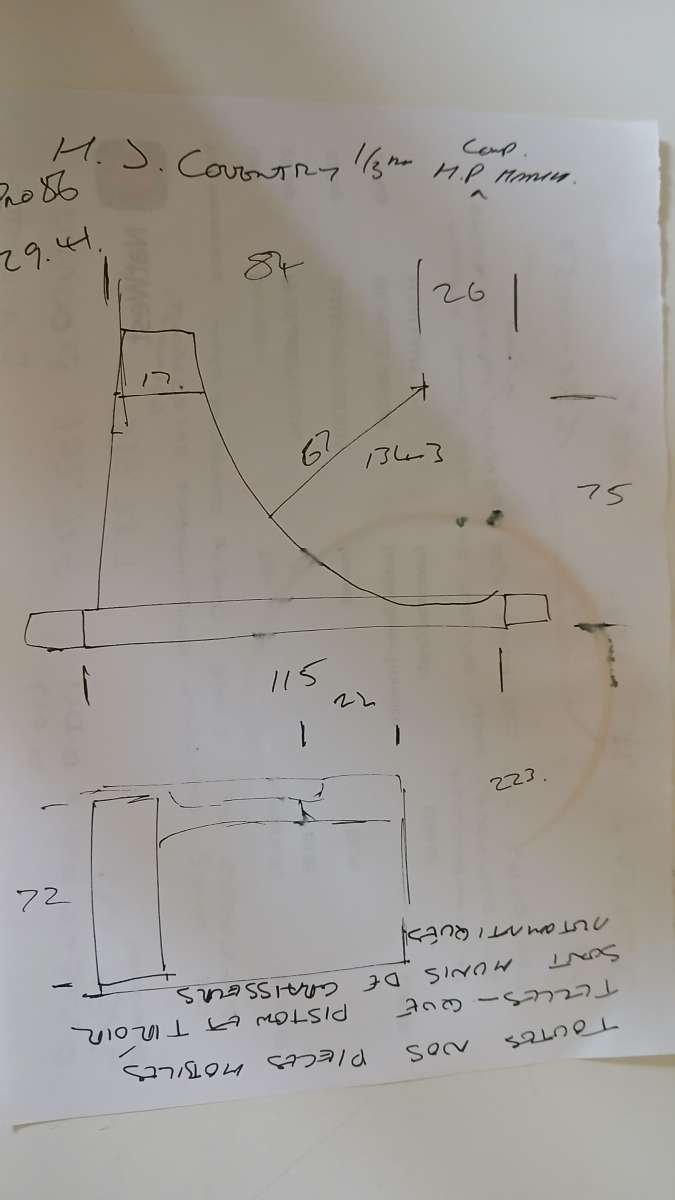

                Other engines where I don’t have a good square on photo I may just do a rough fag packet sketch and put a couple of sizes to that and then start the 3D. Yes I’ll probably change some bits as the design unfolds but easy on the screen.

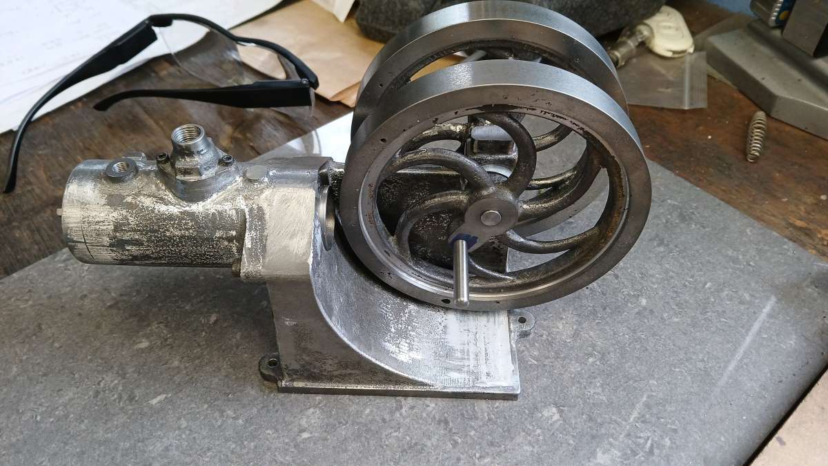

                This one I had to base it on using a particular flywheel casting so did the rough sketch
                20250120_130702
                refined it as other parts were added to the assembly
                ideal boss 2
                ideal 4
                It was then modified to enable a 3D pattern to be printed
                ideal pat

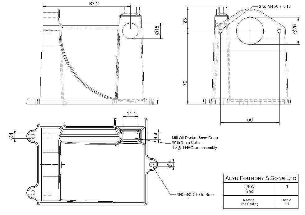

                And then the casting machined
                20241222_120552
                Rare occasion for tis one I actually printed a 2D drawing
                ideal drawing

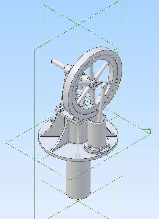

                On the go at the moment is a Raab hot air engine
                raab trace
                fag packet sketch
                20250120_130719
                And where I’m at
                raab
                So no need to start with a detailed GA. Position the major parts as per any references you have to start with then flesh it out and don’t worry if you need to go back and move say the crankshaft height when you find the flywheel rim clashes with the top of the power cylinder.

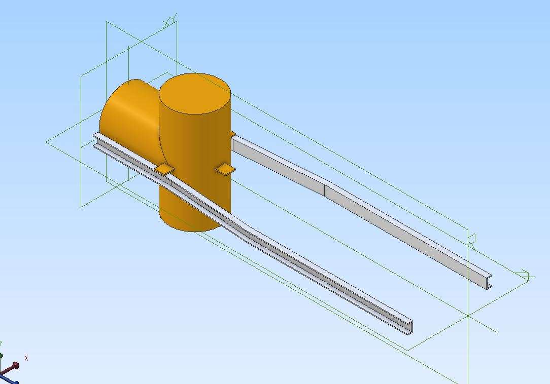

                      Or maybe something Nigel can relate to like a representation of the boiler assembled into his Wagon Chassis rails or the covers into the bottom of his cylinder block.
                      wagon ass

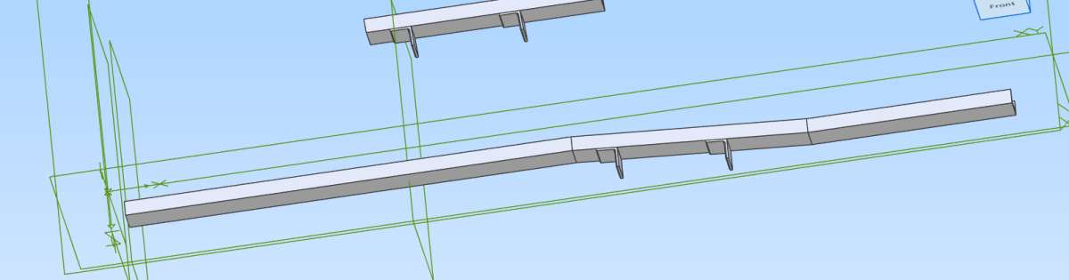

                          Nick –

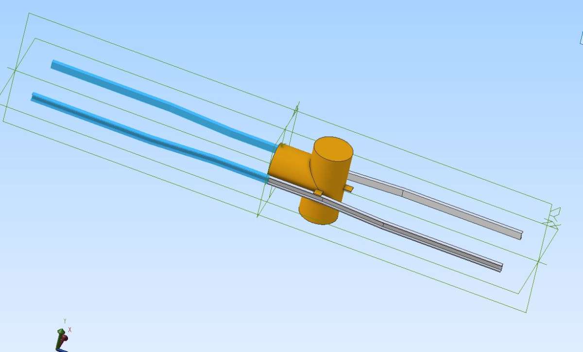

                          I didn’t create that frame as an Alibre Assembly of Parts. I created it as a Part, i.e. one model.
                          The primary shape was an inverted, unsymmetrical T that I extruded to the right depth to represent the webs of the long sides and the cross-member made from the same channel. That first stage made them look like two strips welded together. The real ones bolted together.
                          The rest – their flanges, and the L-section of the other cross-member – are all separate, by sketching rectangles of appropriate lengths and widths and extruding them to thickness.
                          So nothing was extruded to length, only to height or thickness. No “assembling” in the Alibre sense of importing Part images and sticking them to the growing model. All one Part image, and I placed some of the rectangles by eye, not constraints or calculated measurements.
                          Consequently no problems with sweeping profiles at odd angles to the axis. No individual Parts on planes all different to each other. No parts facing in all sorts of irretrievably wrong ways. No baffling constraint / over-constrained problems and their incomprehensible error messages.

                                              Yes – I did do that.
                                              More prosiacally later I re-tried that chassis frame. It is very hard due to its odd angles and parts joined on the tapered section, but eventually I managed to model a long half-assembly, though of the three cross-member stubs I think two are slightly short. They look like it, anyway.  Ah well.
                                              Only… am I right you can mirror a sketch or a part, but not an assembly? I looked in the manual but it was not very clear on that, not to me anyway.

                                                You can mirror parts in an assembly, here I have mirrored the pair of rails
                                                mirror ass

                                                  But Atom3D doesn’t have Assembly Mirror – so other options need to be used.
                                                  You can make ‘other handed’ versions of a part using scale/mirror.  Then add these to the assembly (which is what the assembly mirror tool does basically).
                                                  You can use (feature) mirror in parts to add the mirror image of existing geometry to the file (so you have two (or more) bodies in the same part file.
                                                  Nigel – if some portions of your rail look short – go back and check the dimensions.  You can use the measurement tool that I showed in our assemblies session yesterday.  If sizes are wrong, edit the features/sketches to correct them.
                                                  By default the 3D workspace display is in orthographic mode – the brain isn’t expecting that, so can mis-interpret and make things look wrong when they are actually OK.  On the View tab of the Ribbon at top of screen, there is an option to switch to perspective display.  Might be worth trying to see if things ‘look better’.

                                                    A really simple equivalent to ‘mirror’ for basic geometry like those chassis rails is to insert another instance but constrain so it is the other way up.
                                                    So if making a chassis rail from 3 parts – make that as a sub-assembly.  In a new assembly, insert 2 instances of the rail sub-assembly, constraining one instance one way up and the other instance ‘upside down’.

                                                      In which case….
                                                      Jason – what version of Alibre do you use? Is it not Atom?
                                                      The parts of my assembly that seemed too short, were when viewed them against what was intended as a mirror plane but which did not extend to the front end. Visibly, the shortness may have come from cutting slightly into the mating parts, due to the intervening angle being not 90º.
                                                      I’d managed (with considerable difficulty) to add two angled brackets at fairly close to their real locations (I think) to give constraint surfaces or edges, but not something to control the ends of the added parts.
                                                      I had tried to measure something already built but very difficult to measure accurately, and then model it in CAD – but that is even more difficult. So making something difficult, even harder.
                                                      It looks as if I’d not bothered to save the result and I’ve not tried to do it again because I had taken most of the evening to create something that was not even right.
                                                      I’ve just measured the image and found the front bracket is an inch out of place: dimensions awkward to calculate from the measurements I’d taken, even harder to apply in the CAD assembly.
                                                      I’d intended the model below to collect three half-length cross-pieces so I could mirror the lot about the central plane, and it was those half-pieces that did not fit properly. The left-hand one had no bracket because it fits the longest piece at a right-angle. It’s supposed to be on that plane… if that’s in the right place.
                                                      The two brackets’s front faces are tapered at about 4.3º to correct for the frame’s taper. Putting those brackets there took many attempts, then when I stuck the other bits to them (another struggle) they did not look right.
                                                      The “spare” piece is unintentional and I cannot delete it.
                                                      Making such things physically is far easier than trying to model them in CAD. Clamp the main members to temporary cross-pieces on the floor, set to their intended dimensions then make the cross-members to fit! I machined the tapered brackets; everyhting else was by rule, scriber, square and hacksaw.
                                                      I must have made it from a general-arrangement drawing on paper, but don’t know if I still have that. It probably showed only the two side-rails and rearmost two cross-pieces, in defined places. Those made the frame parallel and rigid. All chassis components forwards of the rear axle depended on later developments such as the boiler and its mounting method.
