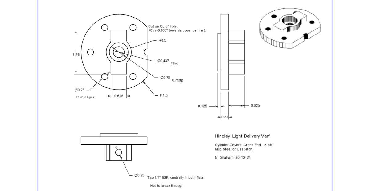

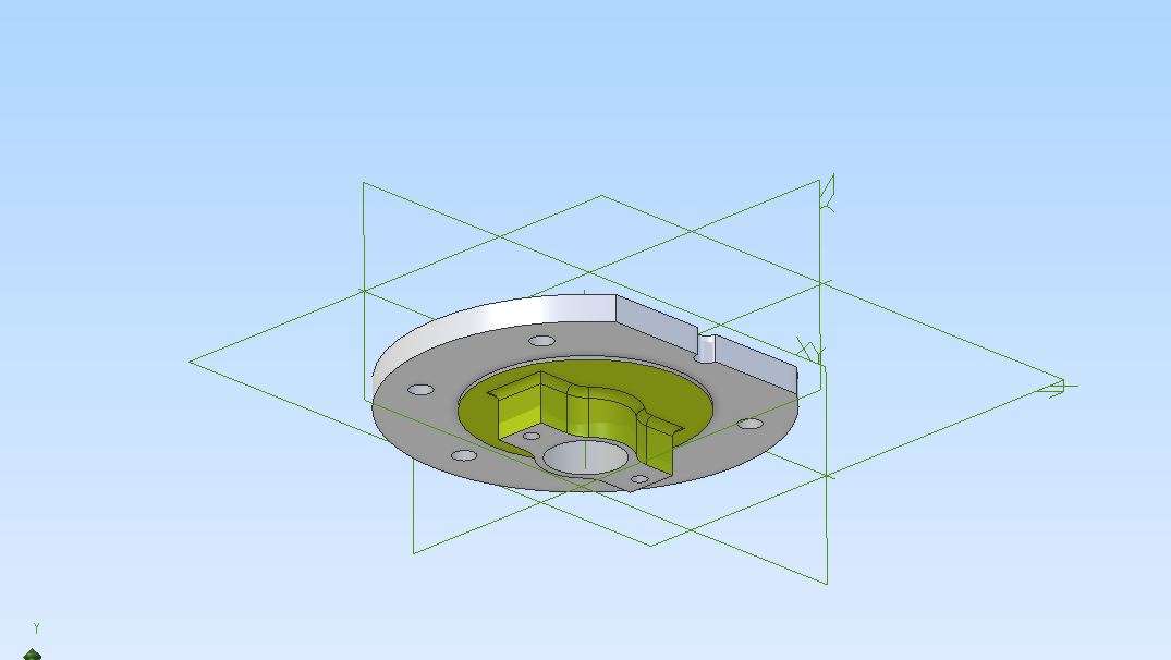

      This took me about an hour and a half, including trying unsuccessfully to turn it into a dimensioned drawing.
      I’ve forgotten how, and could not work out “Left”, “Right”, “Top” etc. from the little coloured buttons, so ended up with a mess.  Helped by the 3D image showing the planes confusingly all mixed up as usual with me.

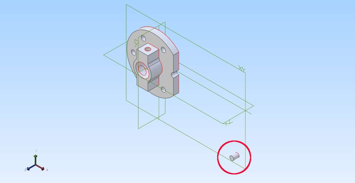

      I’ve no idea where that odd little cylinder in the corner came from, but I can’t delete it because I’d not spotted it in time to prevent it becoming part of the first extrusion. It helps prevent making a drawing version. The flange is only 3″ diameter but the little cylinder makes the view hog about half the available area of an A4 sheet already restricted by all that default margin clutter.

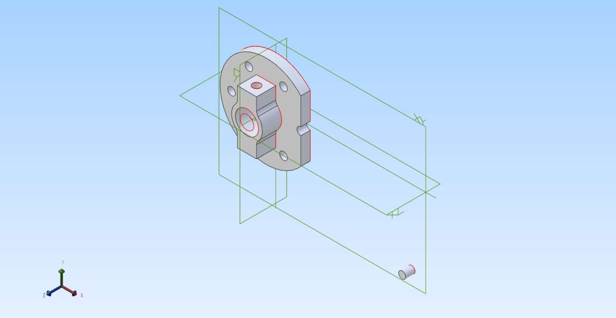

        Open the sketch you used to draw the round plate and see if there is a circle in the position where the cylinder is (it’s probably the magenta circle you can see at the end of the cylinder). if so, delete it and the cylinder will be gone (you might have to delete the reference to it in the extrusion editor/property page, or whatever they call it in the program you’re using).
        #773526
          Just right click the red circle at the base of that cylinder, select edit and then when the sketch comes up left click that circle again and press delete or use the trim tool to remove it.
          If in doubt what elevations you want click them all and then delete the ones you don’t want from the 2D drawing
          First screen that come sup when you start a 2D drawing has the option to click “blank sheet” rather than template and it will remember that for future 2D drawings.

              I’ve managed to clear that rogue cylinder, still without knowing how I managed to put it there. A sort of CAD typo!
              Now then, will an Alibre Drawing (distinct from the model) act like an ordinary image file…?
              No, it needs converting to one. Cylinder Covers - crank end image

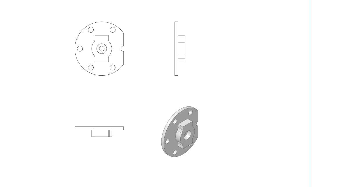

                Well done for giving Alibre another go.

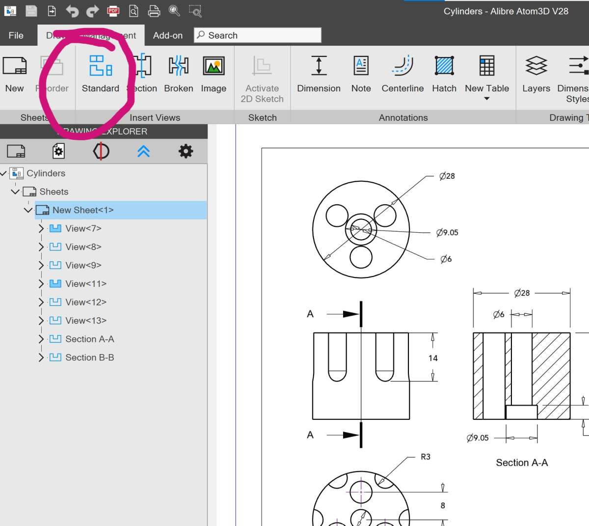

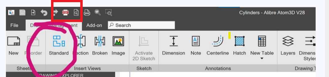

                I don’t find the drawing view icons very intuative either, so I do as Jason suggests and select more views than I need, then delete the ones I don’t from the drawing.
                You can add any missing views using this button.
                Screenshot 2024-12-30 222013
                Once you have saved your drawing, you can export it as a PDF file. A PDF can easily be opened without having to wait for Alibre to open, and can be opened on a device which does not have Alibre installed. It is also easy to zoom in on a PDF, and to print it if required.
                PDF files are vector based, so zooming in does not pixelate the lines as a JPEG does.

                    Your unwanted cylinder was probably just a bit of mouse trouble, if you have the circle tool selected and then don’t quite hold both buttons down to move th epart about you can end up creating a circle, square or whatever tool you have active at the time.

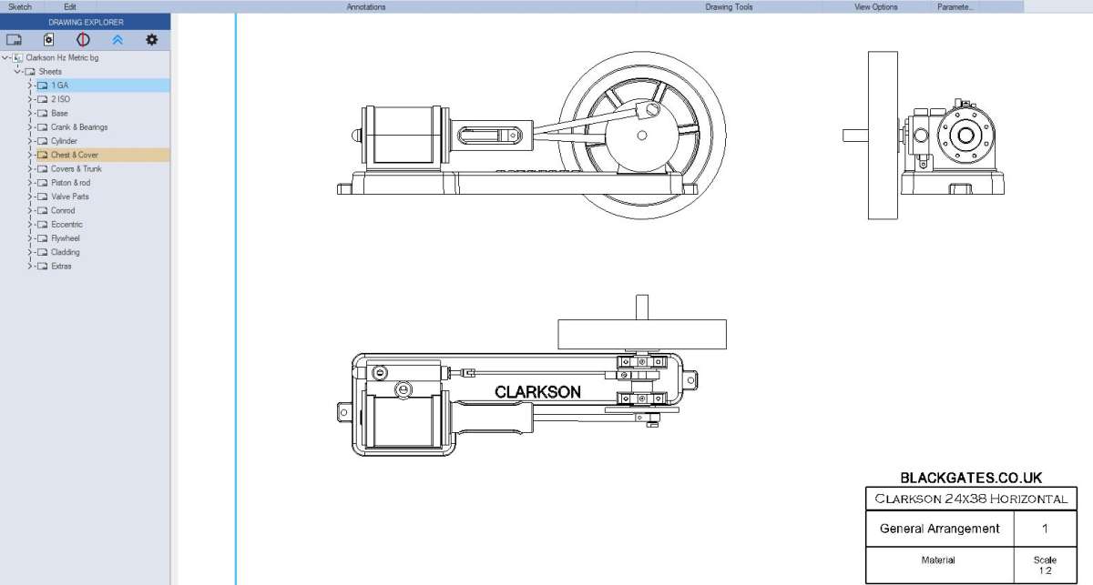

                    I output the drawings as PDFs, once you get more than one drawing to an engien you can then keep them all as one pdf file if you create a multi page Alibre drawing which is quick to open and you can just scroll up and down to look at various sheets rather than open files for each page. Image below shows the pages down the side which I have given a name to so they are easy to locate if I need to revise one.
                    sheets

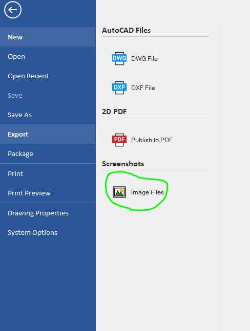

                    Another way to get an image if that is how you store them is File – Export – Image files. This is a slightly better resolution than the usual snip.
                    image out

                          You can add an isometric view in the Alibre 2D drawing – even setting it to ‘shaded’ representation if you wish.
                          Cover

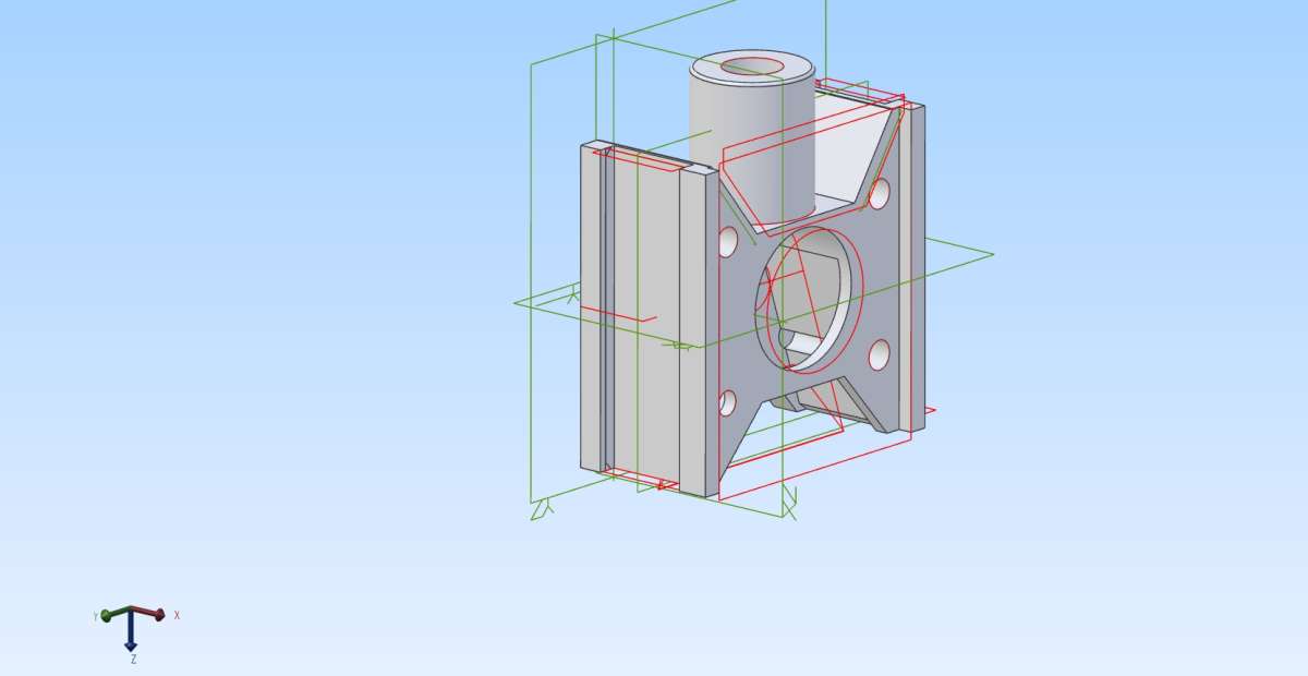

                                                  I thought I had quite a number of Alibre drawings, but I was wrong. I might have lost some in that computer crash but more likely I had simply not saved many.
                                                  Despite much “housekeeping”, the files still seem to occupy separate places in scrappy directories hard to control. I’m tempted to use only extension drives to stop MS messing around. At one point up popped one of my photographs – and no, I do not want and will not install that blasted “Copilot” cr+p. Microsoft, leave off, will you?)
                                                  Anyway I tried again, this time with one of the crossheads already made from a pair of castings I had bought from the waifs-and-strays box on M.J. Engineering’s exhibition stand.
                                                  I was careful to think what plane to draw it in, too, so it points the right way, but still had to turn it the right way up at the end.
                                                  Then had to start again half-way through because it was impossible to create the internal cavity the way I was drawing it.
                                                  The drawing is slightly simplified. The 4 small holes are tapped, as is the lower end of the hole for the piston rod. I have omitted the cover-plate and gudgeon-pin, and various fillets and chamfers.
                                                  Also, this being for a vertical engine, I have cut oil-channels down the two sloping faces to carry oil scraped from the guide-bars to holes down to the small-end. I cannot draw those.
                                                  The drawing I derived is a mess so I did not pursue it far. It revealed I’d made the guide surfaces slightly too far apart, probably by arithmetical error. Correcting the model (not reflected in the drawing) was a right game, too, taking well over half an hour of repeated attempts.
                                                  The entire thing took at least six hours, with lots of geometrical constructions and multiple attempts at various points. I realised an expert would draw it six minutes – complete with the oil-ways and screw-threads.
                                                  All those construction lines and upside-down co-ordinate indicator show how awkward this was.
                                                  That done, I used that cylinder-cover to see what I could remember about Assemblies, one of the hardest areas of Alibre. The two copies of the same Part were on the same plane, XY, but displaced axially, and of course one needed rotating so the flats faced each other. When after many fruitless attempts, one turned itself on edge and melted into the other, I gave up. Assembly-drawings are for the experts who’d have done that in six seconds.
                                                  Crosshead -image

                                                    looks like you started sketching on the YZ plane and extruded it to one side. had you selected “mid plane” it would have made subsequent work a lot easier. There was no nee dto start again you should have gone back and altered what you had and then not needed to add the aditional plane to sketch the internal cavity on.
                                                    Not sure if you were assembling the two covers to the cylinder if so you could have constrained the stud holes which will then have rotated the cover to the correct position. If not you can insert just the one and then do a mirror.
                                                    #773898
                                                    David Jupp
                                                      @davidjupp51506
                                                      Nigel,  in an assembly it is important to fix the first / most important part in space before trying to relate other parts to it.  This avoids ‘surprise’ re-orientations of parts.
                                                      If and when a part flips or otherwise goes to the wrong place, just use the undo function if you aren’t confident to reverse whatever you did that went wrong.
                                                      Save the assembly file, even if it has gone wrong – it will be salvageable.
