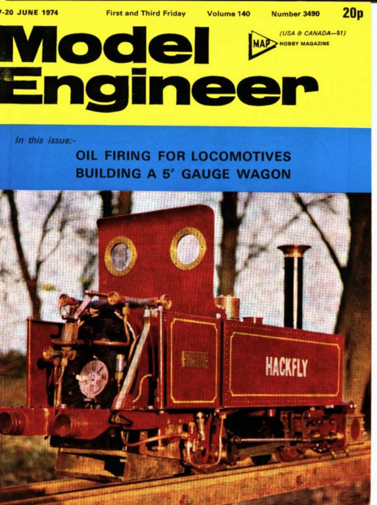

                              Nick Clarke 3
                                @nickclarke3
                                In the early 1970's a member of the Nottingham SMEE built a Hackfly (Sorry if you read this but I can't remember your name) working full time in a gap between jobs I believe.
                                It certainly ran on the Valley Road track and I drove it once but I never saw it loaded to capacity to see just how much it could do.
                                Incidentally there were other articles by Turpin in ME on 'innovations' during the 1950s, and he had been a contributor since 1921.
                                Nick

                                    #487991
                                    Martin Leftley
                                      @martinleftley53764
                                      Nick Clarke, that was my dad Gerald Leftley at the Valley Road track. He built a Hackfly but not from the drawings as he modified a lot of it. He said it was a fantastic Loco if you just wanted to "play" easy to drive quick to steam up and lots of power by the time he finished with it. Also added lights for dark events and pie peas and chip nights apparently. He sold it to LocoSteam who made a kit from it. He built about 6 locos in total but sold them all. In his works he was house buying or buying or funding a motorbike too. I would love to find one of his originals. I know he also built a gauge 1 city of Nottingham live steam, i'm not sure what else i'll have to dig out some of his old model engineers that he had write ups in. If anybody has any info on the locations of anything he may have built that would be amazing.
                                      #488015
                                      Ady1
                                        @ady1
                                        Posted by Martin Leftley on 28/07/2020 16:40:41:
