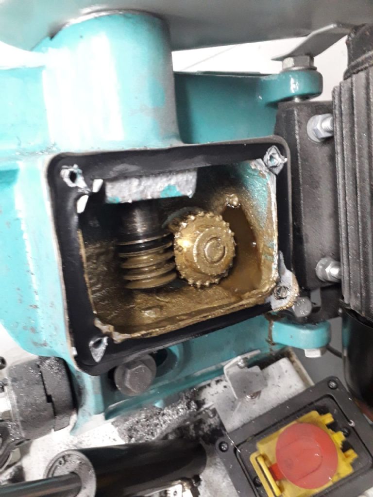

      Opened the worm gearbox in my H80 to replace the OEM oil with trusted quality oil. Found at the bottom a not insignificant of bronze dust mixed with the oil.
      Bandsaw has only seen light use: is this the gears wearing in as they do or a sign that something is dodgy?

          Not a good sign I'm afraid. I had the same trouble on a similar far Eastern bandsaw, traced to poor assembly of the shaft with the worm on it, the bearing nearest the worm had failed. A second problem was with poor alignment of the bronze gear wheel with the worm being offset to the side so that wear was taking place with the worm running off axis.
          I covered my repair in an article in MEW 247 if you have a copy, or can look it up in the digital archive

            Bronze dust would be common in a basic worm drive gearbox especially one that had been assembled but never "run in". I would drain it, wash the dust out and re-assemble with good quality worm drive oil.
            I worked for a company where we made worn drive gearboxes for aerospace use and the worm and wheel were lapped in in a jig. When they were assembled and run on the test rig for a couple of days, They were then stripped and if any bronze dust was found, then the whole procedure was repeated (many times!)
            The inspector's criteria was that his white glove had to be absolutely clean when he rubbed around in the gearbox to allow the "run in" certificate to be issued.

                Don't panic! I opened my gearbox a few months after purchase because the rubber gasket started to weep oil. Inside I found obvious signs of bronze dust but no obvious wear on the worm. I changed the oil and bodged the gasket.
                Because it was a bodge, the gasket leaked again after about a year. Re-opening the gearbox I again found traces of bronze dust but much less than the first time. Again no sign of damage to the worm. I'm pretty sure the dust was due just to roughly made and assembled gears bedding in.
                My bandsaw is the crudest of all my Chinese tools by far. It wasn't lovingly fettled by master tool-makers to meet precision specifications! Nonetheless it works a treat, far better than appearances would suggest possible.

                    When I opened the gearbox of mine it was full of 'liquid gold'.
                    The gear is badly worn, but I did my best to improve alignment and it has lasted years now and the oil is clear of dust.
                    The situation is helped as the gear only turns in one direction
                    At some point a new gear will be needed, though.

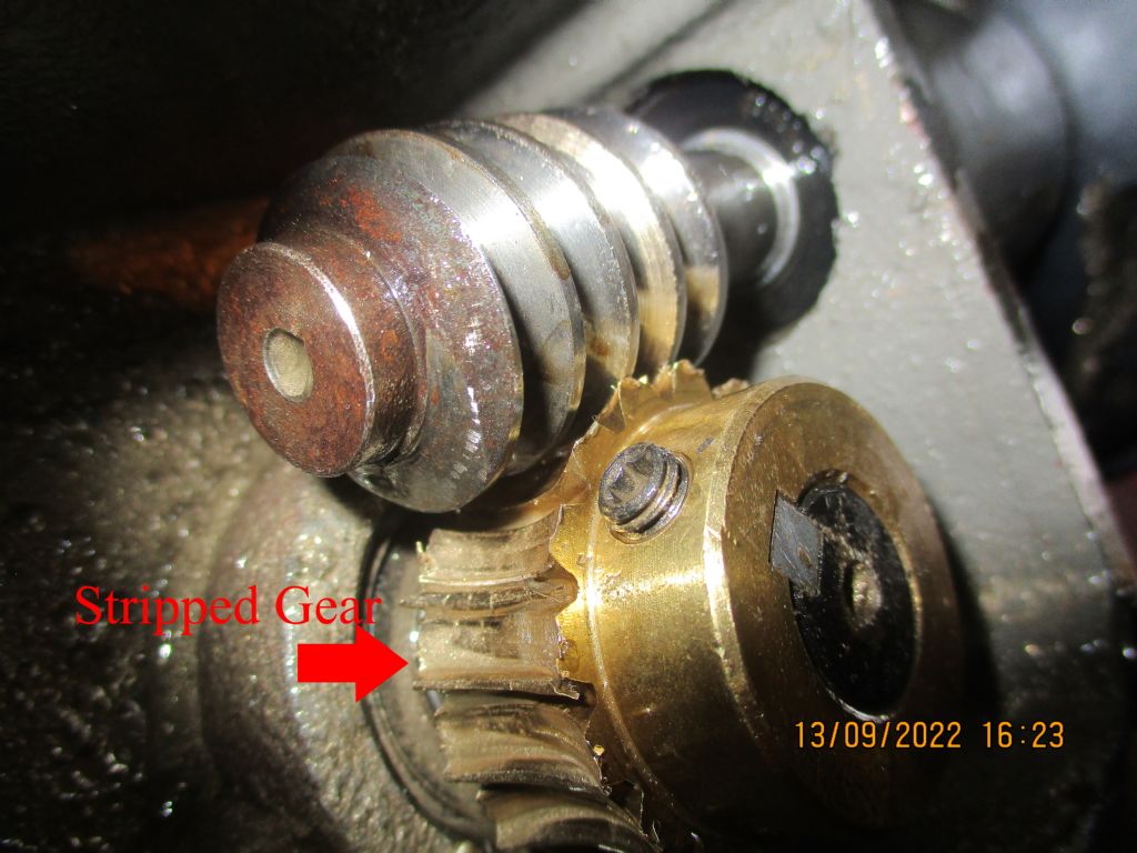

                        stripped gear labelled.jpgThe oil? came out gold coloured suggesting I should have changed it earlier. As there is no filler orifice they must fill it with the saw on its side as it was virtually full. If I am able to repair it then an orifice will be provided.
                        I have e-mailed Chester on the off chance they will have one somewhere otherwise it is going to give me a headache finding one. It is probably beyond my ability to make one. I will have to make a puller to remove it and although it will come off fitting the new one will require me to remove the worm first. Happy days.

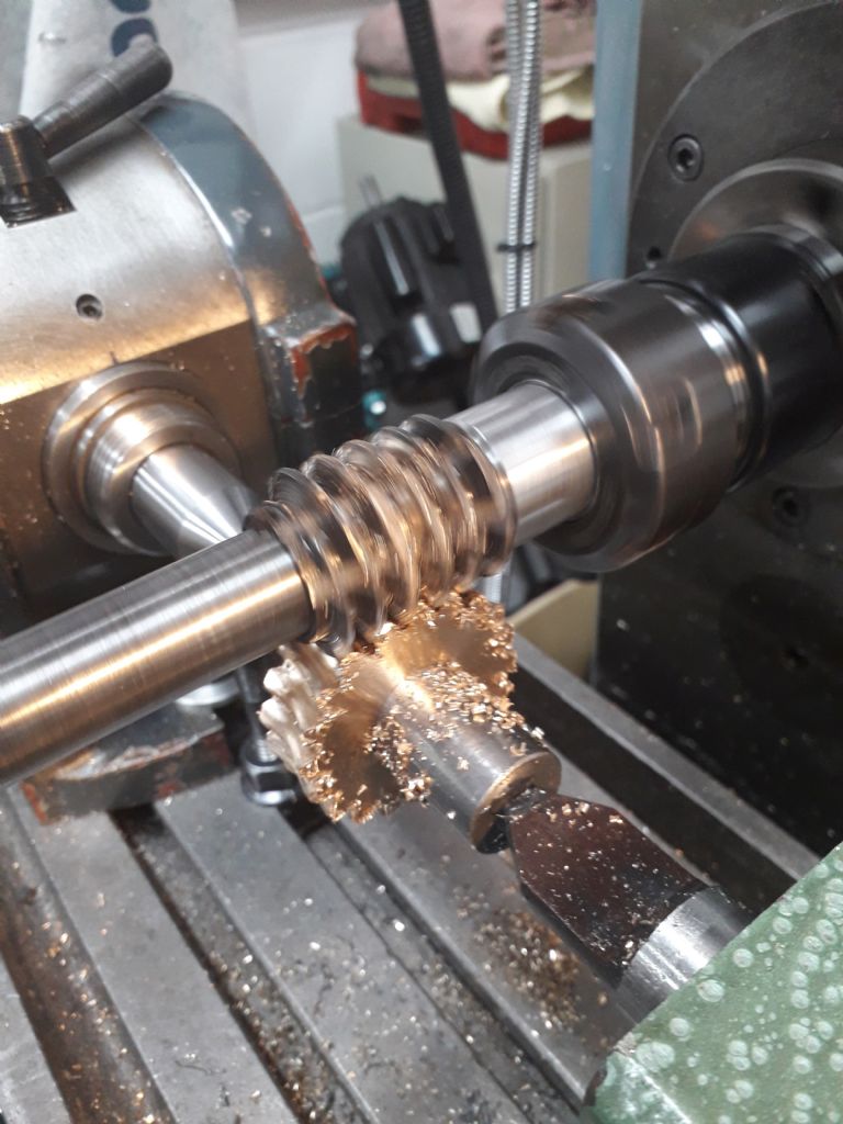

                                  Oh, the optimism, finding an off the shelf item. I faced the same problem a year ago with my bandsaw. I searched high and low and in the end made a new worm and worm wheel as I concluded the original items were rough and poorly fitted.
                                  The yucky mess once the glittery oil had been mopped out:
                                  The worm wheel was so worn that it wouldn't drive the blade. Fortunately my M300, with the right changegear, can cut worms of specified MODs, so I made a worm and a hob. I made a new wormwheel by the free hobbing method, having gashed the blank first to ensure it started hobbing correctly first time:
                                  And while the gearbox was apart, I changed all the bearings just for good measure. A lot of work, and not what I wanted at the time, but I failed to find an off the shelf spare.

                                          Chester responded today with the good news. Part No BAN-SAW-H80-S-052 H80 Brass gear. So I will get one and spend my energy replacing it. Thanks for all the advice.
