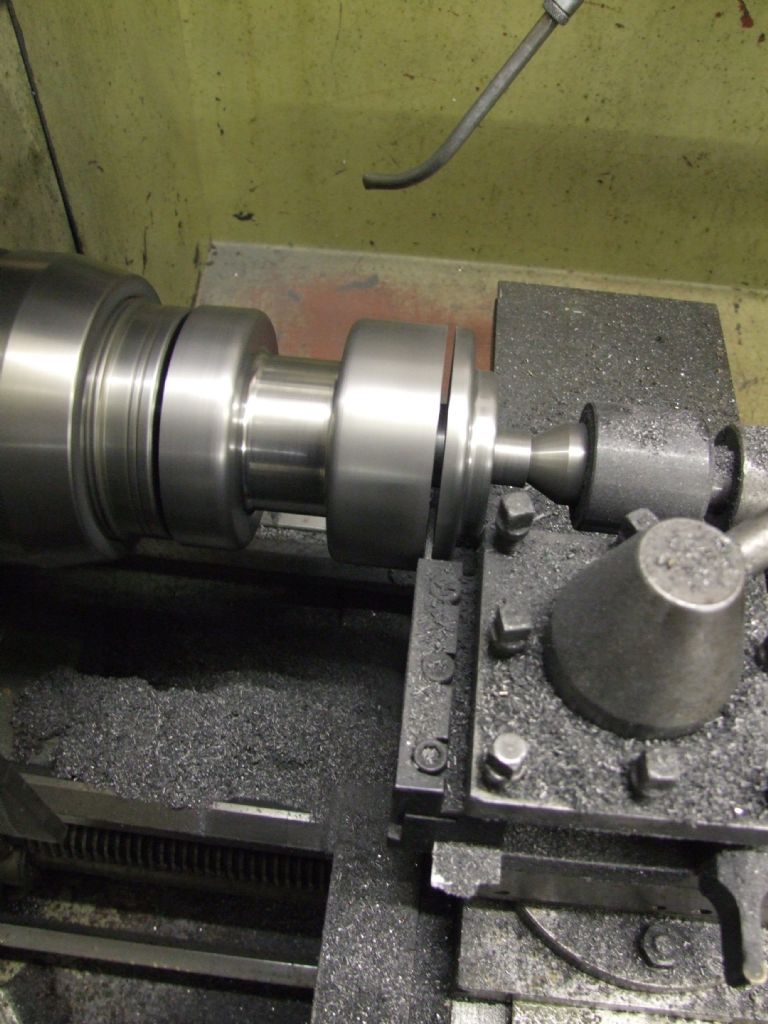

                              #649397
                              Anonymous
                                Posted by Hopper on 22/06/2023 07:47:40:
                                …centre drill the end and put a tailstock centre in place to stabilise it…
                                Like this, on a 3.5" diameter workpiece mounted on an homemade expanding mandrel:
                                Parting Front Wheel Hub
                                Andrew

                                  Have no steadyrest. Have no 4-chuck. Can't centre drill, as the 46mm piece is also 25mm hollow. I did start yesterday making a sort of bull-nose adapter cone for my live centre, but did not try using it yet, as it got late.
                                  I guess I will use the bullnose anyway, even if only see the difference, but I think I need to go for the rear-post as default parting option anyway.
                                  Mind you, the steady/centre/bullnose and the rear post address different problems. One addresses stability of the part, the other of the tool, so they may at times both be needed.
                                  #649402
                                    You can just make a stepped disc to fit into the hole and put a centre drilled hole into that
                                    Also if teh work can be turned around so the groove is at the chuck end that will help
