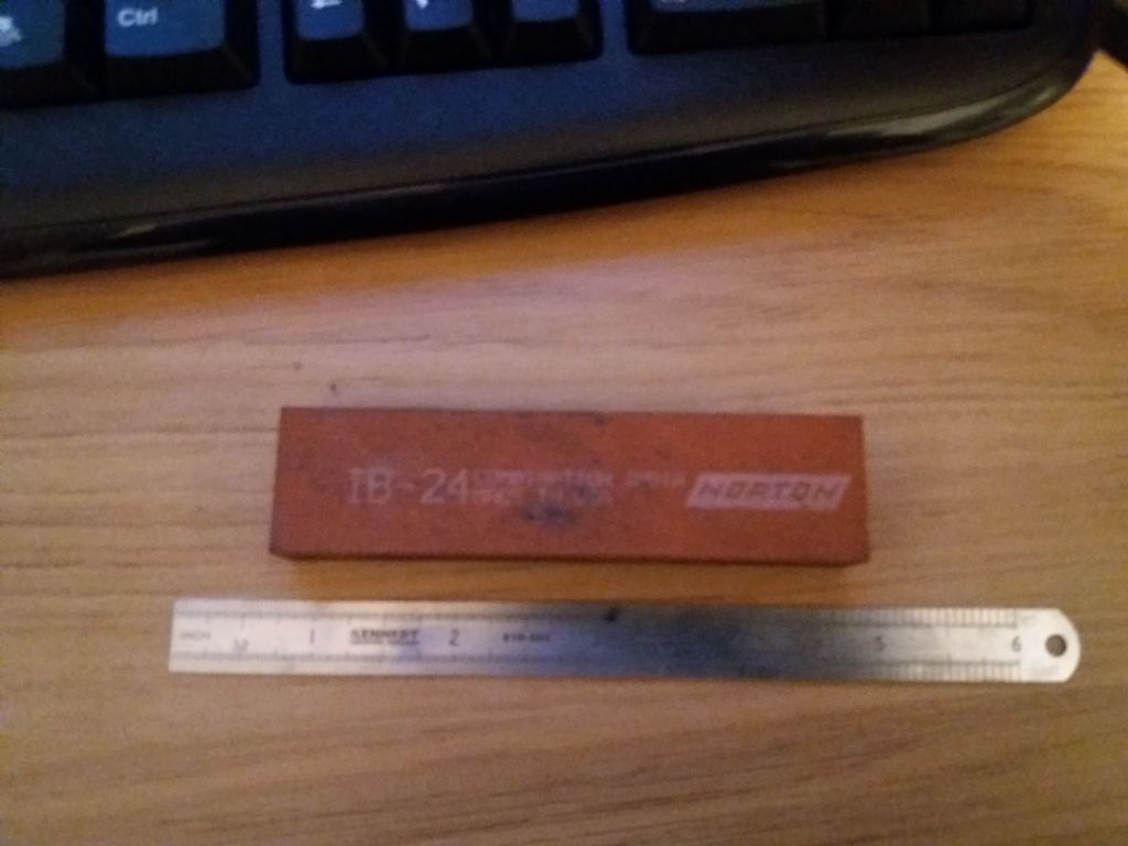

                  Hi Douglas I have always used a Norton IB-24 combination India stone 100mmx25mmx12mm size for rubbing over any mating surfaces like the bottom of a vice or just a rub over the bed of my mill to make sure any lumps are removed. I also have the same stone in a bigger size but rarely use it but it comes useful on larger pieces or pieces with a gap.
