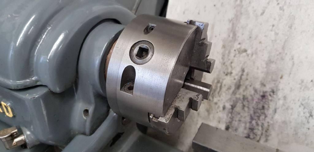

          Well it seems i have the same problem with chuck runout. I found this thread while mosing around, & wow. My blooming chuck is adjustable. I have had the machine a while now & have just worked around the fact that it has a 9thou runout.
          Now thanks to this amazing forum & members i can adjust it (hopefully).
          my chuck.jpgSteve.

                Well i have been i the workshop for a few hours , trying to adjust the chuck. I was having no luck at all. So i took it to pieces to see how it all worked. Gave it a good clean , although it was clean inside.
                Put it back together & started to adjust. As someone said further up the thread , you need to loosen the backplate or it will not move. Once i did that away she went . I have gone from 9 thou runout to literaly zero. I have taken plenty of pics & video of doing it. I will compile it all tonight & hopefully get it uploaded either tonight or tomorrow.
                I also turned a 1" stainless bar 8" long down to check for runout along the bed. Pretty much perfect all the way.
                Once done i will post a link for anyone who has one & having trouble adjusting it.

                  I have uploaded a video for anyone having trouble with these chucks. Hope it is of some use.
                  Steve.

                                  I have read this complete thread over twice now. Conclusion right or wrong is.
                                  There are 2 types of this chuck. The main one is a chuck mounted to a back plate by long screws from the front face of the chuck approx 2" long. These go through clearanced holes the full thickness of the chuck to threaded holes in the mounting plate. The Myford one which i have has a dedicated backplate & is bolted directly to the rear of the chuck by means of threaded holes flush with the rear of the chuck.
                                  I think logically that the front entry bolted type would be much easier to adjust without any slackening of the said bolts. C on the diagram further up this thread.
                                  On the Myford type i can see why it would be much harder to push the chuck sideways when boited directly with short bolts , straight into a threaded entry. No flex The front mounted type has around 1 5/8" of free shank to be able to deflect.
                                  Waiting for the gunfire.
                                  Steve.
