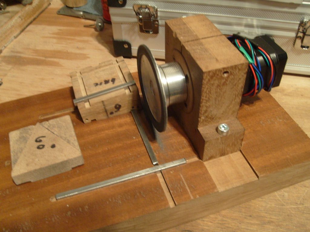

      I to start using the angle grinder to roughly grind the shape in HSS. Then use the bench grinder (white HSS stone) for a better shape. Finally I use a small 80 mm diamond disk (€10,–) and jigs to grind and regrind the tools.
      Drills, mills, slitting disks, roughing mills, rotary broaches and some form tools are ground on the CNC lathe.
      I can regrind a HSS tool faster than replacing an insert. Nevertheless, most of the time I use carbide because they last longer than HSS tools. Sometimes HSS does a better job and small internal HSS threading tools cheap to make.
      My HSS grinder (finish grinder) and some stackable holders.

        Surely using diamond on HSS is counterproductive?
        #633222
        Howard Lewis
          @howardlewis46836
          A diamond wheel gives a very fine finish on a HSS tool, after grinding with a pink, white or grey wheel.. Not much different, but a bit more precise than final honing with a diamond file.
          I said that 5 thou "cuts" were puishing things a bit, but probably better than risking glazing the wheel by tiny licks.
          As ever, there is more than one way of skinning a cat (Not that I am advocating that as an activity! )
          The objective is to finish up with a cutter that does what is required.
