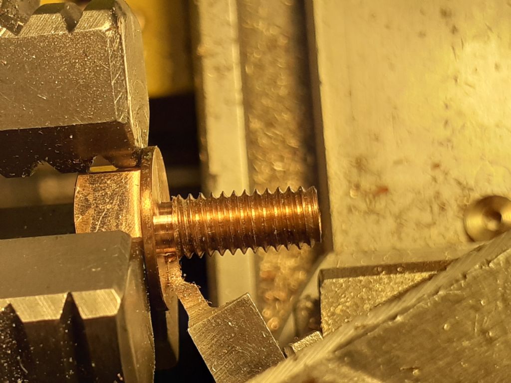

                                  Mick B1
                                    @mickb1
                                    There'll be loads of other way of doing this in the picture, but the value of learning the bench grinder/HSS tool blank game is that you only have to visualise the tool you want – and you can have it ! laugh
                                    'Course I missed a trick there – should've made it a bit wider and ground the 60° back chamfer on the M6 flank…
