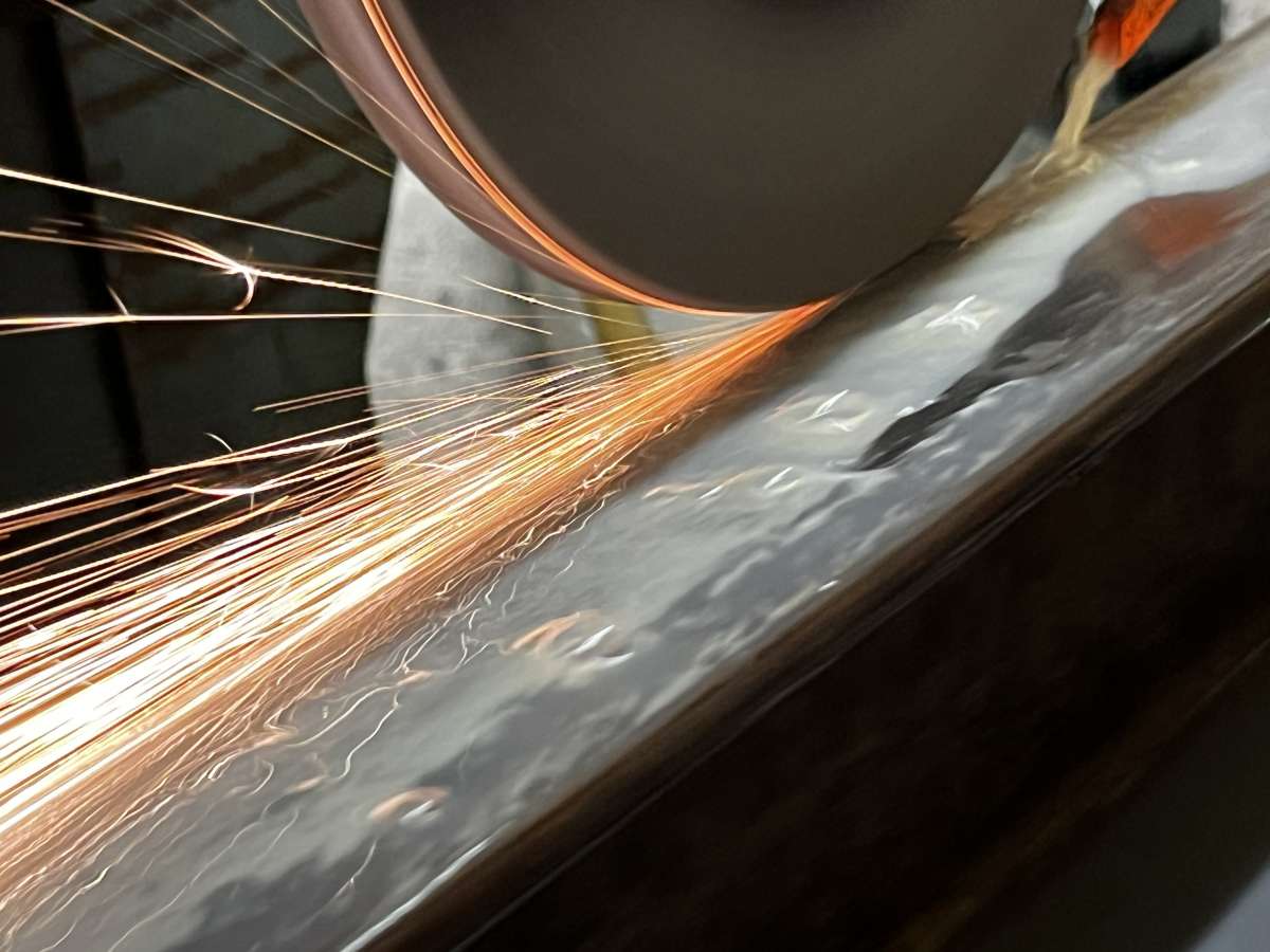

                #730999
                Dave S
                  @daves59043
                  IMG_3977That a wheel wears on its leading edge is true. You can see the cutting is only occurring in a narrow band on this 1/2” wheel. IIRC this is about 4 thou DoC, J&S540, probably a 46K wheel.
                  The narrow wheels will work, but you will have to dress them more frequently. I typically dress before starting and then only “cut” in one direction so the wheel wear is consistent. I’ll often manage to do whatever it is I’m grinding flat in a single dress, but I may redress for a finish pass.
