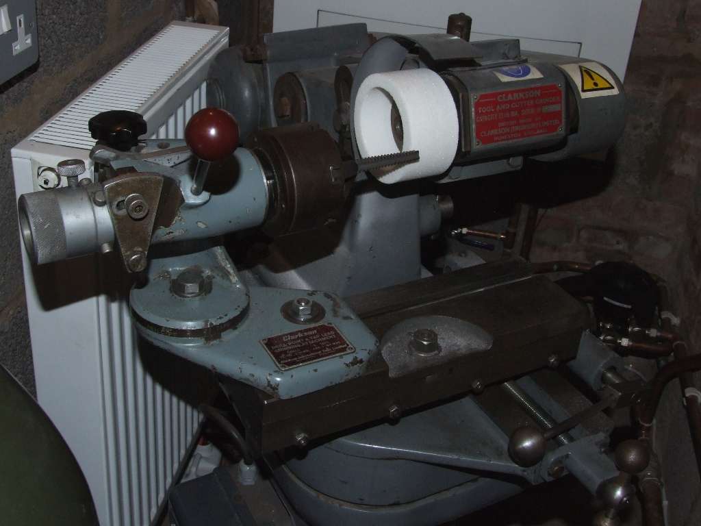

              The Clarkson T&C grinder manuals give examples of the most common cutter grinding operations. A straight wheel and a flared cup wheel will cover most cutter grinding operations. For grinding the lead on taps a straight cup wheel will be needed.

                        I can endorse the advice that a copy of the Clarkson T & C manual or the one from ‘Union ‘ give all the information you need and the Clarkson does everything with a flared cup wheel or a plate wheel except for a heavy straight cup wheel used with their drill grinding attachment.

                          On Earny49 Said:
                          …except for a heavy straight cup wheel used with their drill grinding attachment.
                          Like this:
                          Grinding Tap Relief
                          Andrew
