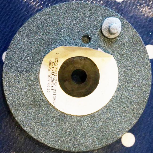

      From Ian Parkin's description of the holes in this grinding
      wheel .
      "But theres another hole on the other side these are nice clearly
      made holes 8mm dia perfectly round and flat bottomed 5mm deep
      ones at 12 o clock and the others at 4 o clock on the other side
      these are put in during manufacture"
      This would seem to suggest that in fact that this wheel has been
      very well balanced during manufacture ,the displacement of these
      two holes would suggest that it has been done on a dual plane
      balancing device.
      The obvious thing to do is to use a containment structure around
      any new wheel when first running up to speed ,this is something
      that i do not only to protect me but also the machine.
      If you have viewed the Don Bailey video you will have seen
      the large amount removed from the wheel to balance it ,he also
      makes the point on the importance of having the wheel balanced.
      The chances are Ian that had you not seen these holes the wheel
      would have been fitted and used without a thought ,how many
      other people peel off the blotters and have a look underneath.

        Pretty sure those are balance holes.
        See 9:00 onwards on this video

          I must admit that I have found this post quite alarming, so much so that I decided to find out more.
          I contacted Saint Gobain and spoke to a chap in their technical department. He said that this is probably part of the testing process.
          Basically they sand blast the hole near the centre for a given period of time to give them an accurate indication of the hardness of the wheel. This is not done on all wheels but on one or two in a batch.
          He also said that putting the dimple near the centre did not affect the wheel in any adverse way.
          I told him that there were two holes in this wheel and he did not seem to think that there was anything to worry about.
          I should also point out that I did make it clear that this was not one of their wheels.
          Regards.

                Those holes in the video are very much like mine BUT i'm fairly sure that my holes are not put in after manufacture but as part of a pressing /moulding operation

                  Why are they there? We can only speculate. They must be intentional. Could it perhaps be to suit some specific machine which has driving pegs on the flanges?
                  I was speculating along the same lines. One thing that would mean is that, if you installed the wheel and then trued/balanced it, you could remove the wheel and later replace it in the same orientation so it shouldn't need re-balancing.
                  Pure speculation though.

                    Perhaps they are intentionally there so that the wheel will not be balanced but by adding mass in these holes the wheel can be brought into balance. The benefit of this approach is that the wheel itself doesn't have to have material removed and remains as manufactured. Where the mass is added will be subject to minimum centrifugal/centripetal force and is well below the useable limit if the wheel.
                    Might be grabbing at straws but an alternative idea.

                      See my earlier post. There is no doubt that these holes are not for balancing but to test the wheel. They are put in post manufacture and do not affect the integrity of the wheel. At least this is what I heard in a telephone conversation with a chap called Simon Peel who works for Saint Gobain / Norton. This has put this matter to bed as far as I'm concerned.

                        The process is called erosion testing. There are mentions of it on google but not many.

                          So eventually David Colwil rang St Gobain up and a guy called Simon Peel who explained what the holes are for.
                          Now as one of the largest grinding wheel producers in the west, also incorporating Norton, they should know but David had to repost this again and probably will have to repost it Yet again as 'our' ex-spurts don't agree.
                          And they you wonder why anyone asks for advise when they know they are going to get 15,837 different answers.
                            Regards.
                            David.
                            Hi David
                            That was good of you to go to that trouble. I visited the Saint Gobian site (amongst others) and read the literature in my efforts to deduce what the holes were for. That expert verbal opinion you obtained works for me, and allays any of my fears.

                              The general opinion seemed to be that this wheel was unsafe (which I was inclined to agree with) but how many others would have bought and used them and how many of them would have seen this discussion?
                              I think we can all agree that nobody should be on the receiving end of a dodgy grinding wheel.
