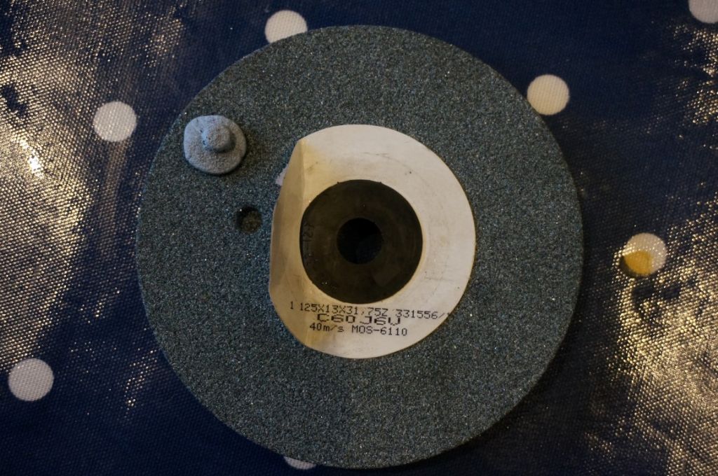

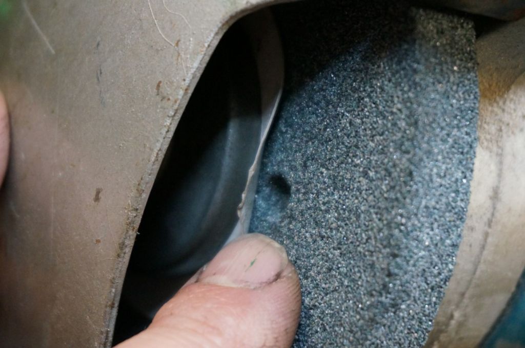

        I bought a grren grit grinding wheel for a small grinder I had
        after mounting it the blotter flapped out slightly showing a hole
        is this ok? looks cast in
        I've never seen a hole before on a stone

              #231206

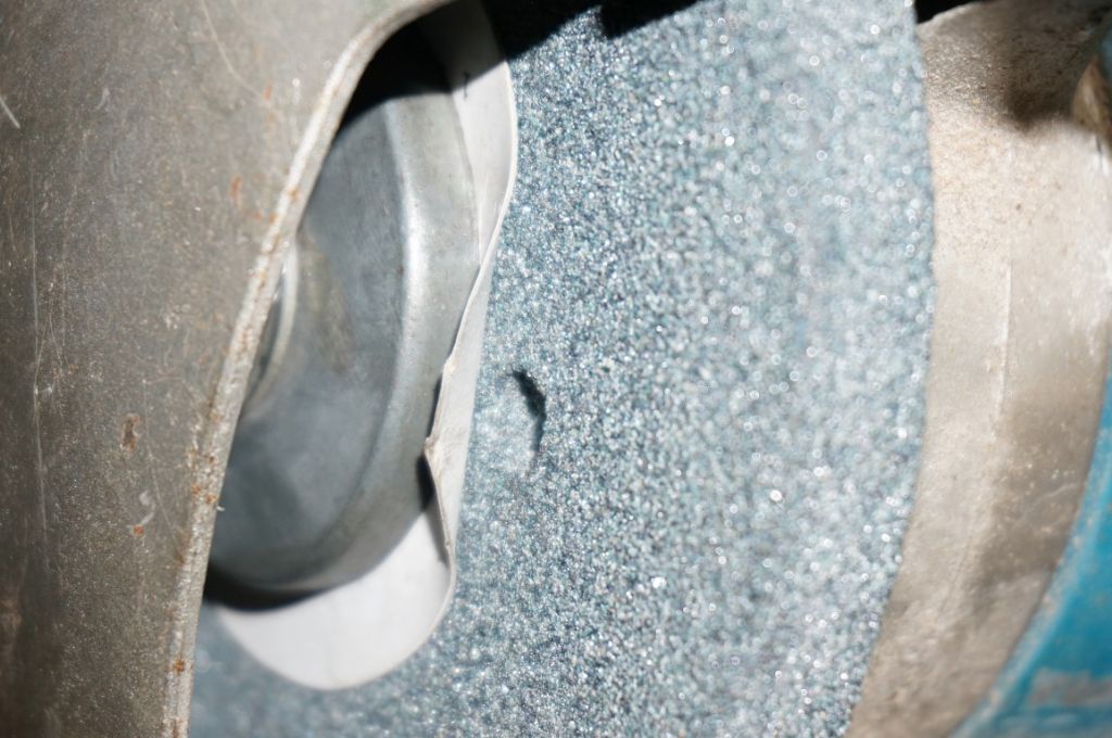

              David Jupp
                @davidjupp51506
                May just be the lighting, but I don't like the look of the 'cracks' starting from the hole (especially obvious in top picture).
                #231207
                Rik Shaw
                  @rikshaw
                  A ring test is good for revealing an unseen flaw in a grinding wheel but in this case it is not needed. With a visible manufacturing flaw like yours the wheel should not be used anyway.
                  I have seen two large wheels explode during my time in the industry – both of which were caused by "stackups" rather than faulty wheels and the power released is scary.
                  Don't take a chance – scrap that wheel before it scraps you.
                  Rik
                  Edited By Rik Shaw on 22/03/2016 18:19:40
                  #231214
                  mechman48
                    @mechman48
                    Posted by David Jupp on 22/03/2016 18:17:13:
                    Having looked again… this wheel is definitely KAPUT!… it IS cracked ! get rid. better still send pics to retailer & get a replacement / refund, & suggest to retailer they check their stocks.

                      #231222
                        I agree with that, I am sure I can see the crack as well.
                        Above all, be glad you didn't try and use the wheel.
                        Well spotted David.

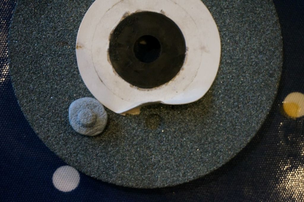

                          #231233
                          Ian Parkin
                            @ianparkin39383
                            Right
                            I pulled it off to investigate more and its definitely not cracked it rings as a stone should
                            But theres another hole on the other side
                            these are nice clearly made holes 8mm dia perfectly round and flat bottomed 5mm deep
                            ones at 12 o clock and the others at 4 o clock on the other side
                            these are put in during manufacture
                            its a 125mm 13mm wide wheel and they are 32mm and 35 from the centre

                                #231266
                                Ian Parkin
                                  @ianparkin39383
                                  Some more photos and a blu tack impression of the holes
                                  And the label which if its not clear is
                                  1 125x13x31.75z 331556/ indistinct
                                  C60 J6U
                                  40 m/s mos-6110
                                  Supplier was chronus so hopefully they will respond to my email pictures todaydsc00941 (medium).jpg

                                  #231271
                                  Ian Parkin
                                    @ianparkin39383
                                    Just had this in from Chronos
                                    Hello
                                    Thank you for the email, the hole is a result of the manufacturing process and it won't affect the performance.
                                    Regards
                                    Matt
                                    Chronos

                                                #231310
                                                  I'm confused. The holes do look deliberate, but I have never seen them on another wheel but how often do we peel off the label and look?
                                                  I am sure I can see a crack in the lower of the two most recent pictures – that said the human eye likes to see patterns where there are none and it could just be a chance alignment of darker particles. (I'm tempted to say I can see the face of Jesus on it too).
                                                  I suggest taking it to someone for a second opinion.
