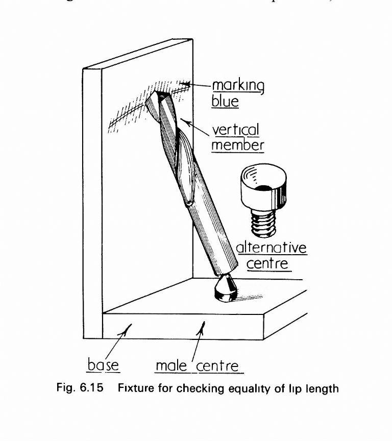

      My favourite drill gauge is the shop made version, made from a 500 x 50 x 2 mm thick strip of sheet metal with a small 50x 50 x 90 degree upset to one end in the middle of the upset a centre pin is added and used to locate the centre in the drill tang (away from the cutting edge). The cutting edge of the drill is then swept across the 450 x 50 mm face marking and arc. A comparison is made between the first flute arc and the second flute arc (sorry could not find a picture).

        This is from Ian Bradley's The Grinding Machine:

          Hi Ega,
          We used to cut a notch in the vertical member to set the 118 degree angle correctly and confirm the cutting edges were the same length (as the scribed line checks the same height only).
          Great picture, needs a modern edit to replace 'engineers marking blue' with 'black marker pen' or perhaps I have this vague memory that some of the old timers used chalk, the history for this tool is probably related to reducing mess:
          c 1880: Marking Blue (mainly used for recreation by apprentices)
          c 1920: Chalk (used on edge by the cutter grinders and very quick)
          c 1980: Black Marker Pen (used by the tool room)
          c 2020: Sharpie Pen?
          Graeme

              Graeme Yorwarth:
              Just seen your post. Good point about the angle. I take it that the notch would be in one or both edges of the vertical member, effectively taking the place of the normal angle gauge.
