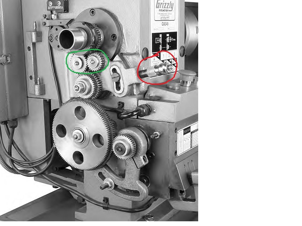

                Thanksall, yes I do have a manual and although it is for the Warco machine they are practically identical. If all else fails I was going to tackle it guided by that … although it doesnt make clear where to start and in what order to tackle it. My lathe has developed a loud rubbing noise and Im suspecting a drive belt or bearing needs replacing.

                  Without knowing what kind of rubbing sound you're getting it is difficult/ 'nigh on impossible' to try and establish a likely cause. If it just a rubbing noise and not a bearing grumble then I would start by removing the headstock end cover and look at the belts and pulleys. It may be that the spindle of the intermediate pulley between the motor and headstock pulleys has worked loose and allowed that pulley make contact with the headstock casting. You could also try disengaging the change gears to see if that helps cause they can make quite a noise if not meshed properly.

                    Thanks I will give it a try and let you know how I get on. Its also turning a slight taper but I suspect thst is operator error or blunt tooling. I have put a video on my blog

                      Mike, That noise sounds like the change gears 'singing'. My Warco 1327 sounds like that if the gears are not meshed quite right. These are the gears that feed the lead screw. Disengage the drive and it will disappear!

                        Have watched your video, link above, and the noise sounds like the change gears are not meshing properly, as I suggested earlier and Mike confirmed above. It is possible that the 'Banjo' has moved, that is the arm which carries the change gears, and the gears are not meshing properly or even just rubbing. If you identify the Banjo you will find a cap head screw at the bottom which locks the Banjo in position. Slacken this then move the Banjo so that the gears are completely dis-engaged from the fixed gear on the spindle and re-tighten the cap head screw that holds the Banjo in place and hopefully that should fix the problem.

                          Thanks very much Andy/Martin. That sounds easy enough. The Warco manual doesnt mention a banjo but does talk about a slider that moves or locks the gears… is that what you mean?

                            The 'banjo' is the arm the gears are fitted to, it rotates around the leadscrew bearing and needs to be secure.

                              Mike,
                              Assuming your headstock is like this, the gears ringed in green shouldn't be engaged unless you are using the saddle or crosslide feed.
                              Move the lever ringed in red to the central position to disengage the gears.

                                Can’t thank you enough guys. I had thought I was looking at a major strip down and costly repair. As it was a min with an Allen key sorted it. Lathe now silent!!

                                      Yep… I had done that… apparently incorrectly. The problem was that the top of the slide frame was actually in contact with the spindle and rubbing rather than gear noise.
