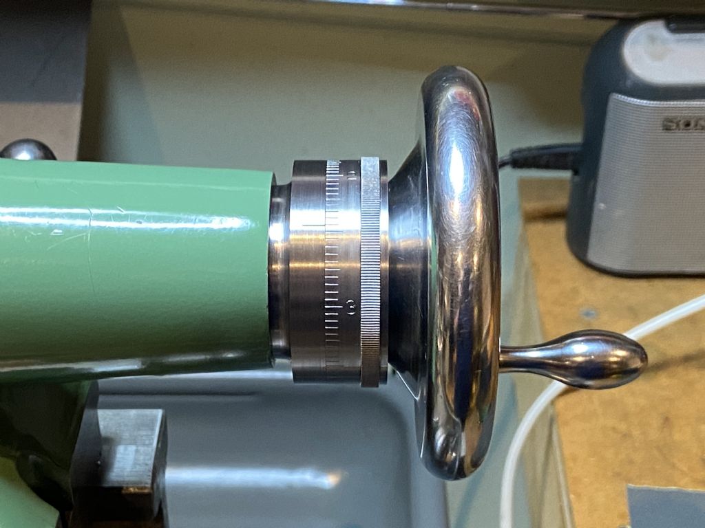

                                #471675
                                Martin Kyte
                                  @martinkyte99762
                                  Haha, finished finally.
                                  Don't know if this was intended or just a happy accident but the holes for the pin spanner are identical to the ones in the small bore adjusting collar on the end of the spindle so the Myford peg spanner fits a treat.

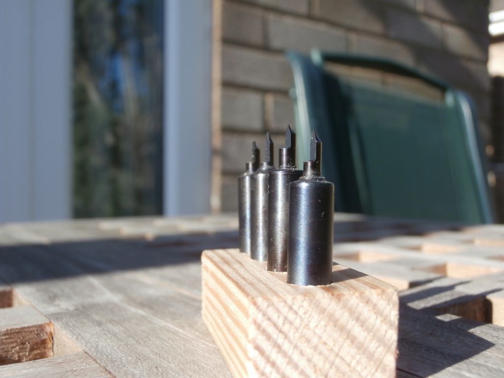

                                      Here are my cutters for the gearing. Turned with button tools from silver steel which was annealed beforehand giving a better finish.
                                      #471702
                                      Martin Kyte
                                        @martinkyte99762
                                        So thats the Tail Stock Topslide and Saddle taken care of. (The Saddle is Graham Meek supplied). All I need now is to make George Thomas' Cross slide modification with a sensible sized lockable micrometer and I'm sorted. Who needs DRO's on Lathes.

                                              #474092
                                              Brian Abbott
                                                @brianabbott67793
                                                Hello Martin.
                                                Can i ask what you used to 'black' the dial ?
                                                #474134
                                                Martin Kyte
                                                  @martinkyte99762
                                                  Hi Brian
                                                  It was actually some cold black from a kit I got about 15 years ago. (BLACK IT brand I think). Don't know hwere from.
                                                  Chronos do something very similar.
                                                  My kit was supposed to work as a several step process and they supplied degreaser, conditioner, blacking solution and dewatering oil. The conditioner had leaked and the dewatering oil was like treacle after all this time. I tried it out with just the blacking solution on a piece of scrap and at seemed to work well so just degreased the dial and lobbed it in the blacking solution. Gave it a good soak in oil afterwards and so far so good. I have to say it does look finished with the knurling black. I planed my straight knurl being timid. Somewhere around 280 indexing operations. I do have straight knurls but with several hours invested in the dial blank I wanted to be sure of a result.
                                                  regards Martin
