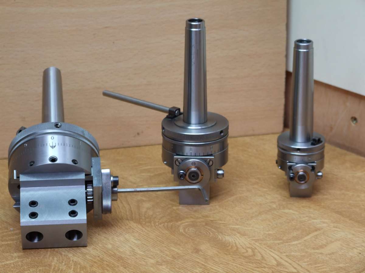

                    I think a bit of chronology might not go amiss. The large B&F that appears in the TEE Publishing book, Projects for your Workshop Vol 1. Is the first B&F that I made, which was in fact based on the Emco design, (66mm diameter). This was originally made to complete a sub-contract job and was made in rather a hurry. A further Intermediate design 50 mm was based on this design and is currently with my good friend John Slater.
                    The smaller 35 mm “New” design with coaxial dial was published earlier than the current 50 mm version which I still have and which was made first. Although the article for this was submitted first before the 35 mm version was made, the 35 mm version appeared first. A larger 66 mm version which was described in Home Shop Machinist some years back went with the sale of the Emco FB2 milling machine. These last designs were an attempt to make a very accurate piece of tooling without the rather large Emco dial appendage whizzing round.
                    A second example of the 35 mm design is currently being used on my Proxxon FF 230. (see the Proxxon Mill post)
                    The smaller one is a godsend on my little mill and the current latest feed attachment for the Proxxon mill was made using this head. It could not have been done any other way given the sizes of my current machines.
                    I hope this clears the air, all texts were written separately, but I would not doubt similar wording would be bound to creep in given the description of what is basically the same design. The design is after all only scaled up or down, but with a bit of tweaking to make the parts fit.

                                DSCF2242
                                There are three versions of this “NEW” style of boring head you can choose from. The largest is 66 mm diameter, the Intermediate is 50 mm and the smaller one you know about.
                                All have been described in various publications, as well as two styles of the OLD B&F heads at 66 mm and 50 mm. Although the latter are simpler in design they do not give a continuous feed when doing Facing cuts.
                                Hope this helps,
                                Regards
                                Gray,

                                    The 50 mm appeared in article form in MEW, the 66 mm was published in HSM.
                                    Regards
