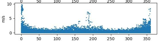

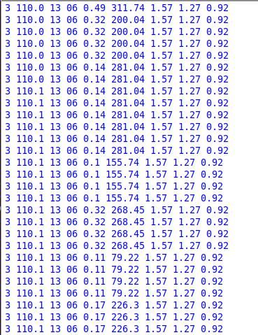

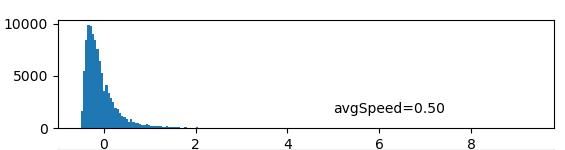

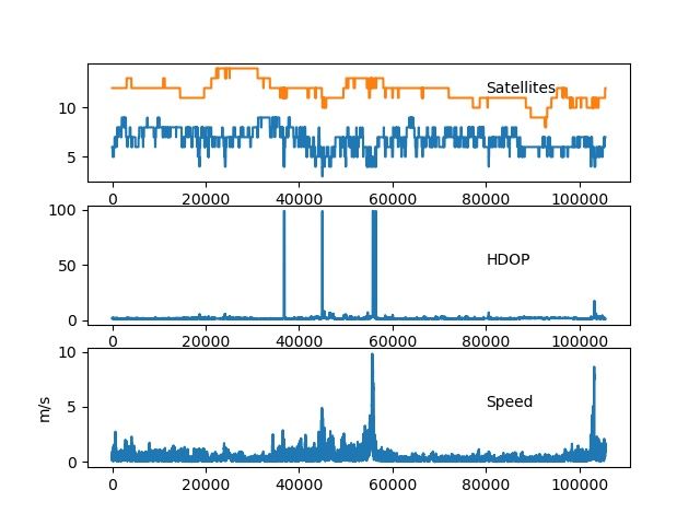

                                To put some numbers on the problem, I've set up an Adafruit Ultimate GPS Module on my dining table with a fixed antenna aimed out of a south facing window. It's view of the sky is limited to about 45° above horizon by a house at the end of my garden, and the antenna is inside the double-glazing. Not good compared with an outdoor installation.
                                The receiver and antenna aren't moving, therefore any speed and direction of travel reported indicate errors due to the satellites moving.
                                The GPS module outputs an NMEA data stream on a serial pin. I've connected the output to an Arduino Nano, which reads the records and forwards them to my main computer via a USB cable. The Nano does no processing, it just implements a USB serial connection so my workstation computer can read whatever the GPS module says.
                                I wrote a Python3 program to decode the NMEA records. Most of the work is done by a python module called pynmea2. It validates NMEA strings, and if they are OK, unpacks them so the data can be manipulated by a program. The program can examine GPS innards in a way most user applications don't reveal. In this case, I'm not interested in the correct time, latitude, longitude or altitude. I am interested in how many satellites are in view and how many of them are being used at the moment to calculate the fix. The quality of the fix depends on how many satellites are used (more is better, but only if their signal strength is above a certain level), and how spread across the sky the are. The fix obtained from 6 satellites grouped close together, is worse than the fix obtained from six satellites spread across the sky: this error is reported by the GPS as Horizontal, Vertical, and Position Dilution of Precision. (HDOP,VDOP&PDOP)
                                The Ultimate GPS outputs GPGSA, GPGSV, GPGGA, GPRMC and GMVTG records. GSA contain fix quality, hdop, vdop, pdop and lists the satellites in use. GSV lists all the satellites in view and their signal to noise ratios. GGA reports time, position, altitude and fix type. RMC reports time, date, position, course and speed.
                                Extracted and collected together, the relevant data, which is output once per second, looks something like this:
                                Quality of fix = 3 (good)
                                Altitude 110,1 metres ASL (about right)
                                Number of satellites detected, 13 (a bit low)
                                Number of satellites usable, 6 (a bit low)
                                Ground speed varies between 0.1m/s and 0.49m/s. At the same time, the course is reported to be between 79° and 311°, actually speed and course are wandering inside an error circle. As receiver and antenna are both fixed, the error must be due to the limitations of the system. Partly GPS itself, but mainly the poor view of the sky the antenna has.
                                I'm letting the computer log data for a few hours. I expect to see the number of satellites used change, and the quality of the fix vary with that. I think the DOP figures will alter too. I'll try and draw some meaningful graphs rather shower the forum with numbers.
                                In theory DOP improves when the satellites being used have wide angular displacement, and reduce when the satellites are in the same part of the sky. The poor position of my antenna probably means it can only see clusters of satellites. Better if the antenna were outside above roof level, but I'm too old for that sort of adventure!

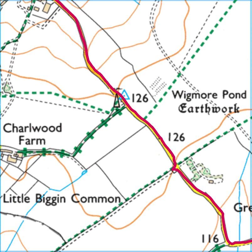

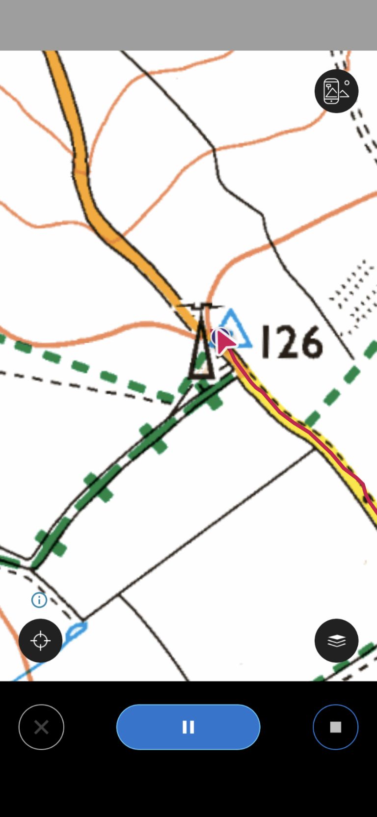

                                  Another couple of "data points". This morning I did a test ride to a nearby village, tracking the route using the "on-road" option on the OS App on my phone and also recording the distance on the GPS cyclometer. Then I returned recording the same route exactly but using the "off road" option, on the assumption that the first will correct the positions since it "knows" they should be on the mapped road but the second wouldn't.  Most of the time the phone was just tucked into a jacket pocket.
                                  Part of the outbound track:
                                  I was cycling to the southeast. Note more of less in the middle of the grid square the mast on the SW side and the trig point which is a few metres to the NE. The "kink" in the track a bit further along is me stopping.

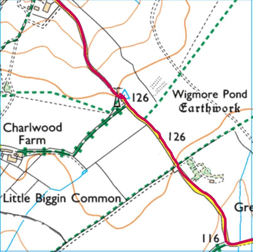

                                  Now the return track:
                                  The track is clearly a bit more wobbly but for the most part stays on the road. I did stop briefly just by the trig point and there it thinks there's a slight overrun and reverse which can't be seen at this scale.
                                  Distance out recorded as 20.45km, back 20.4km. Both 1.04 hours. The cyclometer recorded the outbound trip as 12.74 miles, back as 12.70; 20.5 & 20.43 km.
                                  I'm not sure what this indicates except that the OS map App is pretty good at tracking a cyclist on road and off road, though it clearly uses its knowledge of where the roads are. It's also pretty consistent and agrees well with a different GPS device. The phone is a Pixel 4a, uses a Qualcomm platform so therefore the SiRF GNSS, and is multi-standard GNSS. Also uses GPS assistance data.
                                  Finally I took this screenshot while I stopped by the trig point.
                                  I stopped on the righthand side of the road, The trig point is probably 5 metres into the field there, so the location accuracy is pretty impressive to me.
                                  Edited By John Haine on 11/11/2021 15:02:21

                                      My 'on site' experience and also that of overlaying tracks onto maps in a GIS is that the given precision is usually pessimistic.
                                      #570996

                                        Consistent with Neil's comments, here are my results over a few hours for a fixed GPS, registering course and speed despite the receiver not physically moving at all. Why?
                                        First of 3 graphs below, shows the number of satellites in view (orange line), varies between 13 and 7, while the blue line shows the number of satellites with signals strong enough to use. It varies between 9 and 3. The choppy blue line suggests my receiver frequently has to switch between satellites as they transit overhead, might cause trouble.
                                        Second of 3 shows the Horizontal Dilution of Precision. Although HDOP remains fairly low, the graph shows my GPS loses the fix on 3 occasions, and suffers a major drop of quality on a fourth. The third graphs shows speed peaks during the HDOP crises, and HDOP crises correspond with the receiver only picking up 3 or 4 usable satellites.
                                        All three graphs show that GPS loses the plot whenever satellite signals are compromised. Many reasons for that, such as reflections, solar activity, interference and obstacles, including 'weather'. In a typical consumer GPS, the receiver is unlikely to be of the best, but even the best receivers struggle with grotty antennas. The aerial in a portable GPS or phone is poor: prone to interference and reflections because they are too close to the ground, small and deaf, and maybe pointing in the wrong direction! In contrast, surveyor GPS perch a large sky-orientated antenna about 3 metres high on top of a pole.
                                        Next graph is a histogram of speeds centred around average speed. The spread shows a mathematical filter applied over time would conclude the unit is barely moving on average. But it's hard to tell genuine slow movements and apparent movements due to the system apart. Another problem is the histogram scale shows there are fast outliers, the maximum being 7m/s. The outliers match the speed peaks noted when HDOP goes crazy due to too few usable satellites.
                                        Next graph is harder to explain. The scatter shows the relationship between speed and course. I expected both to be random, showing the unit to be moving about inside a small circle and they're not. There are two clusters at 0/360° and 180° suggesting my unit's apparent movement has a North / South bias. Possibly to do with my antenna only seeing an east-west arc of sky because my house and neighbouring properties block the North and South views. Dunno!
                                        Even though outdoors with a good antenna in the clear would reduce the errors, the results suggest GPS isn't a good way of measuring slow speeds at ground level. Not awful, just not reliably accurate.
