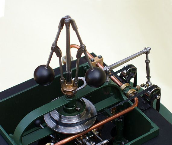

        I thought my method of making pin joints in governor linkages might be of interest. Trying to copy full size practice can look clumsy. Mine are made from standard taper pins. First the joints are made and drilled undersize. With the joint assembled, a taper pin reamer is used to enlarge the hole to a suitable size. When happy with the appearance, the joint is taken apart, and the centre portion is reamed a little more. Reassemble the joint and try the fit. A light tap with a small hammer, with the joint supported, will fix the pin in place. Try for free movement. If it's too stiff, take it apart and ream a little more from the centre part. If the fit is too sloppy, the ream the complete joint. The actual joint pin is a short piece of a taper pin. I shorten the thin end first, and round it over with circular strokes on an oil stone. I then lightly drive the pin into a tapered hole in a spare bit of rod to do the thicker end. A medium domed shape seems satisfactory, but a hemishere can be achieved if preferred. The result can be seen in the photo. The rest of the engine can be seen in my album if you are interested.

                That looks fantastic Maurice. Better than my clumsy 16BA screws!
                Can you give an idea of size?

                  I am sticking my neck out here because I have no experience of governors but is it wise to rely solely on a taper?
                  The governor is vital in stopping the mechanism 'running away' in the case of a fault, so I would want a tiny split pin or even just a steel clockmakers pin at the smaller end.
                  There is only a very little difference between imperial and tapers. A while ago when I cast around for a small stock of brass and steel pins with reamers all to either one system or the other, the people I spoke to didn't seem to know what they were selling.
                  The fact that there two systems, almost identical, could lead to dangerous mis-matching.
                  Which system does the model eng fraternity favour?

                    Thanks for the kind feedback gentlemen. First the drive belt. This is still a problem really. The main snag is that it has to pass through the governor fame, before joining (no rubber bands then! ) When it was originally exhibited, the belt was made from two pieces of gummed brown paper parcell tape face to face, with the end staggered to make a lap joint. It was surprisingly strong, and worked well, but had to be removed, as something in the paper was attacking the steel pulleys. Next, I mannaged to make a belt from thin leather, with a scarfed joint made with contact "Evostick", applied and joined staight way, and clamped. Again, worked well but more corrosion. Jason B might try either of these for his engine if the the belt can be removed when not on display. The belt in the photo is a piece of black ribbon from a haberdashery shop. It looks the part for display only, but I can't find a glue for it that is flexible enough to go round the pulleys.
                    Neil asks the size. If you mean the pins, they are about 3/32" at the thick end, its really a matter of what looks right, since the other end is obviously smaller, it has to be a compromise. The engine is one inch to the foot. I can tell you the leading dimensions if you wish. Let me Know.
                    Yes Merlin it is just the taper that holds it, plus a film of lacquer. I would point out though, that the engine runs at about forty RPM, rarely, and is always checked over first. I am not advocating this joint for anything that has to do serious or lenghty work. I wanted a method that worked and was visually satisfactory at the same time.

                              Yes, that is very close and therefore something to be careful about, because an unsecured taper has to be a perfect fit otherwise it isn't a fit at all.
                              I still think that relying on a light tap, on an important speed controlling device, is optimistic.
                              I presume that Maurice is using pins and reamers of the same system.
