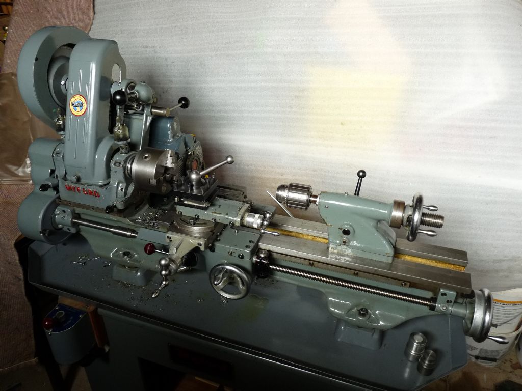

                        andrew winks
                          @andrewwinks64215
                          Why.
                          It was twice the price of a NEW Chinese lathe.
                          Selection Criteria. It is in great condition, very well maintained, in original condition. Has clutch. Large quantity of accessories, Bernhard 4 jaw, tooling – used and new boxed, never used, carbide insert boring bars, parting off and general cutters. I'll not go into more detail but I counted up AUD 1,000 very quickly.
                          #177824
                          andrew winks
                            @andrewwinks64215
                            Why, the decider.. because this is a product of British engineering artisans. Its got Made In England cast on the back below the gap bed. One cant walk past it and not lay a hand on those shiny handwheels. So the purchase has fulfilled several requirements. Its a machine of good parentage and its had a sheltered life. Its a enduring product of the Empires golden age and will willingly complete tasks as requested. Sounds like a sermon, but buying this gear has a certain feel good factor!

                                CotswoldsPhil
                                  @cotswoldsphil
                                  Hi Andrew,
                                  Looks clean and cared for. Is it a later wide guide model? 1973 onwards, or narrow guide similar to the ML7. Mine is just before the changeover and I have been doing some experimentation making it into wide guide without any machining. I ask because if it is narrow guide I would be interested to know (once you get it installed) what the gap measures between the rear shear and the saddle (both ends).
                                  Small point, the manual shown in the photo is for a ML7R – there are a few differences.
                                  Michael, how are you getting on with your ML7R?

                                        andrew winks
                                          @andrewwinks64215
                                          Hi Phil and Michael M. and G
                                          Yes, very well cared for. Have seen so many really abused machines but when I inspected this one, was amazed at the condition of the bed and how firm everything else looked. That was the decider plus the tooling supplied. I recall buying my large Taiwanese machine many years ago, the necessary extras, which barely filled a shoebox set me back over $1,200! I bought it for Son 1, but he's a bit worried now…he's out on a rig off somewhere and emailing for more pics…I keep telling him…wot Myford? Dunno anything about any Myford?!
                                          can you walk me through the measurements, not sure what you mean. Will the serial number advise the date of manufacture and other detail? Good spot with the R suffix on the manual cover, despite the outside grubby appearance, I doubt whether anyone has ever thumbed the pages….who needs to read manuals!
                                          feel free to PM, no doubt Myford owners would be interested to follow the discussions, non Myford people would be groaning…not another long winded dialogue about plurry Myfords!

                                          CotswoldsPhil
                                            @cotswoldsphil
                                            Hi Andrew,
                                            Like you I took the best part of a year searching for a good Super 7 at sensible money.
                                            I'm sure the non-Myford members will allow us to continue…for a bit.
                                            Here is a link to the Serial number page on lathes.co.uk – a mine of information.
                                            **LINK**
                                            The change to wide guide ie. the saddle uses both shears, not just the front shear with a narrow guide surface on the rear of the front shear happened at serial number SK1088913 <> August 72
                                            If your machine is before the switch…the gaps I'm interested are the gap(s) (left and right) between the the back of the saddle and the vertical face of the rear shear. I'd expect it to be around 0.5 mm or 0.020 inch in old money.
                                            Neil – Should I start a new thread?
                                            Neil – Are non-Myford owners being tested – the last 2 editions of MEW had ML7 and Super 7 confused?

                                              Mike Poole
                                                @mikepoole82104
                                                This is the ML7R which is a pre power cross feed Super 7 with the ML7 cross and top slide and no clutch, the clutch can be fitted as an upgrade. I think this is the one just made to confuse.
                                                Mike

                                                CotswoldsPhil
                                                  @cotswoldsphil
                                                  Hi Neil
                                                  If the main cover was closed you would see ML7R not Super 7 badging thinking
                                                  For the avoidance of doubt here is an original ML7; this one has the optional clutch.
                                                  Note the very different headstock, but I agree, there is no badging to tell you what it is other than a Myford.
                                                  The B suffix indicates a Gearbox is fitted !  So you could have an ML7RB.

                                                  andrew winks
                                                    @andrewwinks64215
                                                    G'day Phil
                                                    The serial number of this machine is SK 103828 so according to the lathes.co site, it's vintage is 1971-1973. Have I got that correct?
                                                    I'll check to check the book to work out what you mean by the "shears"… Sorry, bit slow on the uptake.
                                                    Andrew
                                                    #178314
                                                    Mike Poole
                                                      @mikepoole82104
                                                      The shears are the machined guideways of the bed that the saddle and tailstock run along.
                                                      Mike
