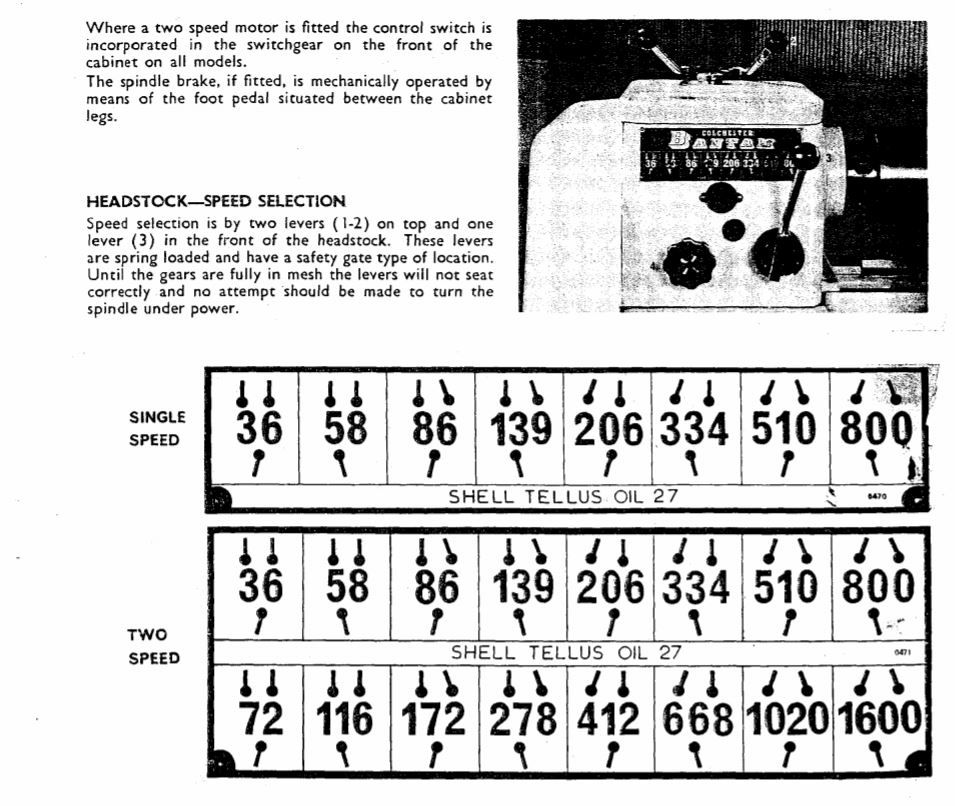

      As Andrew says the Bantam 2 speed motor is controlled by a 2 speed switch/contactor arrangement, 800rpm spindle speed in low range with max 1600 in high range. Full wiring details in the manual.
      From memory there are 6 selectable speeds by lever in each of the ranges, lowest being 32rpm in the 800rpm range.
      Tom
      If you want copy of the manual send me a PM (click on Message Member at bottom of message) with your email address and I can send you a copy.
      Mistaken on the number of selectable speeds in the above post, chart below provides the correct number and speeds available. Threads available and feedrate speed charts in my picture album.
      Emgee

      Tom Walker 1
        @tomwalker1
        Thank you Emgee. Yes, Ive got my head round the gearbox, so all good there.
        I was initially thinking 16 speeds would be rather good, till the infintely variable scenario of the inverter came along.

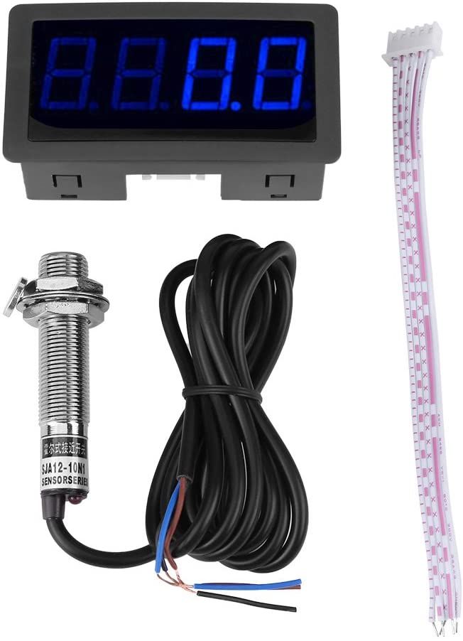

                              Tom gets my sympathy – calculating RPM when the lathe has lots of gears is a pain, though one of the advantages of VFD speed control is most of those gears are redundant. I like Andy's suggestion of timing a nut running along a thread, but having to do that for every speed or gear change would soon get old.
                              Buy a tachometer. They come in various forms : hand-held (where the operator points a pistol at the spinning object), and direct measuring panel-mount or boxed. Not the Inductive type sold for IC engines because they detect ignition pulses which lathes don't have!
                              Instead a Hall Effect or magnetic tachometer like this example:
                              The rise and rise and rise of VFDs in modern times is 'quite interesting'. Their advantages are such that it's common to connect 3-phase motors to a 3-phase supply via a 3-phase VFD. Big savings in professional installations by exploiting their energy management features; the electronics provide a multitude of control options.
