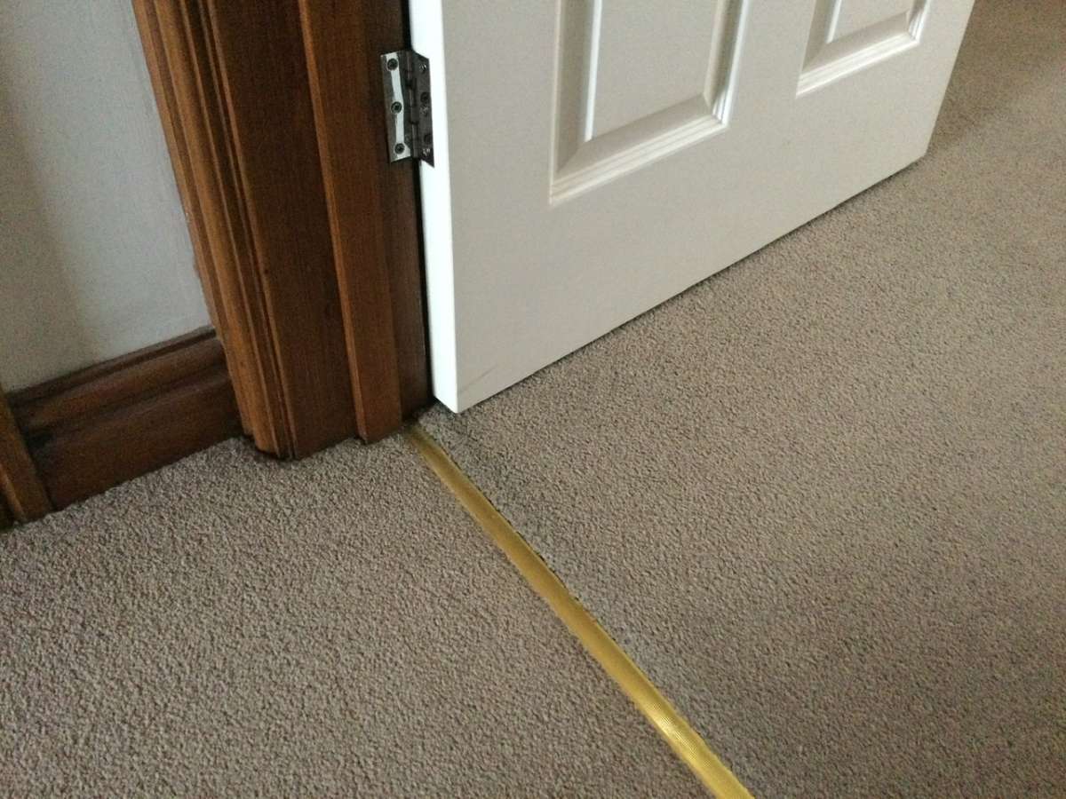

      Hi folks,
      I need to hide some awful gold coloured carpet dividers between rooms in our house. These are gold anodised aluminium I-sections that the carpet tucks into from each room under each door.
      Pulling the carpet out and lifting each divider and replacing with silver coloured ones will be too much hassle and work and disruption.
      So I have been wondering how to hide the gold ones. I wondered about painting them in situ but there is far too much chance of getting paint onto the carpet – especially with me doing it !
      I recently saw 20mm wide, 2mm thick strips of silver anodised aluminium at a local store and these would be ideal – they look good and there is plenty of clearance under the doors – but how to fix them on top of the dividers ?
      Screws would be too visible and clumsy looking, so I want to know what sort of glue to use. I tried a forum search and looked at the Loctitie website but am none the wiser.
      Any suggestions for a glue to secure anodised aluminium together ?
      Many thanks.

        A good many tears ago, I was involved in using a structural aluminium adhesive . It worked a treat, but I am afraid I cannot remember the details. However it does exist!
        Andrew.

            I’m pretty sure Epoxy would work, but is this a good idea?
            • Glue just as messy as paint.
            • 2mm is quite thick, possibly enough to stub toes, or be dislodged by a hard hitting vacuum cleaner brush or boot.  Glue doesn’t like sideways swiping.
            • Does it matter if the new and old bond so firmly that they can’t be separated when the carpet has to be replaced?
            • Aluminium strip may need to have the edges chamfered so it blends in and looks pretty.
            • Again for looks, make sure the strip isn’t so soft that it scratches instantly into a plug ugly mess.   Quite a lot of DIY store Aluminium is soft.
            I’d experiment on a small scale before committing on a large scale.  If the trial goes at all badly, probably better to replace the old grippers.   Not messy, choice of colours, and designed with to take a beating from feet and cleaners.

              I would use silicone sealant. You have a large bond area so it should work well. It will also have a bit of give. I’ve used it for bonding stainless steel racks to bathroom tiles to avoid drilling holes. A friend used to make display cases with wooden ‘angle’ edging and glass sheet using only sealant as a bonding agent.
              It’s cheap and easy to apply.

                  All suggestions welcome, but just to answer some of SoDs:
                  1. Potentially yes, but glue is clear and also much more viscous, so it won’t splash like paint can. Also with glue I can apply a narrow strip of glue along each edge of the aluminium strip away from the carpet, and then safely invert the strip to stick it onto the carpet divider.
                  2. The tops of the dividers are about 10mm below the carpet level, so no problem there.
                  3. No. We will never want brass/gold coloured trims, and I have gone though the whole house changing all the door handles, locks and hinges from brass to silver metal coloured ones.
                  4. The strips have rounded edges as supplied.
                  5. Fair point. The gold strips are not scratched, but we will have to see how it goes.
                  Yes, I will try one first. To change a gripper section; carpet from each side would have to be teased out from the gripper section and rolled back, which would probably need one of those knee kicker things. Then the gripper section would need to be prised up from its fixings into the surface underneath – concrete or wood ? Then nine new gripper sections would need to be purchased and fitted, and the carpets tensioned to fit neatly and smoothly back in place. The latter process probably requiring a carpet fitter to do it right. Doing this to all nine door strips would be too much aggravation and cost.
                  If I can securely-enough glue a ready made aluminium strip onto each gripper divider, it will be much easier process.

                    I’d use SikaFlex EBT+ adhesive / sealant. Stronger than RTV silcone and sticks well to anodised aluminium.
                    Robert.

                        Clean with acetone and then use Araldite – don’t get that on the carpet!  –  or live with gold !

                          The trick I use when gluing Aluminium, is to have some kind of abrasive like scotchbrite. Put glue onto the surface and on the piece of scotchbrite. Using chopsticks or tweezers , abrade the surface keeping it wet with the adhesive. Don’t clean it , do on the 2 pieces, then assemble. This takes away the oxide layer and keeps the oxygen out. You will get the best possible adhesion with this method.
                          This works really well with epoxies, like the the 24 hr Araldite, also with loctite range of adhesives as well.
                          Permabond came out with a 2 part acrylic compound in the early 80’s. One was an activator, the other bas the bonding agent. In the original documentation is where the above about abrading a surface came from. Used the light brown liquid on both surfaces after they had been cleaned with a solvent to remove any grease or other contaminates. The opaque paste went onto one side over the activator, and assemble. It came in a fast curing, around 90 seconds, and a slower curing at a few hours.
                          Silicon will be a good choice , as it will at some time be required to be removed. Acetic acid cure will attack the aluminium over time. You want a neutral cure silicon or a SikaFlex adhesive.

                                I suggested EBT+ because it’s not silicone but is flexible. Ther is a lot of force on these strips when stepped on. A completly rigid adhesive like epoxy is likely to crack. Toughend acrylic (I use Loctite Multibond 330) is good for bare aluminium but not so good on anodised surfaces.

                                          Nine doorway carpet dividers, 18 carpets unhooked and rolled back. The dividers removed and new ones bought and fitted. Then 18 carpets put back and stretched tight and hooked back in.
                                          Versus fixing nine metal (or plastic, come to think of it), strips on top of what is there.
                                          What is the trick, and do you live near Hereford by any chance ?
                                          (Thanks all, for the other ideas).
