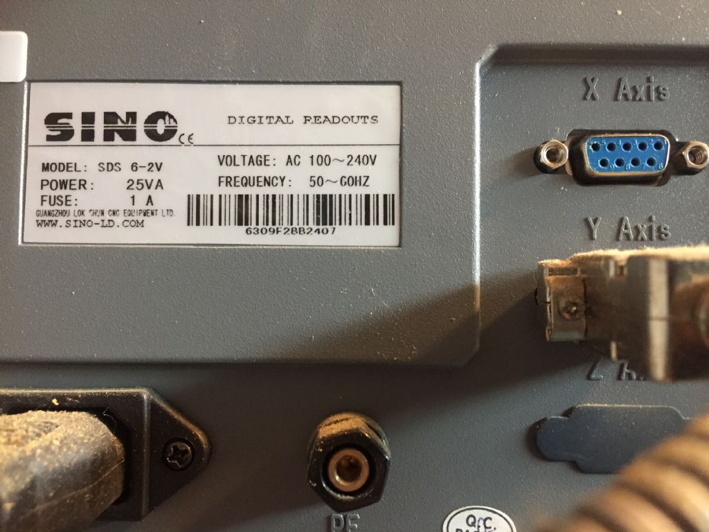

      I have a Sino two axis DRO and one Sino glass scale , which I got (sort of) for free. The scale I have will fit on the Y axis on my mill, but I'd like to buy another for X.
      I'm having trouble finding anything advertised as directly compatible with my DRO. All I've been able to find out so far is that the DRO inputs want TTL, but otherwise I have no idea.
      This is the DRO:
      Arc have some scales which would fit the bill price/size-wise , but they have 7-pin DIN connectors, so not plug and play. But maybe the same technology? I have a soldering iron!.
      Any advice?

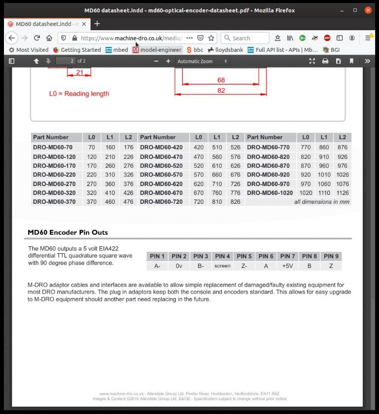

            Quick look at M-DRO's website and their glass scales are TTL output and the same plug type, as they sold Sino and there current ones look to be own branded Sino that would be the safest bet.

                  According to this **LINK** M-Dro scales have RS422 output. They might well drive a unit expecting TTL, but if not a simple interface board would sort that out. More info on the Sino kit needed. The manual for the display is here **LINK**, but it doesn't give the required info

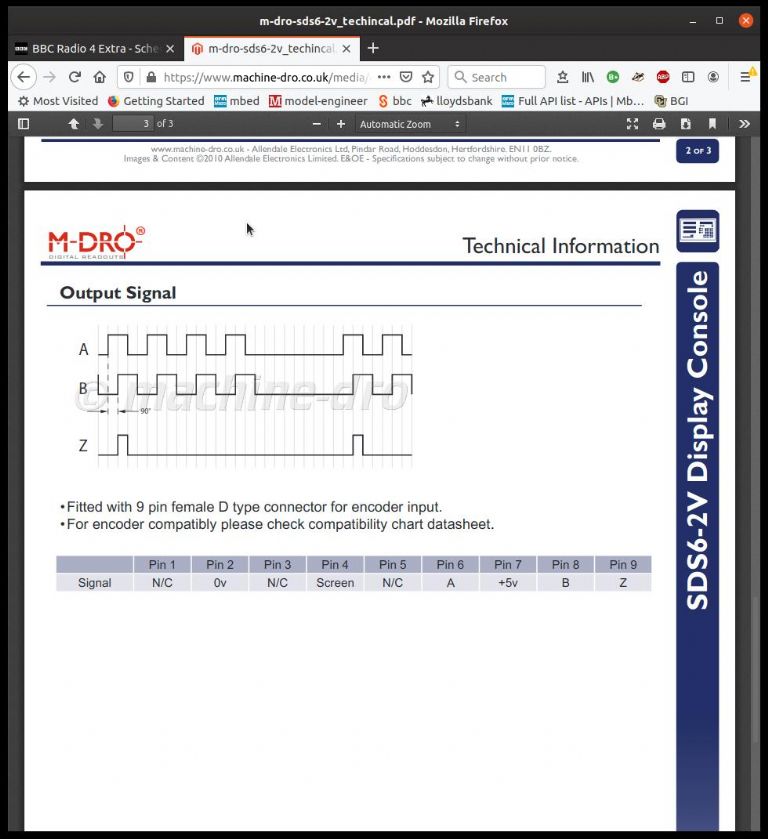

                    M-Dro technical info sheet for SDS 6-2V here
                    Page 3 gives signal requirements & connnector pin-outs. Doesn't look to be anything special – A & B count channels, Z reference mark channel, 0V, 5V & screen connections

                        TTL = transistor-transistor logic signal, for simplification purposes it just means square wave.
                        The unit you have is pretty much the common standard for budget scales and head units so any of the regular scales you'll find should fit it. You'd have a more difficult time finding new scales that didn't.
                        See if you can find the manual for the head unit because you might want to change the scale resolution setting. If you can't you better get a scale with the same resolution as the one you already have so that it reads correctly.

                              Looks like the 9-pin D-connector is standard, but with two variants.
                              TTL means the logic is common as muck 5V rather than old school 80V, or 12V, and not super modern 3.2V
                              First variant of the D-plug is wired as shown in Nigel's example:
                              This is straight plain TTL. Note Pins 1, 3 and 5 are not connected.
                              The other variant is the same as above except it additionally uses Pins 1, 3 and 5 to carry the inverse of A, B and Z. Providing positive and negative versions of the same signal makes it possible to drive longer cables.
                              There's a good chance a display head will work with either convention, possibly automatically, but it may be necessary to explore the head's set-up menu to set one or the other. '232' means Pins 1,3 and 5 aren't used, '422' means all 9 pins must be operational.
                              A 422 only display won't work with a 232 only cable or scale, which is fixable as per Duncan's comment with a converter, but the other combinations should fly. It's worth just plugging it in to see what happens. The differences between scale, cable, and display are very unlikely to cause smoke!
                              Another problem might be making the display match the scales calibration. For example, the Z reference might fire every 50mm or every 100mm or some other value. Likewise the A/B steps (resolution) might be 0.01mm or 0.02, or whatever…
                              If the display works, but outputs the wrong measurements, check the display head's set-up menu to see what options it has: may well be possible to change them to match the scale.
                              Final point, beware of using ordinary RS-232 data cables. They use a different wiring convention, for example pins 2 and 3 are often crossed over.
                              However, the exam question is about ARC's 7 pin DIN connectors. Not enough wires to be EIA422! I think this is the manual for these scales.
                              It suggests this DIN 7 pin wiring:
                              So I'd chop the DIN plug off and rewire the scale to a 9 pin D-connector according to the M-DRO SDS6-2V table, first image above. I see ARC's site gives the Z reference point and grating pitch for their scales.
                              Black to pin 2
                              Blue to pin 6
                              Green to pin 8
                              Red to pin 7
                              Yellow to pin 9
                              Shield to pin 4

                                So what does the Z pulse do?

                                    Reference pulse. Depends on the scale maker – some have one pulse mid travel, others have a pulse near each end.
                                    Used to regain a fixed datum after power off – if the axis is referenced before a datum is set, the same datum can be found after a power off by re-referenceing the axis.
                                    On rotary encoders, the signal comes once per revolution. When used on a spindle encoder geared 1:1, it is the reference pulse that is used to synchronise the start of threads on CNC lathes.

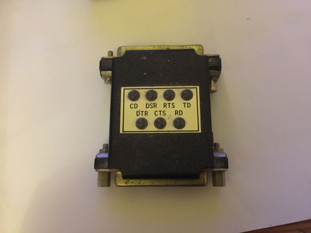

                                                It's an RS232 diagnostic thing – if I remember right the LEDs flash Green/Red according to TTL False/True voltages. Might it be pressed into service here ?
                                                Robin.
