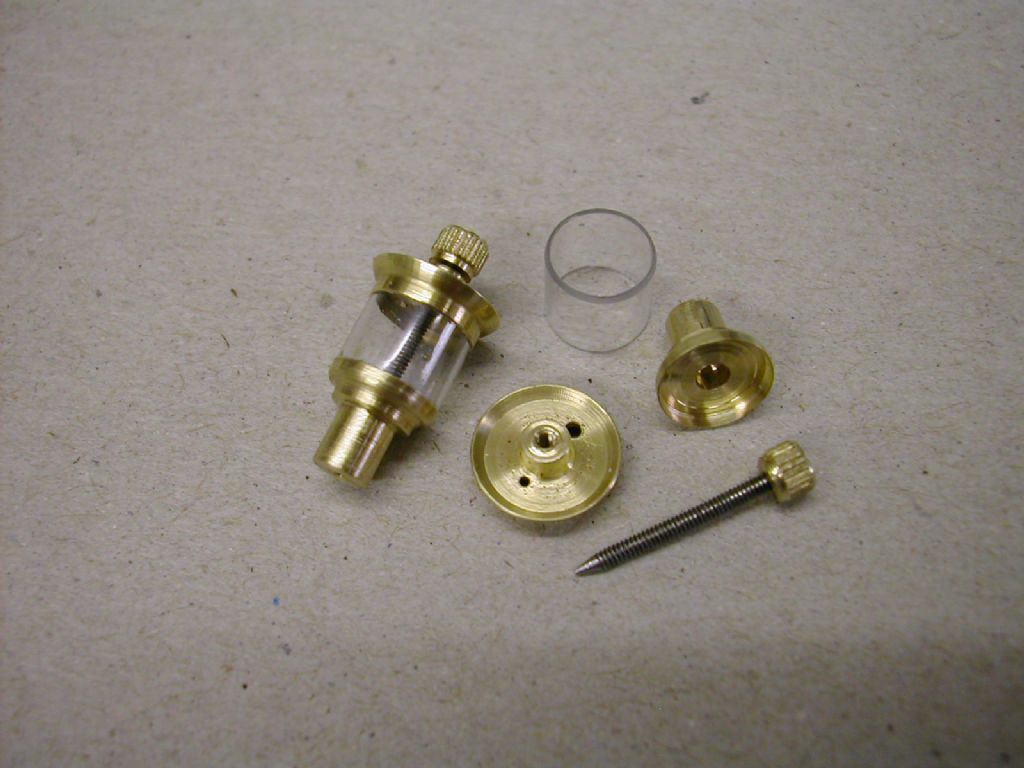

      All, I'm building a Princess Royal mill engine:
      **LINK**
      And as a change from machining the larger parts, I am looking at designing a set of oilers for it. The Stuart Turner oilers I used on the 10V are neat, but I guess not realistic since they're open at the top:
      So I'm looking at the 'glass' type oilers. In previous posts, Ramon suggested using cut-down acrylic model rod storage tubes, so I found some, and drew one up on CAD:
      Before making a set of them, I'm wondering if I'm on the right lines with the design? I've spigoted the ends of the acrylic so that it fits snugly into the brass cups at the top and bottom. I've made a test piece, and although it fits together nicely, presumably it needs Aralditing together, which seems a bit "non-model engineering practice":
      Obviously, it needs its lid, and a hole in the base, which itself would be profiled correctly, and a threaded boss added. Intention is to use a small BA screw in the lid for filling, and also, if I turned the threads off and tapered the end, it could actually work in terms of being adjustable. Alternatively I could drill out the screw and use a needle in the centre.
      I would design a set of them at different sizes for other parts of the engine such as the crosshead and crank pin, but perhaps accept that on the eccentric, an open type would have to do due to space constraints.
      Am I over-thinking this?
      Should it just be a cap with a screw rather than a needle valve?
      Are oilers at this small scale usually "dummies" and you just fill them with oil?
      Is assembling with Araldite acceptable, or should the acrylic be threaded somehow (would be tricky!).
      Any suggestions welcome as always (as would be sources of commercially available items of this size.
      Thanks.

          'Araldite' is no less prototypical for a Victorian or Edwardian style engine then acrylic!
          So its use is fine, as long as it's invisible inside the joint.
          No reason why you can't use a needle-valve. In original practice the oilers were either of that pattern or used worsted trimmings acting as wicks with a syphonic action, but the lubricator body was often of steel or brass. The operating-manuals of the time warned to lift the trimmings when the engine was to be closed for a while, so as not to waste oil.
          Nor indeed, why the innards can't be dummy fittings or non-existent, with the body of the oiler being basically a good-looking funnel to feed the bearing a few drops of oil directly from a can at the start of the running session. A model engine like this is rarely run for long periods, and exerts very low forces on its bearing surfaces, so oiling like that with a good quality lubricating oil will keep it happy for some hours. I'd use the sort of oils used for lubricating lathe slides etc., rather than motor-car oil.
          What I would say though, is make the "glass" shorter to look right. It is normally of a height about equal to its diameter, and the whole unit not much higher and quite compact. The example in your photo of it on the journal, is out of proportion with itself and the bearing.

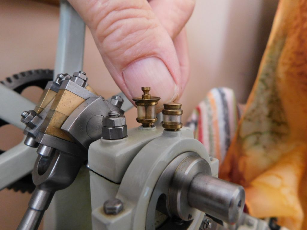

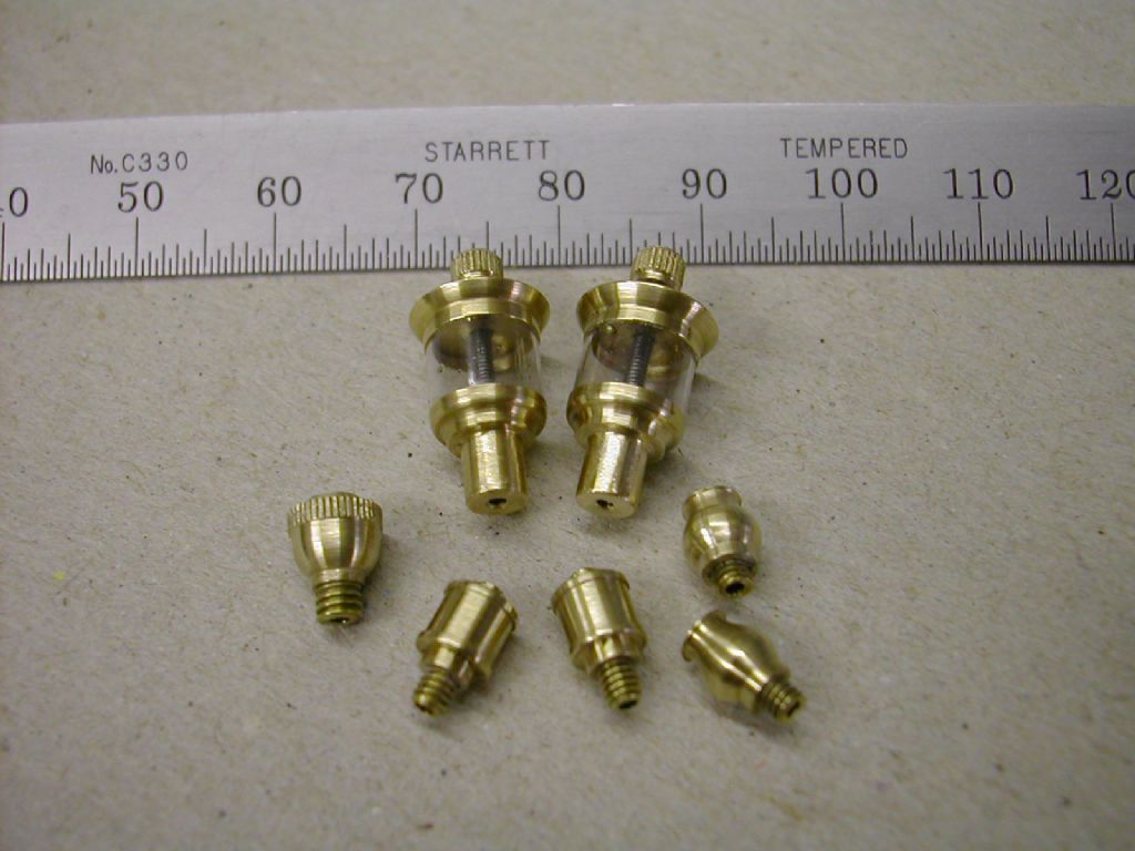

              Hi Doc, No I wouldn't say you are overthinking this but would agree with Nigel that as you have them they appear rather tall. However, when you look at images of engines or those in museums there is an absolute myriad of design of oilers to choose from so you can pretty much pick and choose.
              Here are some pics from mine made for the Waller engine.
              I don't 'turn' the 'glass' merely slide it on a piece of ali turned to suit as a mandrel and just part it off using a sharp pointed tool. This gives a tapered edge where the glue can form a seal. I use the thick super glue, the thin can create fogging in the glass (same as on a canopy)
              The bottoms can be threaded but I turned a fine taper on these so no pressure is put on the glass in a turning movement when removing
              Some of the other oilers made for secondary shafting etc

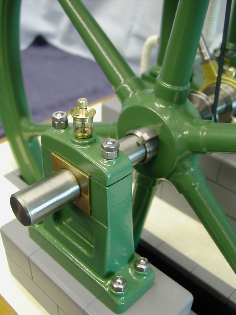

              This is the main on the Waller pedestal bearing
              And these are the very first made on my Twin Vic
              That should give you some more ideas but as said you are on the right track, just cut the length down a bit.
              Best – R

                  Full size use glass tube with no spigots which Ramon's tube replicates, the top and bottom have a lip that just overhangs the glass. If you do make from acrylic rather than thin wall tube then you can also shape the glass, there were some nice designs about.
                  They were sealed with cork washers but that is because they had a vertical centre section and the top could be screwed on to apply pressure to the cork. At your scale that can't be done but I do them that way on the hit & miss engines.
                  Also if just sticking them together don't get carried away screwing down a needle as it's likely to pop them apart. Full size and large models use a cam type action much like a bicycle axle quick release that lifts the adjustable needle to open and close the flow with just a light spring pressure to hold the needle into the hole when closed.
                  Full size also have a vent and or filler hole so you don't upset the needle setting trying to fill through that.
                  As Paul says many had an open or glass enclosed neck with cutouts so you could actually see the drips, probably too small to get the glass in but a shaped neck and cross hole could just about be squeezed in if wanted.

                    Nice work as usual Jason but hard if not nigh on impossible to replicate in Docs much smaller scale especially the lower sight area if you want it to actually work. The flip over lifter would be too – good looking oiler thoughyes
                    I've tried to do this Paul but its not worth it at this scale as the dimensions are so small the oil does not move so it's a simple replication at best from a metering point of view.
                    Bernard, though real glass can be used it's fraught with difficulties in cutting accurately and cleanly piece to piece. Besides the constant breakage the pieces of broken glass become an issue too and the wall thickness makes for small volume. The clear plastic tube is so much better from all aspects on these oilers.
                    Jason, I doubt very much if the joint is properly glued the needle screw would have that much jacking force – it's only screwed down with the slightest of force between finger and thumb – never had it happen so far though a clumsy movement of my hand once knocked the glass and the top off one. If that happens clean the traces of super glue off as CA does not like sticking to itself that well.

                          Thanks all, very helpful.
                          I'll stick with the parallel tube, and the spigot location method because it gives a good shear area for the Araldite to grip. I tried Araldite last night, and this morning the assembly is rock solid.
                          I'll turn down the centre portion of the 'glass' slightly and polish it back clear, to give the impression of lipped caps (the O/D is currently a bit oval anyway, plus the wall thickness is a bit thick, so all good).
                          I'll reduce the glass length to 6mm, flatten the upper cap a bit, and add fill and vent holes.
                          I'll also re-design the necked part at the bottom slightly, cross-drill it, push a tight fitting drill smeared with vaseline down the oil hole, and fill the cross-holes with optically clear Araldite to form the sight glasses.

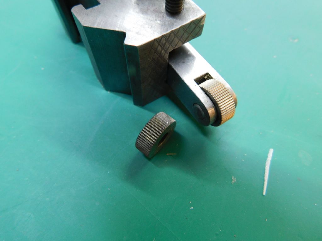

                          What is the best way to form the knurled adjuster tops? Do I need a special knurling tool? I've got a crosshatch tool, but it's a bit dodgy.
                                  The first straight knurls that I did before buying a set of straight wheels were done by grinding a point onto the end of an old ctr drill or HSS cutter and holding that stationary in the mill while the work was indexed round in the rotary table and then traversed back and forth for each cut, took a while but came out OK. But do bear in mind the scale, at 1/18th you want a very fine knurl

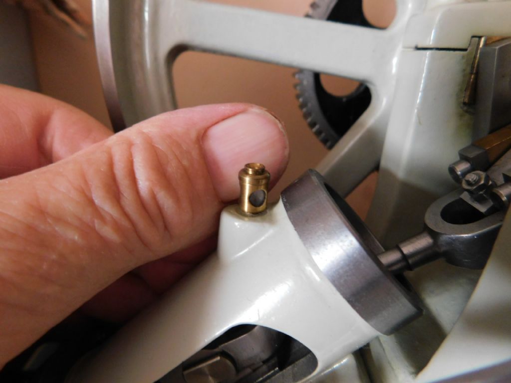

                                    Though Nigel has it right with using wicks none of the small oilers on my engines have had any fitted so far. That said the oil boxes on the Marine Compound main bearings have been set up so with an inner tubing for the oil to wick into.
                                    You can also get some practice in on shaping on the lathe as well as the mill as Jason suggests but you do have to have a means of division. I use a very fine knurl mounted in a simple push type holder. This is fine for brass and works well if the knurl is presented at a fine angle, cutting/forming on the rear edge, and moved along and back over the workpiece.
                                    That second Knurl is surplus to requirements so if you would like to make a similar tool you are welcome to it. Send me a PM if so

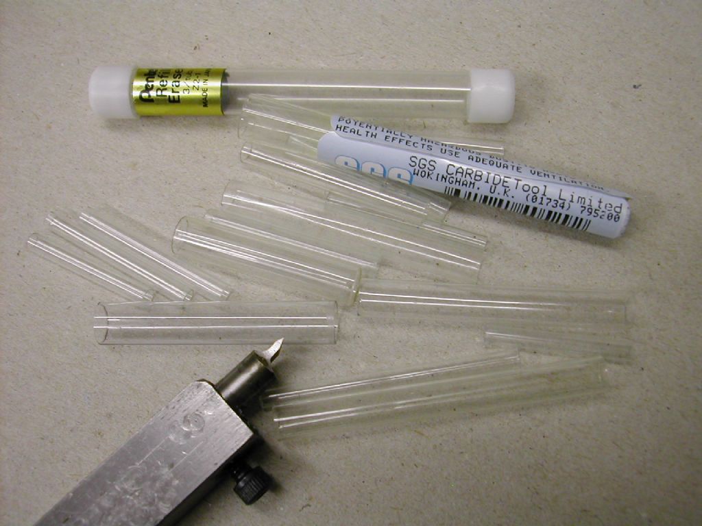

                                    Here are a few more oilers made using plastic tubing on the Double Diagonal engine which may give food for thought
                                    These are quite old and have developed an oily patina but that disappears once full
                                    Like Andy my very early attempts to make an oiler were using 'proper glass' in the form of sight tube glass, cutting it isn't so much the issue but doing it in very small lengths was and the breakage rate was high so that's when I looked for an alternative and began using the protectors off artists paint brushes. At first these were from my own but when I asked at the local art shop if they sold them they presented me with a box full of redundant ones and just said help yourself. Machining them from solid in acrylic is just as good but with tubes you don't have to polish the insides.
                                    Hope that's of use – R
