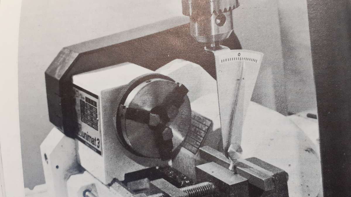

                          Yes I was just looking at the BCA link Michael posted yesterday. one of those in 2000 would have cost £10,000. Looking back at a couple of MEWs from that time there are no adverts for a similar size machine. So in 2007 when I bought my X3 for £849 (would have been cheaper from ARC) an X2 size mill was about £450.
                          It’s a bit like expecting a Halfords £99 mountain bike to ride like a £10K top spec one from a respected brand or that Dacia to be like a Porsche.
                          Interestingly they also used the simple split feed nuts and jacking screws that these machines have
                          Yes they are a bit rough around the edges as Tony says but learn to use them and they can produce good work, In my case I have to judge that by being able to win medals & awards or people wanting me to make models for them as they like what they have seen.
                          There is also some skill involved that will only come with time, not going into the workshop for months at a time will set you back a bit and it will take a while to get back up to speed.
                          I do also feel there is too much of a tendancy to work to numbers. It is so easy now to pick up the latest digital  measuring device and just because it reads to X No of decimal places think you need to hit that number. When I started with the Unimat 3 I did not even have a dti after a year or two I made one of these which together withs  100mm tri square that I made at school was all I had to set up work or the machine. Still managed to make a 10V that I can blow into now and it runs.
                          20240621_163345
