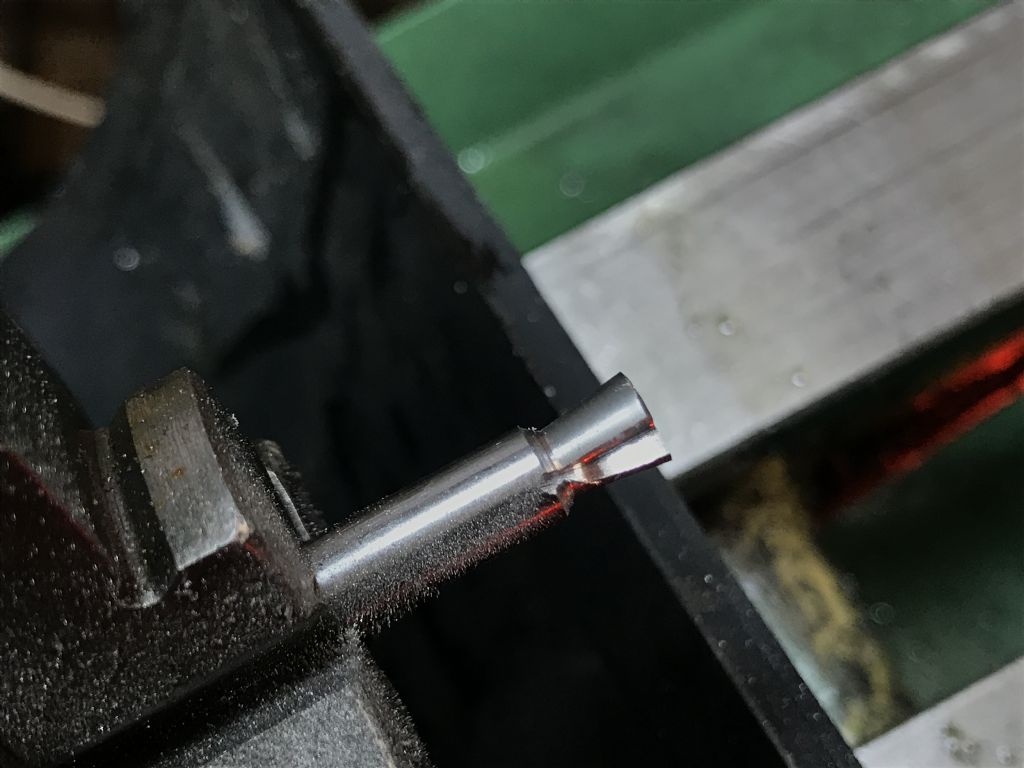

        Evening folks, I'm in the middle of a Hemingway GHT Rear Toolpost kit for the S7. I'm very much on a (re)learning curve WRG to lathe work, so please be gentle & use lots of lubrication.
        The turret requires a slot milling in it to carry the parting blade, straight forward enough…however, the slot needs undercutting by 8deg on the top & bottom edges to create a dovetail for the parting blade to seat into. GHT blithely mentions in passing that he simply makes up a cutter out of silver steel to perform the undercut…hmmm. The supplied Hemingway drawings show the cutter in its completed state with no info how to make it. I'm assuming that this is something a more experienced bloke would take in his stride, but it's beyond my current skillset. I've searched the forum & the internet for either guidance or an off the shelf readymade 1/4" 8deg dovetail cutter, all to no avail.
        Any help would be appreciated.

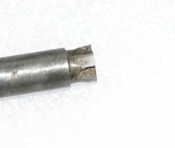

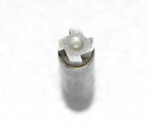

                    Here are a couple of pictures of the one I made when I made mine many moons ago. Its made from 3/8" drill rod (silver steel). The 8 deg. angle was first cut in the lathe then the teeth were cut using a 1/4" end mill indexing around by eye. The back of the teeth were then backed off with a file to leave a land at the cutting edge of about 1/32". Hardened and tempered back to light straw.

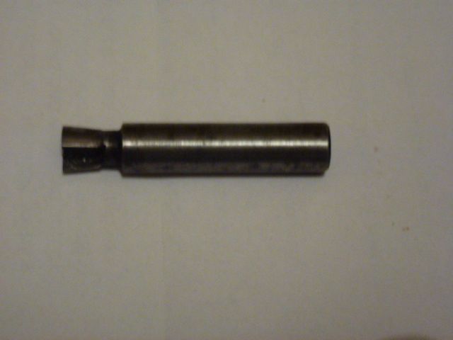

                      Here's mine. Again 3/8" dia. silver steel, as per GHT. 2 flutes, An hour or so to make.p1020873.jpg

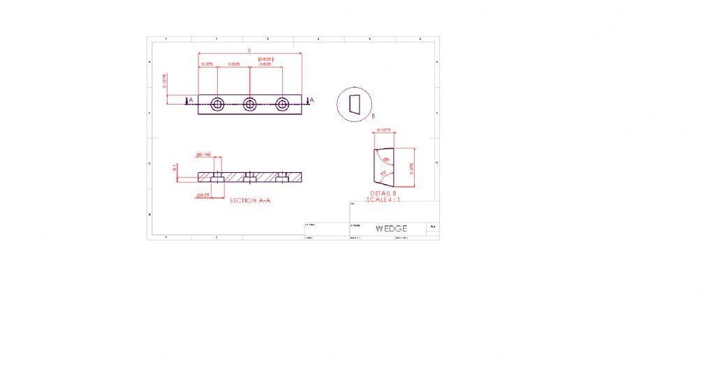

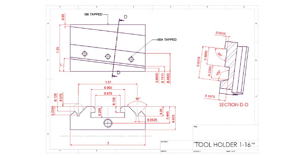

                                  I made a holder for an inserted tip parting blade that fits my QC rear toolpost on the Myford.
                                  Here it is along with my drawing if it is of any interest.
                                  I didn't bother with an angled cutter, I used a slitting saw set over at the angle I needed.
                                  As all the cutting forces are upwards, I clamped the blade using a split at the bottom.
                                  Phil

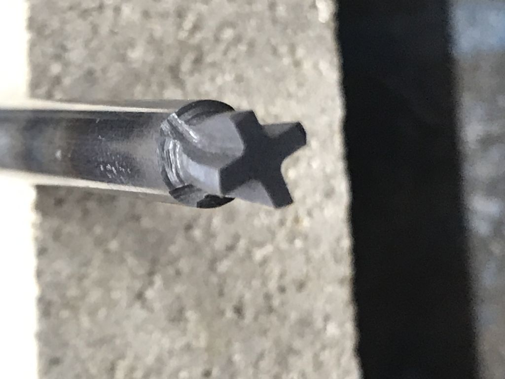

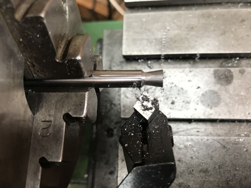

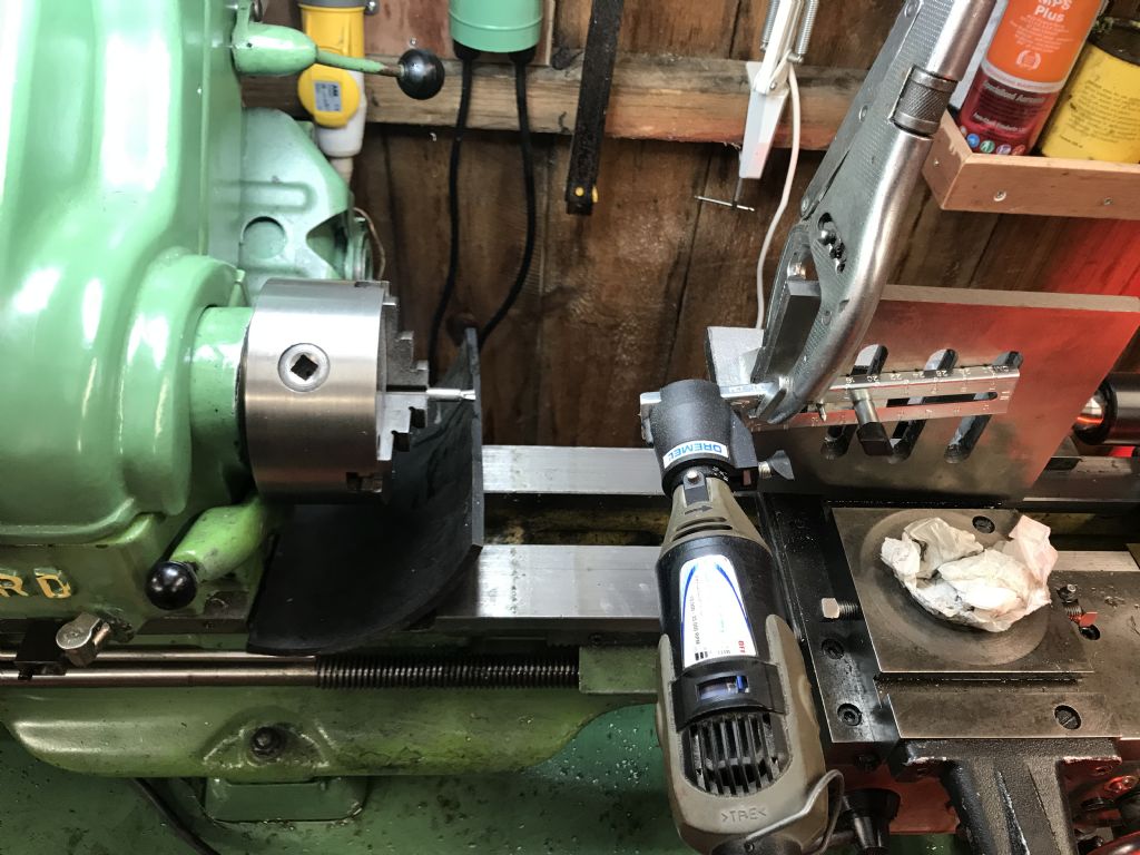

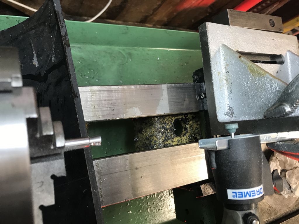

                                      Thanks to all the encouragement & pointers from the collective, I decided to "have a go", after all, the point of the exercise is to improve my skills & knowledge & hopefully produce something useful in the process. I worked with what I had & hopefully produced a workable result, time will tell.

                                        Looking good. Before heat treating are you going to relieve the centre like John above has done?

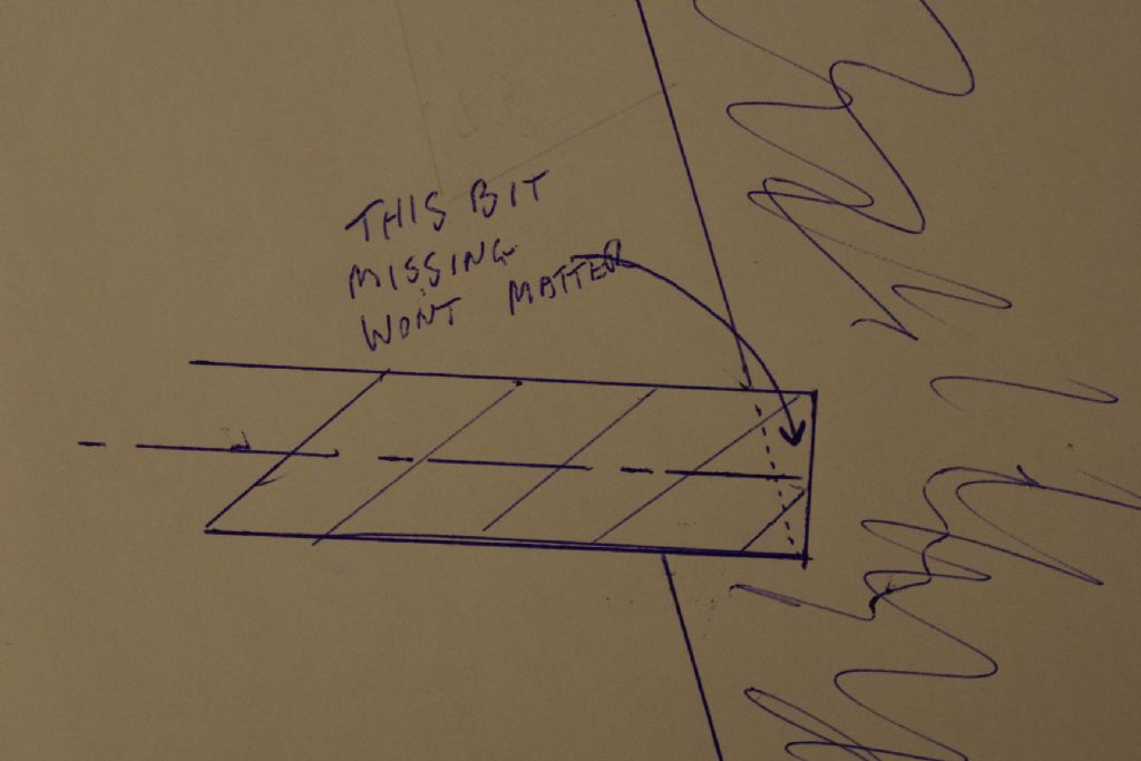

                                              Ok, with just the lathe you must have been doing some milling to get this far.
                                              Think about tilting the work to the 8 degrees and then using a small cutter, say about 3mm diameter. It will leave an indentation, but that will not affect the way the clamping works at all.
                                              Look closely at Phil P's second picture.

                                                When I made mine it was made on the lathe only before I had the luxury of a mill. The flutes were cut using a 1/4" milling cutter in the chuck and holding the embryo cutter in the tool post. The centre was relieved using an form tool ground on the end of a tool bit plunged into the end. The relief allows the cutter to cut more freely without rubbing in the centre.

                                                  Just for completeness here is the information on my other parting tool holder that takes a conventional HSS blade which is retained with a wedge.
                                                  These have given trouble free service for a few years now.
                                                  Phil
