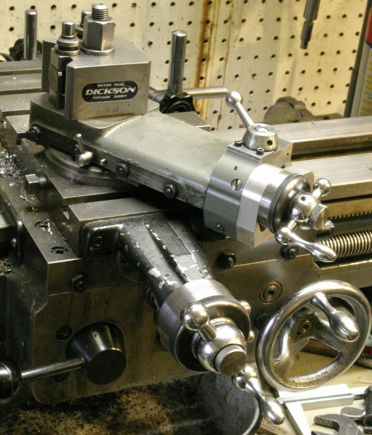

      Just finished 'the' GH Thomas S7 topslide improvements – pinning the gib and adding a little thumb-operated topslide lock. These seem useful, and good motivation to generally strip, clean and pander to the assembly.

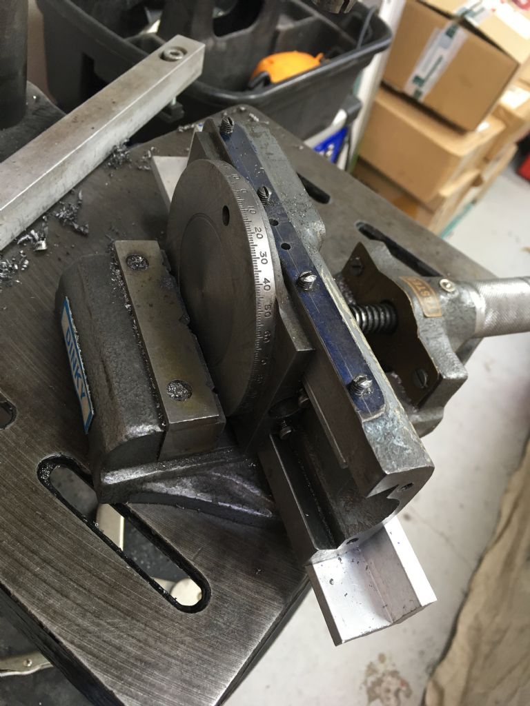

      I actually bought a complete, 'ugly' S7 topslide from the Bay of Fleas a couple of years ago, intending to try this out without affecting my original. This was prescient, as I promptly broke the original base casting and swapped it out for the newly-acquired. The tapered stub had evidently been cracked by a bit of excess 'nipping' while the left and right pressure pads had been reversed, causing the tips to dig in and induce the crack. But the topslide itself had been sitting in a drawer since.
      But nothing is thrown out around here, and that broken base became the answer to clamping the topslide while drilling for the gib pin, after the broken stub was machined-off – this is the bit where GHT talks obliquely about 'clamping it as best as you can'.

      The only other thing I varied from the GHT instruction was that rather than fiddle with the screw to work out where to position the thumb turn, I simply fixed it in place before trying it. I then filed down the finished tip to get it in order. The thread pitch of 2BA is about 32 thou in old money, so it wont be much – but do ensure that the leading tip is a 'full' 1/8" at the kickoff.

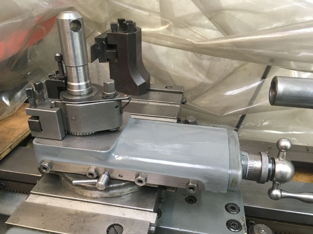

      That ugly topslide was then cosmetically improved by rebuilding the corner collision marks with J-B Weld. And a layer smeared on the mounting surface, before being 'just' faced off with a flycutter and painted with Paragon enamel. Finally, new gibscrews added and the whole assembled on the bench.
      The other thing I tried is the thin white line you might see between the end plate and the screw index dial. I added two PTFE wafers, cut from 0.5mm sheet with wad punches. I have previously ripped thicker washers from a piece of bar, but they seemed a bit clunky.
      Anyway, now done. And it all feels jolly nice to use.

                      Any loading will be unidirectional with the topslide set normally, right? So we only need to consider each of the wafers, which are respectively about 20 thou of an inch with a surface area of about 0.4 sq inch.
                      I have not sought to calculate the axial load on the cutting tool, which will be transmitted directly through the wafer. But at that thickness (thinness?) and load area, it does not seem to me that it would be going very far? I certainly see this stuff being used for high-load applications, albeit that I am using what I assume to be a virgin PTFE.
                      But other thoughts are welcome….?
