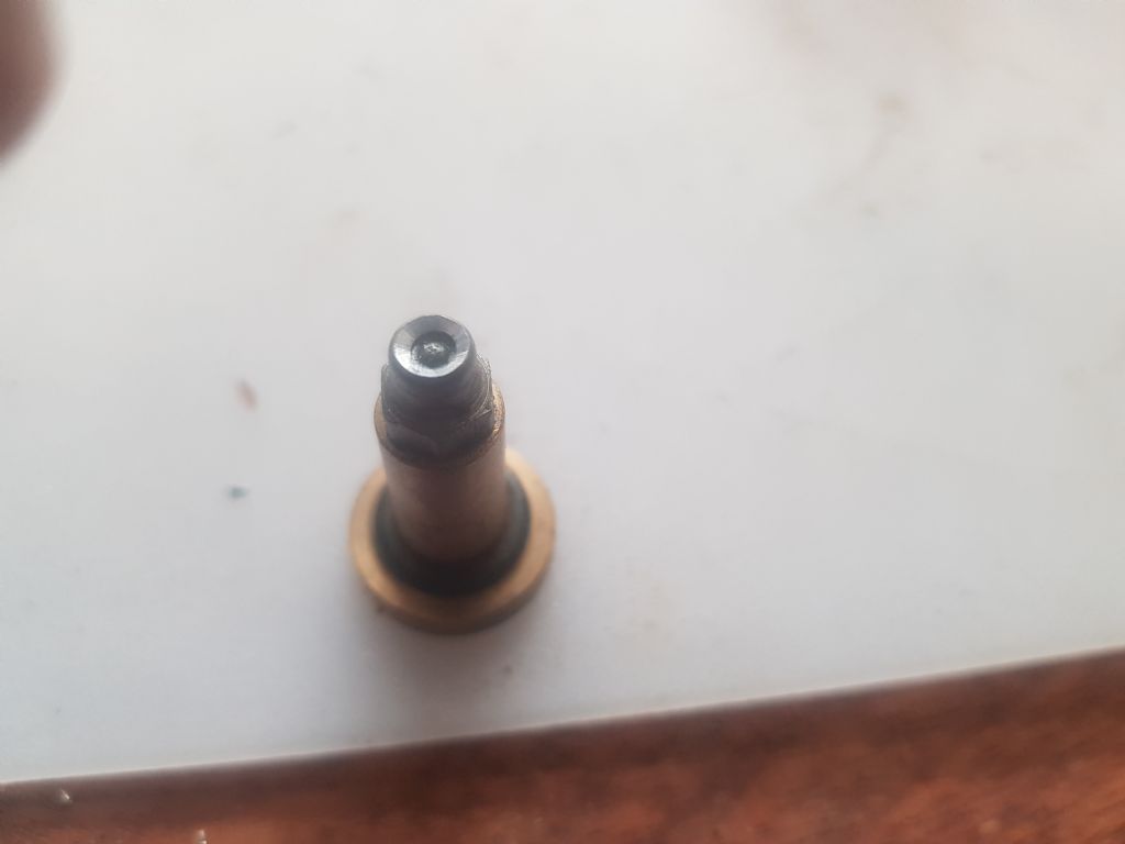

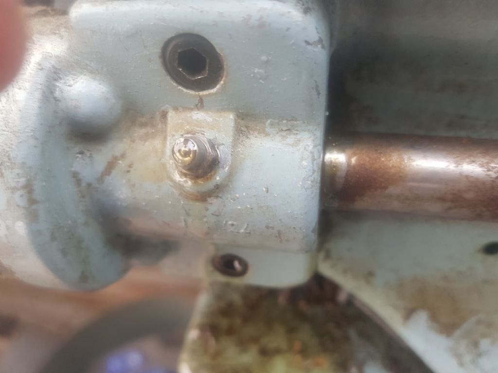

        Now as you have all been on the edge of your seats on tenterhooks, here is the denouement
        As you can see, I placed the obdurate grease nipple in a holder and drilled out a countersink to suit – a new 11/64"
        The nipple was reinstalled (2BA) and given a pump and the oil duly emerged from the shaft as expected, only a trivial amount leaked from the gun point
        So there is my take on a nasty problem and the grease nipple will no doubt seal on a grease gun
        Ive had a few good tips from this board so its good to return – my oil gun tip

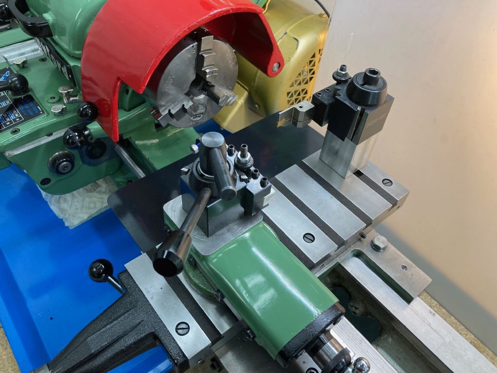

          Sub Wooer
            @subwooer63862
            Well said William.

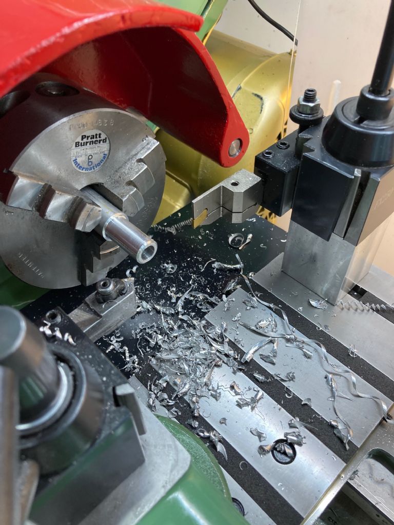

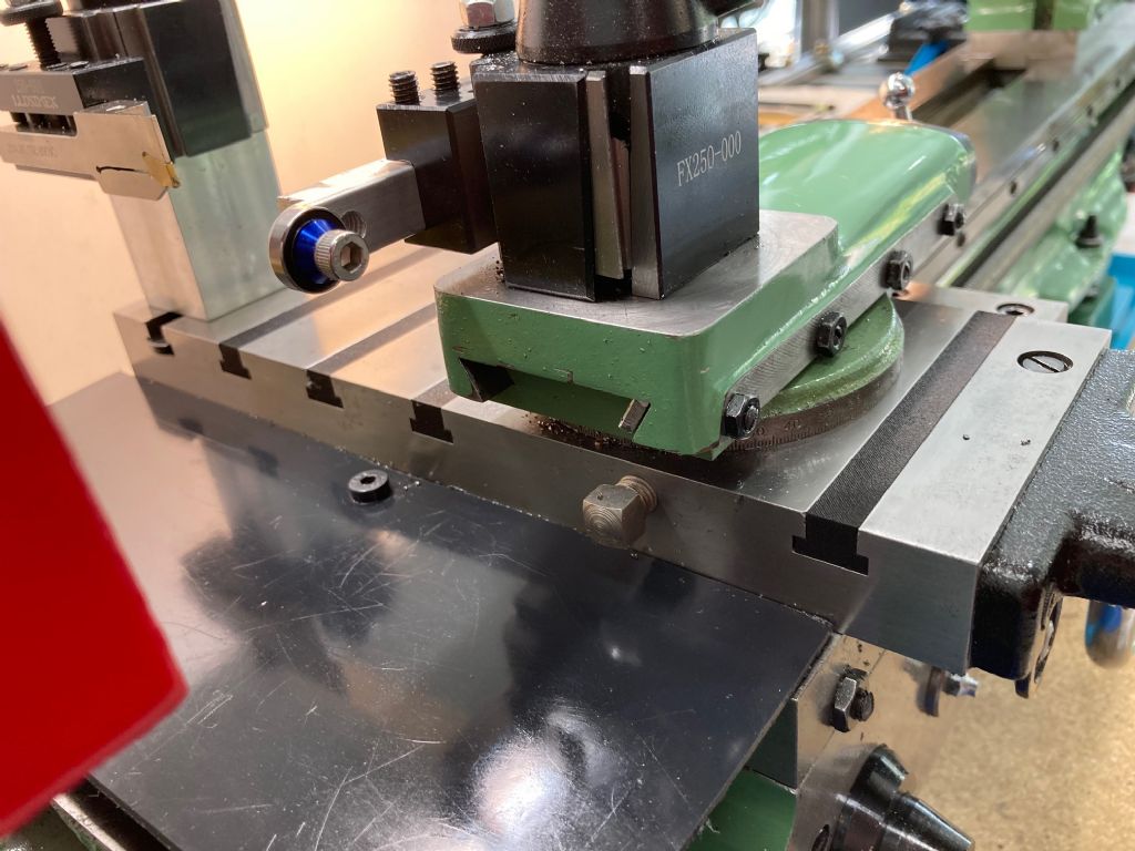

            Peter, dont you worry bits of fabric over time will accumulate and clog the oillite bushings?
            Brian, I use a bit of ABS plastic to cover my ways, and secure it with a single bolt. It keeps all swarf far away from the felt so a simple ways clean off to the left is all thats needed (when working with the slide back enough to expose the ways, which isnt often in my case). I also prototyped up some t slot fillers so cleanup is a breeze.
            tslot1tslot2
            swarf
            Edited By Sub Wooer on 17/08/2021 22:42:20
            #558744
            brian jones 11
              @brianjones11
              Wow i could eat my lunch off that m/c, why am I such a slut?
              Those slot fillers are neat, Now Auntie Doreen is up to speed, I could mill out some strips in a heartbeat
              Great tip thnxsmiley
