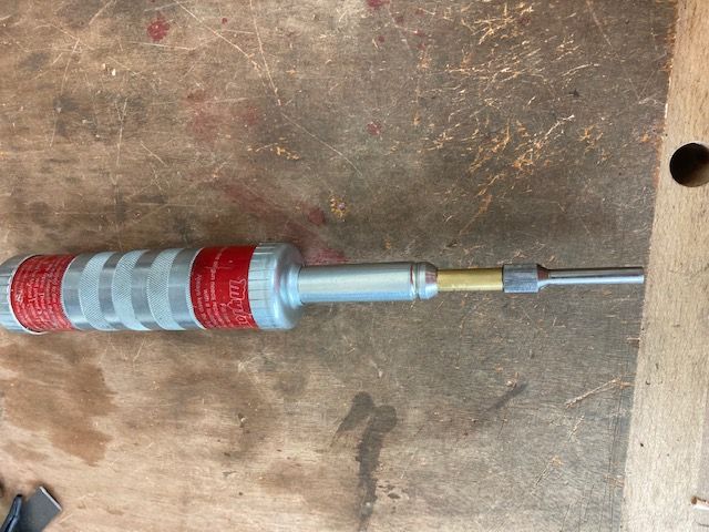

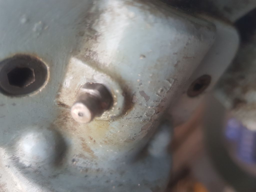

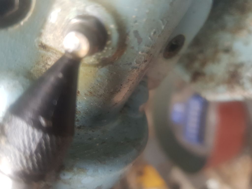

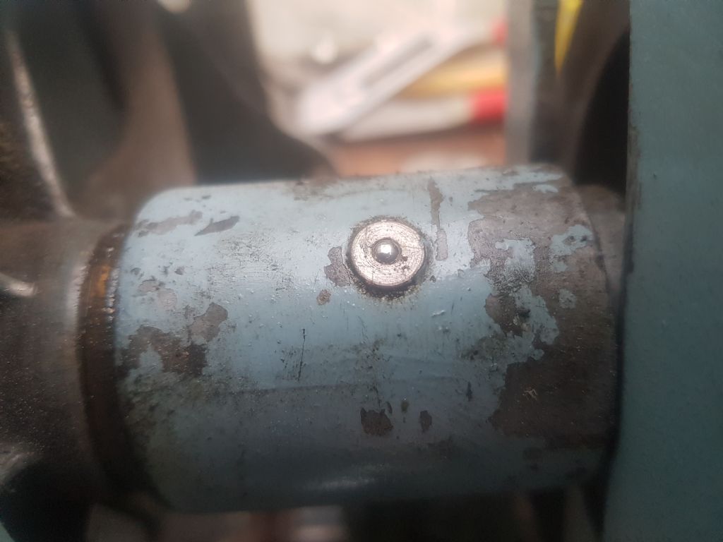

                Perhaps those wise owls will tell me how the Wanner oil gun is supposed to work here (it most certainly doesnt)
                it bit blurred cos i struggled to hold camera and gun, but i think the scale is clear
                and the gun does not make proper mating with the flat top nipple, unlike the press fit lay shaft nipples
                note these nipples are the parallel shank type not the later hydraulic type with a bulbous nose typical for grease guns
                I wondered if anyone had made an adapter between the Wanner and this type of nipple
                I did get a spare grease gun head with a view to creating such a widget but I thought I might ask here first

                  Brian I have a Wanner oil gun that came with my S7 and it as a different end which does fit over the nipples

                    Picture of a Wanner with the right end on the Myford Website
                    #557688
                    Martin Kyte
                      @martinkyte99762
                      Hi Brian
                      This is the correct oil gun
                      and this is the end
                      and this is how it fits
                      so the predictable response is that you got correct information
                      regards Martin

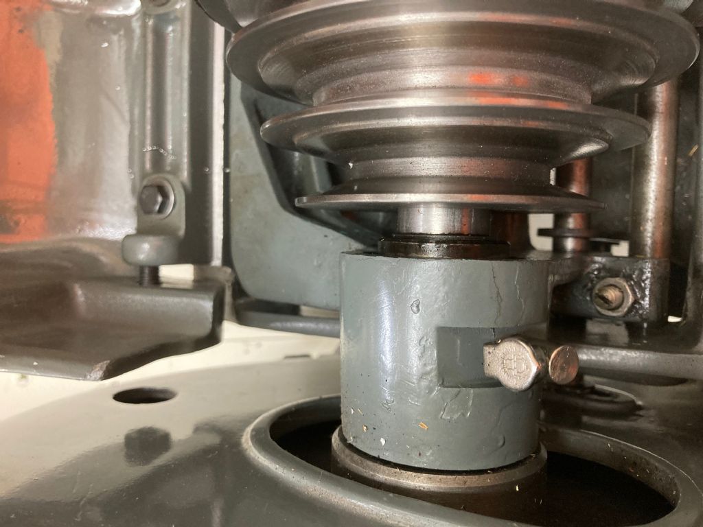

                        20210809_190001_001.jpgWell guys tell me how that will work on the layshaft bearings which have a 1/4" press fit spring ball type that is flat and flush fitting, which my conical guns works ok.

                          If you read the link I posted you will see that that type of gun is for the 2 BA nipples, other types of oiling points will need other tools.
                          #557693
                          Pete Rimmer
                            @peterimmer30576
                            Posted by brian jones 11 on 09/08/2021 18:40:23:
                            The answer is pretty obvious you need different ends to fit the different fittings.

                              Well thats pretty Myford for you then, an oil gun that works for one set of nipples but not for the rest. Why didnt they use the same nipples throughout? Some small boy apprentice's handiwork here
                              But I have a cunning plan and you can spot the answer from the photos I posted

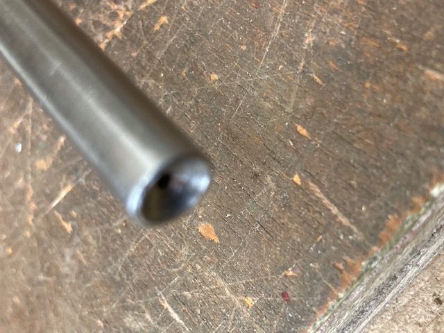

                                The gun I have is for the original flush press fit nipples as I have shown. I cant remember where I sourced the gun 10 years ago but it was specific for this type of nipple and presumably what Myford would have supplied cos how else do you charge this type of nipple
                                OBTW I can tell you that the gun nozzle fits accurately into the nipple hole, making a tight metal seal.  See how the hole is larger than a grease nipple hole, which is why the oil gun cant work on these

                                    The Myford oil gun is not a pleasant design to use. Still have it but laid it aside after using it ones and bought another new one at the local supplier. Niko.

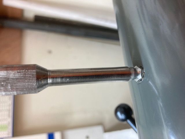

                                      Hi,When I got my ML7 ,I got an old oil gun from a steam rally for a couple of quid ,it did not fit the nipples on the ML7.
                                      Then I used the ML7 to make a new end for the oil gun ,this fitted the nipples.
                                      Job done easy, ML7 oiled.
                                      Maurice

                                        This is my Super 7 Layshaft. It has oil cups which get filled with a Reiling oil can.
                                        Maybe someone would tell you what the original fittings were on an ML7 layshaft.

                                          Lathes.co.uk show flat top oil nipples on their ML7 shown in the link.
                                          **LINK**
                                          Could it be that your fittings are non standard maybe?
                                          regards Martin

                                              Like Martin has illuded too above could your ''original'' flush mount oilers be a previous owners ''upgrade'' I can not find another ML7 on the web with flush mount oilers there (apart from Steve Jordan on Youtube and he is a well known ML7 ''pimper outer'&#39
                                              My 1974 Super 7 has late type screw in fittings all round (apart form the 3 oil cups), my quite early ML7 has the early type of again, screw in nipples. Maybe try digging the flush mount oilers out, and seeing if there is the remnants of a thread in in there?
                                              Does having 2 of the same gun with different ends push the boat out to far, they are after all 2 different types of bearings so really require 2 different grades of oil(slideway/linear, rotary), which might be what the person who possibly changed them out in the first place thought, Low and behold it could well of been that ''small boy apprentice'', using his ''little'' noggin.

                                                The two Myfords I have access to both have flush oilers on the countershaft and the type shown in the photos above everywhere else.
                                                I have no reason to think they aren't original.

                                                  Thanx GC, you can see the kind of FES I am up against. I too believe my press fit flush oilers are original 1952 and that they were changed to a screw in 2ba hydraulic type later
                                                  Without the original Wanner telescopic gun with conical tip it would be very difficult to inject oil
                                                  As I said at the beginning I have come to believe that Holy Mother Myford rather overlooked the need for routine lubrication in the early days – this is Lese Majeste and as with those fire fighting aircraft I shall be bombed with liquid ordure
                                                  Notwithstanding, I am proceeding with a cunning plan

                                                    Dunno much about fymords, but I might expect two types of fittings at least. Low and high pressure. Then, there may be some grease and the rest oil. In fact, apparently there are some ‘no pressure’ fittings as well – the capillary/drip oilers and squirting oil on the ways. Nothing particularly difficult or arduous, but a necessary routine when in use.
                                                    If the machine has been fitted with the wrong type of lubricating fittings, at some time, it should be easy (and perhaps sensible) to remove the wrong ones and fit the correct items. I’m quite sure they would all be available from The Nipple Shop, which is where I have had good service in the past.
                                                    Think here that low pressure will likely be press-fit and high pressure will be screw-fit. I have oiled all the spring ball type with a pump-type Wesco oil can without recourse to a special high pressure oil gun.
                                                    The nozzles on most oil or grease guns can be interchanged as required, I expect. I have more grease guns and nozzles available than I will ever need. Most agricultural machines, for instance, tote the same nipple type across the whole machine, even though some nipples may be harder to access than others.
