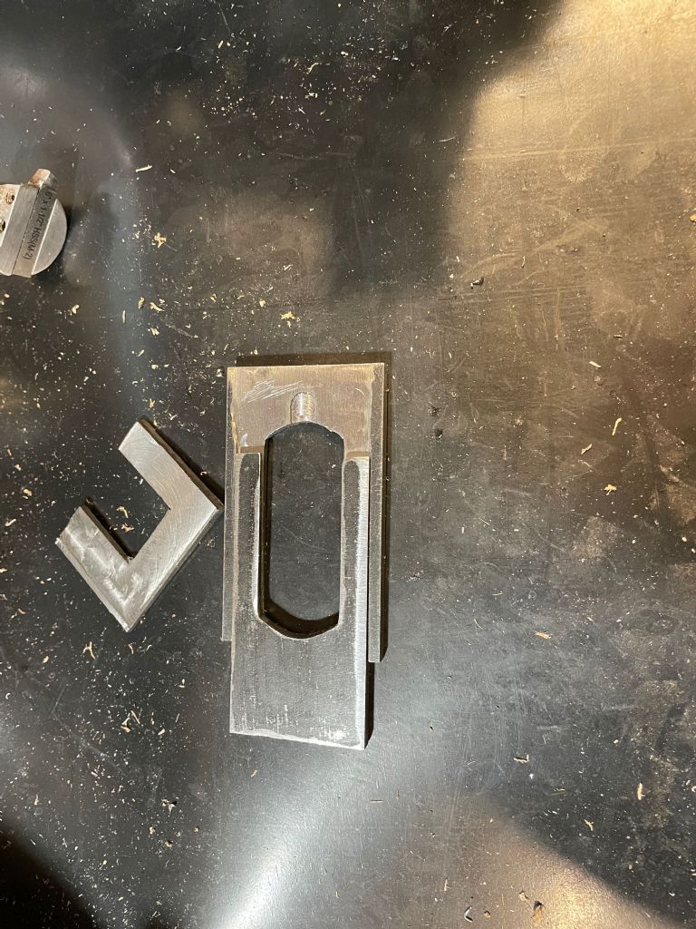

                I thought I'd finish off the story with a successful solution to the sticky MT3 tapers. I made up a pair of opposing wedges to fit round the shaft, between spindle and tool. The combined angle is about 7 degrees . I made up a further U spacer to suit the particular gap with my RM25 collet holder. A gentle tap between two light hammers releases the taper every time with no trauma to any bearings – brilliant. Leaving the drawbar in place avoids the tool falling out
