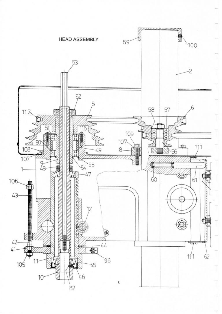

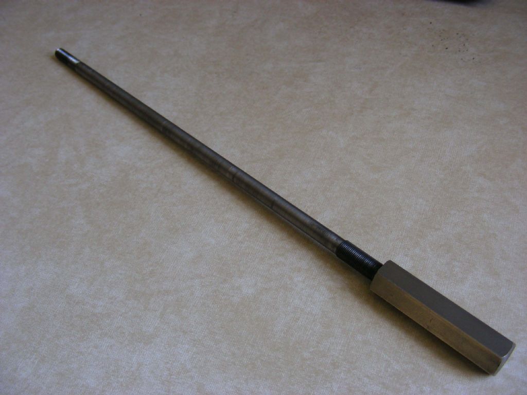

                                    I used to tap the drawbar on my mill/drill until I became aware of an easy way to make a self-extracting arrangement. Here is the quill complete with standard drawbar:
                                    And here is the new drawbar modified by the addition of a fine thread under the hex head:
                                    The spindle within the quill is, of course, tapped to suit.
                                    In use the taper tool is screwed on to the lower drawbar thread and when it contacts the female taper it is nipped up by hand via the drawbar hex. To release, the hex is undone by about a quarter turn and the differential pitch between the two threads causes the taper to release.
                                    So far as I can tell, the bearings are not involved in this action.
                                    Tooling with a tang rather than a thread is extracted via the slot in the quill.
