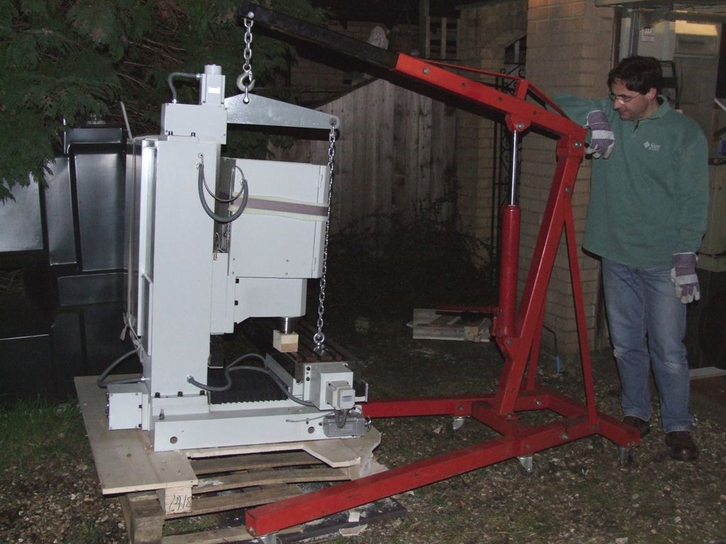

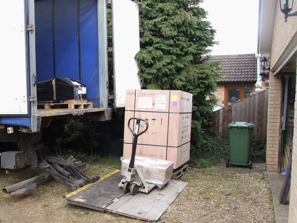

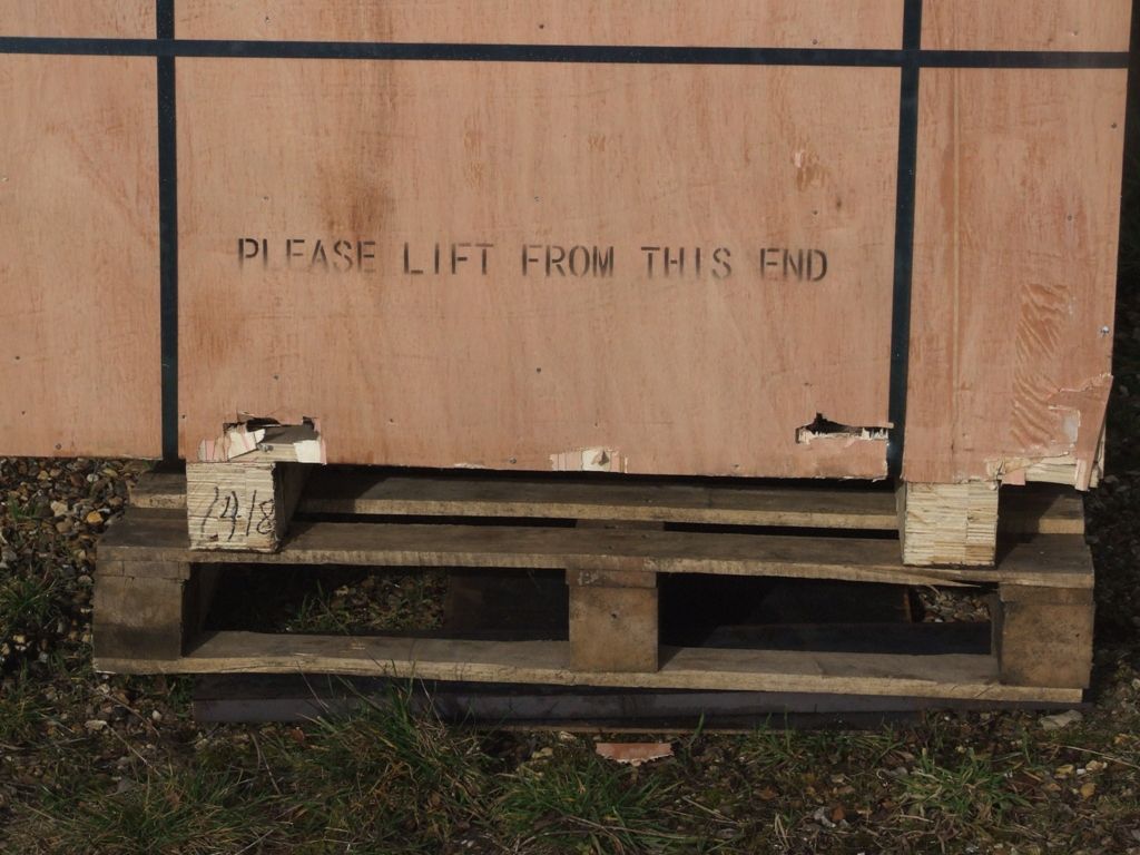

          You're not alone! My Tormach came on a pallet:
          In hindsight it would have been better to ask the delivery driver to drop off the back of the lorry on the opposite side to that shown. At some point during shipping a forklift driver had a wobbly:
          Fortunately no damage done inside. It was a right royal PITA getting the mill out of the crate and off the pallet. We had to do a lot of sawing and then a 2 ton engine crane on it's longest extension (500kg) just reached:

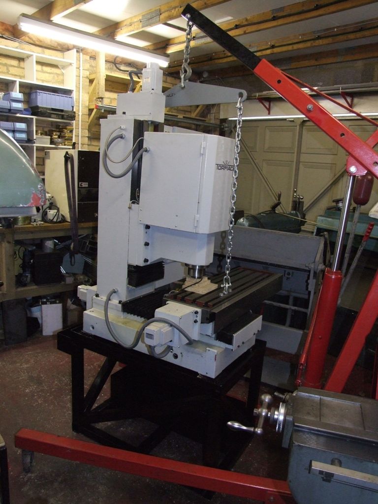

          Along with the mill I bought the Tormach lifting bar and chains. I figured that if I dropped the mill with some home bodged arrangement I'd be on my own regarding warranty. So better to use the official gear. Later the engine crane just had enough height to lift the mill onto my homemade stand:
          I didn't buy the Tormach stand as it was a price too far, wouldn't fit in the space available and back in 2009 they only did 110V versions. Not much use in the UK.
          Andrew

              Is that chain going into the T-slot? Doe sit have a long T to spread the load. Anyway interesting they confirm it is strong enough to take half the machine weight.
                I had to go and have a look. The T-nut is about 2" long with a tapped hole for a lifting eye. If I recall correctly the T-nut was quite a snug fit in the slot. But the mill isn't that heavy, about 500kg.

                  David: The engine crane isn't mine, it was borrowed from a friend. Afterwards I broke up the pallet and case and recycled the wood and nails. Getting it across the gravel was a PITA. We had to swing it between the legs of the engine crane put it down and then move the crane a few inches at a time. That's why it would have been better to have had it dropped off the other side of the lorry. In the first picture bottom right there are some large hot rolled steel flats propped up. They were used to roll an 18" shaper out of the garage so we could get the mill in. We certainly deserved a beer by the time we finished.
