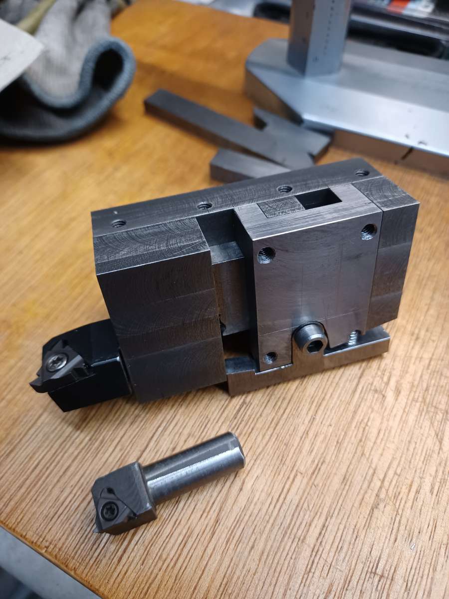

                                David George 1
                                  @davidgeorge1
                                  I have made a version of GHT screw cutting tool holder The drawings are free to anyone that may wish to see or use. Although my one is used on an Drummond /Myford M type lathe it wouldn’t need much alteration to fit on any lathe as the operating ramp would need to fit to the lathe you have.

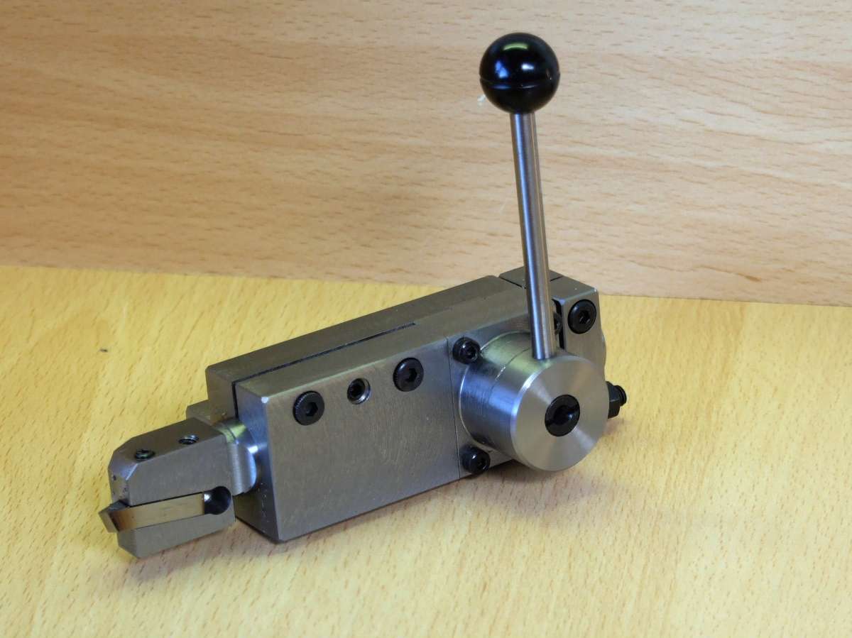

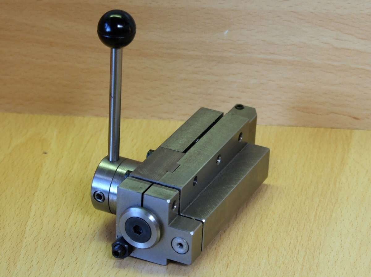

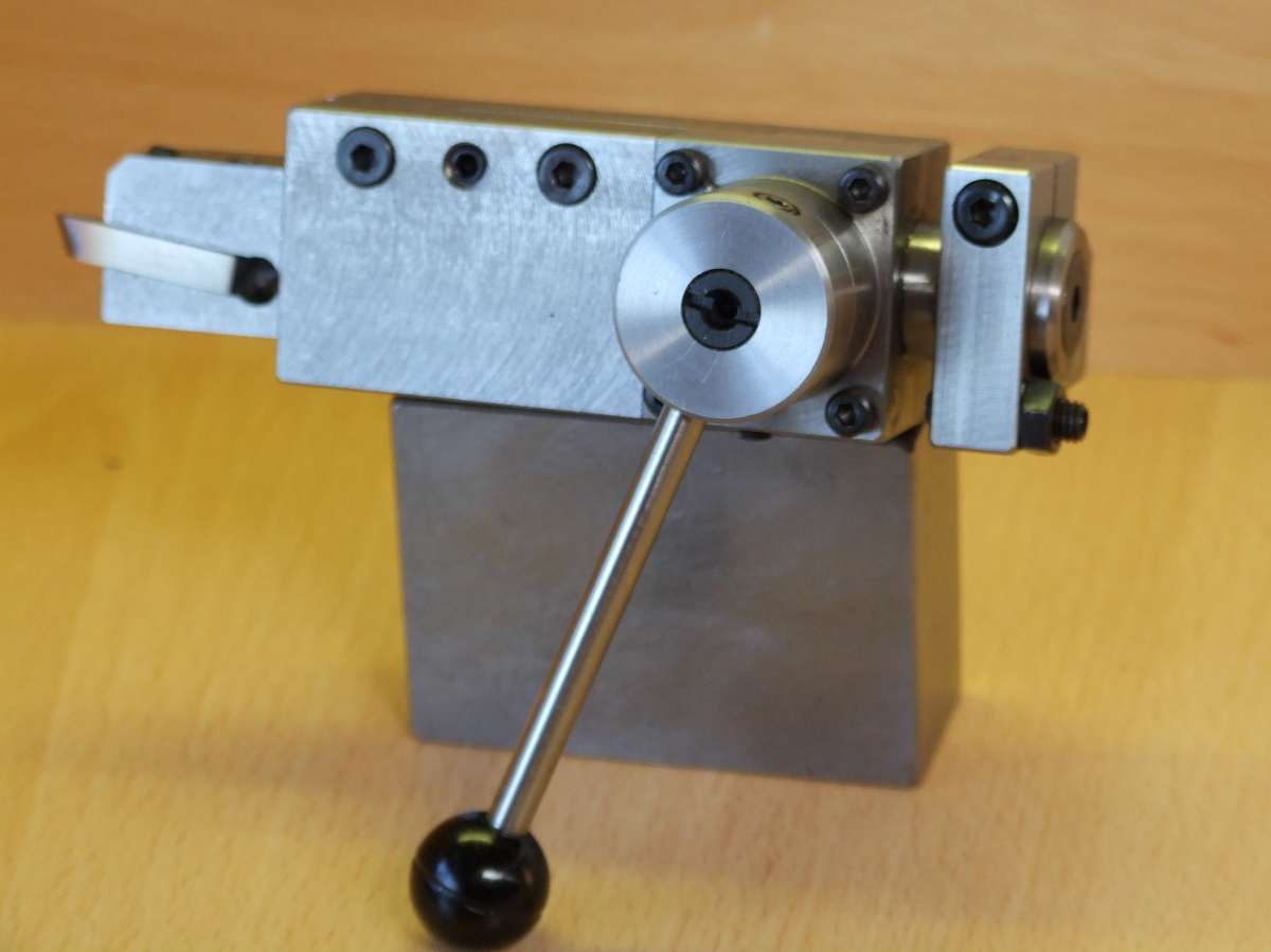

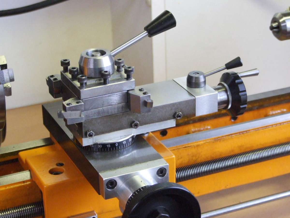

                                      On Greensands Said:
                                      Could I request someone to post some photos of the Graham Meek retracting top slide tool holder on this thread. Thanking you in advance.
                                      Please find attached the photographs that you asked for,
                                      Fig1 Retracting toolholder fully forward
                                      Fig3 Rear view of toolholder
                                      Fig4 Showing full retraction of slider
                                      One advantage this device has over GHT’s design, (I have made this so I know), and that is it moves the operating handle nearer the operator and away from the vicinity of the revolving Chuck.
                                      By far the best is the Retracting Topslide. This takes standard tooling and can be used to do external and internal screwcutting without requiring another toolholder. They will of course fit any lathe,
                                      Fully Forward Photo 6
                                      Regards
                                      Gray,

                                              Apologies for further topic drift but can someone enlighten me as to why retracting slide conversions for Model Engineer type lathes always seem to be applied to the top-slide.
                                              Industrial lathe practice is to have retracting device, where fitted, on the cross-slide. My Pratt & Whitney B, like some other machines, has a concentric quick thread in the dial carrier assembly. Lever operated cam devices are also used. I can see no special advantage to a top-slide fitting and one or two disadvantages.
                                              On purchasing The Model Engineers Workshop Manual I was most impressed by both the retracting tool holder and the retracting slide devices and resolved to build something to use on my SouthBend lathe a soon as a suitable “Round-tu-It” could be captured. In the interim I decided to adopt Georges “star turners” angular in-feed method of putting the cut on with the top-slide whilst using the cross slide for tool retraction and repositioning. Using the lathe dials to calculate the actual infeed needed to achieve a thread to book dimensions being an attractive piece of low cunning.
                                              Made even more alluring when I realised it made derivation of feed changes needed to rectify any errors should the fit prove inadequate almost trivially easy. That the SouthBend (and Boxford) style cross-slide stop set up is pretty much ideal for this employment of the cross-slide was a significant contribution to this decision.
                                              It all worked well enough that making specific retraction device seemed a rather a waste of time. As with most folk my list of jobs outpaced the time available to do them more years ago than I care to admit so any pruning was welcome.
                                              When a Smart & Brown 1024 replaced the last (of 3) SouthBends I stuck with the method but, as the 1024 both lacks a cross slide stop and any sensible way of fitting one, I had to adjust things slightly. My practice now is to make the cuts with cross-slide dial on zero and arrange the initial setting of the top-slide dial such that it will also read zero for the final cut. Muscle memory handles the half turn (ish) needed for slide retraction just fine. Reading the dial for re-setting isn’t quite as quick as returning to a stop but there isn’t much in it. The 1024 has nice big dials.
                                              Indeed I’m so used to the simple read the dial at zero variant that I rarely bother to employ either the built in slide retraction device or bi-directional cross slide stops built into the P&W.
                                              Clive

                                                    The superb Hardinge HLV lathe I worked on featured a retracting top slide, although definitely an industrial machine it is on the smaller end of such things and the GHT slide I fitted to my Myford super 7 I’m sure was ‘inspired’ by the Hardinge.
                                                    Tony
                                                    #788009
                                                    Graham Meek
                                                      @grahammeek88282
                                                      Hi Tony,
                                                      Having known GHT very well I can vouch for your assumption.
                                                      Regards
                                                      Gray,
                                                      Also it is far more convenient to add this feature to the topslide than the cross slide. Especially on the S7. Having said that one design for a retracting cross-slide has been published by Jim Schroeder for a Grizzly G0602 lathe. This lathe does have a different cross-slide arrangement to the S7. It is interesting to note that Jim also added a retracting topslide afterwards.
                                                      Regards
                                                      Gray,
