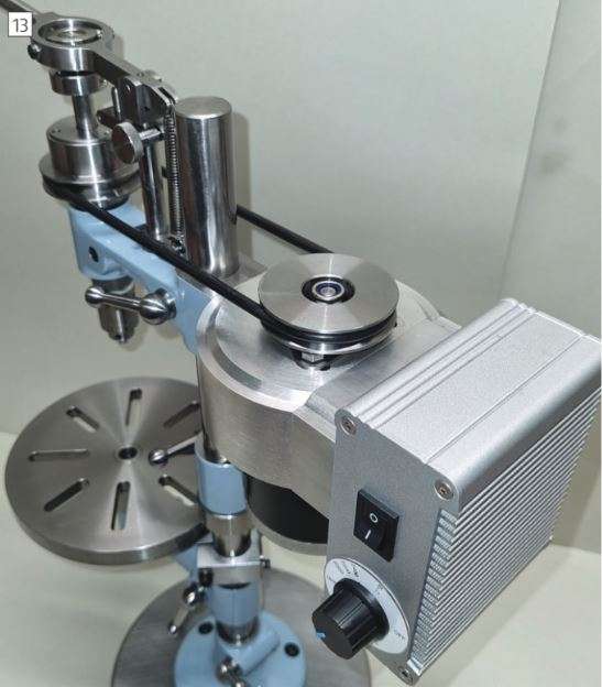

      Hi All. I have recently finished George Thomas’s high speed drilling head that fit to his tapping and staking tool kit.
      As orginally designed the motor sits on the deck (bench) behind it and is driven by a long belt, which yest I could do but it makes it a bit of a faf everytime I come to set it up.
      What I want to do is mount a motor on the drilling head as is done with a normal drilling machine, mmaking it simpler to use.
      My problem is sourcing a suitable motor, the parvalux motor I have would be fine if mounted on the bench but is to big and heavy to mount on the head. I’ve looked till I’m going crosseyed on ebay and Amazon for something suitable but cannot find anything, also I’m not sure what size I would need, any advice or pointers would be very much appreciated.
      Martyn C

                                        Antony Price
                                          @antonyprice56876
                                          Hi Martyn
                                          I maybe misunderstanding what advice you are looking for, but in the March 2024 MEW, there was an article, Fifty Years of George H Thomas Universal Pillar tool Part IV  where the author,  Warren Williams,  describes an “integral  variable speed drive for the sensitive drilling attachment”  … “using a 24V DC motor … fitted to millions of electric scooters”
                                          Tony
                                          #743689
                                            pic from that article
                                            upt
                                            #743694
                                            derek hall 1
                                              @derekhall1
                                              I built the GHT sensitive drill and drive it via a small 3ph parvalux motor and small inverter.
                                              I don’t use it often but when I do the change over time is minutes.
                                              It did take a bit of careful aligning to make sure the round belt didn’t keep coming off the pullies though.
                                              I did also make the staking part as well but hardly ever use it. The tapping part of the tool though is always used and no way would I want to be without it.
