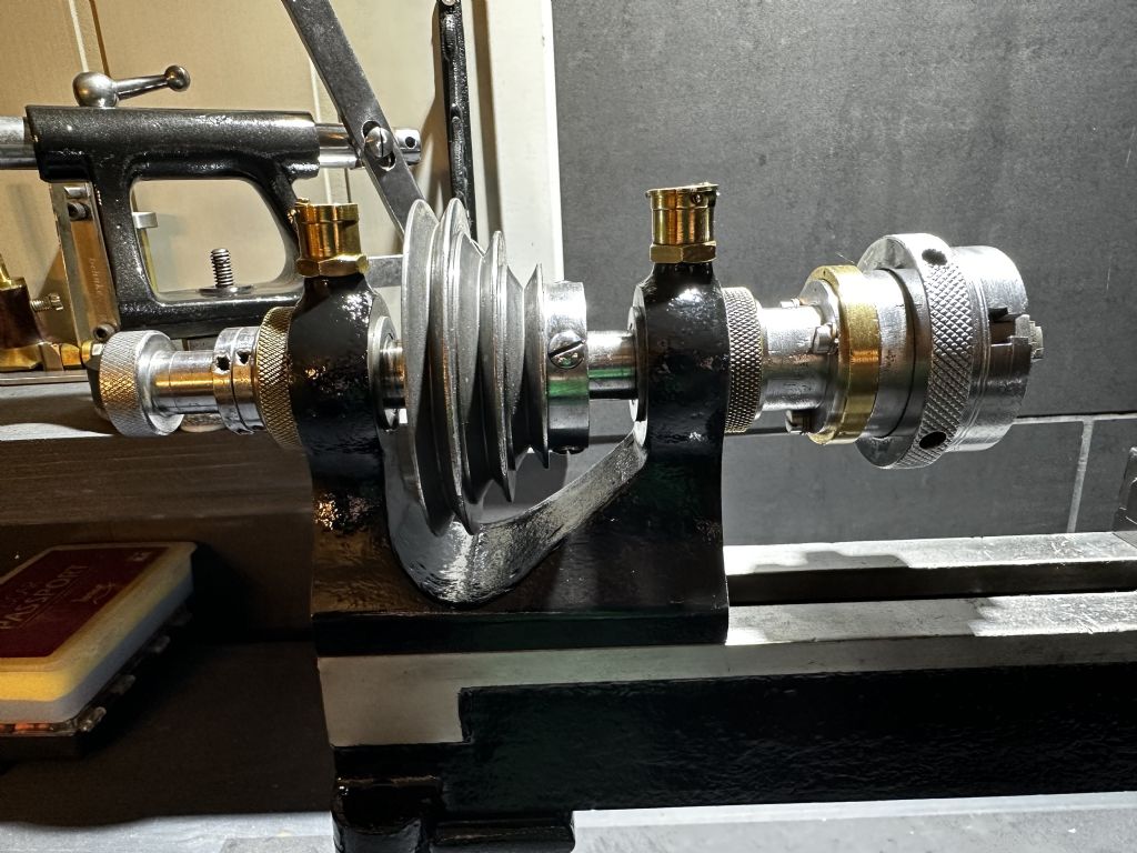

      Hi everyone.
      a couple of years ago i bought this George Adams lathe on eBay, as a had always wanted a small lathe that i could use. When i received it, it was in worse shape than i thought it would be. The whole chuck had massive wobble, and the lathe bed was in very bad shape. It also was badly rusted. So i ended up just putting it into storage.
      this year i took it out again, and decided to give it a go, and try to get this lovely little machine back into somewhat working order. And this have led me to come here. Both to ask some questions, and i suppose i wanted to show it off.
      Pulling it apart, and inspecting the headstock further, i found it to be in pretty good condition. The spindle and cone bearings all look perfect, and it has no slop in it at all. The huge wobble turned out to stem from a bent backplate on the chuck itself. Which leads me to my first question:

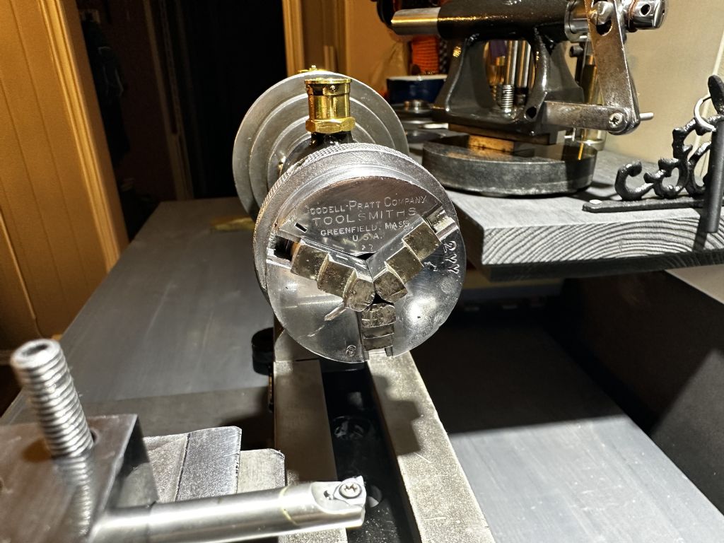

      this backplate, are these custom made by craftsmen back in the days, or are they possible to buy somewhere? Since this machine seems to be very rare, and very little information to be found out there, i suppose finding one that would fit both this spindle and type of chuck is impossible.
      The chuck itself also seems to be one of those things that just dont exist in the world anymore. Which leads me to my 2nd question:
      The chuck reads Goodell Pratt Company. I have not been able to find much information about this specific chuck, at all really. But my chuck jaws are completely worn out. It wont hold anything, as it just clamps down at the very back of the jaws. Is it possible to find new jaws that would fit this chuck? If not, i need to try and re grind them.
      on the headstock, it has these beautiful brass oil cups. But one of them has at some point had the lid broken off. I have searched everywhere i could, but finding a replacement has so far been futile. Any tips on this would be greatly appreciated.
      I am sure i have many more questions, but these are what i could remember when i tried to write this post.
      i havent done anything with the bed itself yet, other than remove the surface rust that it had. But i plan to find someone who can re grind it for me. I also need to make a new “nut” for one of the lead screws in the cross slide, as the threads are badly worn.

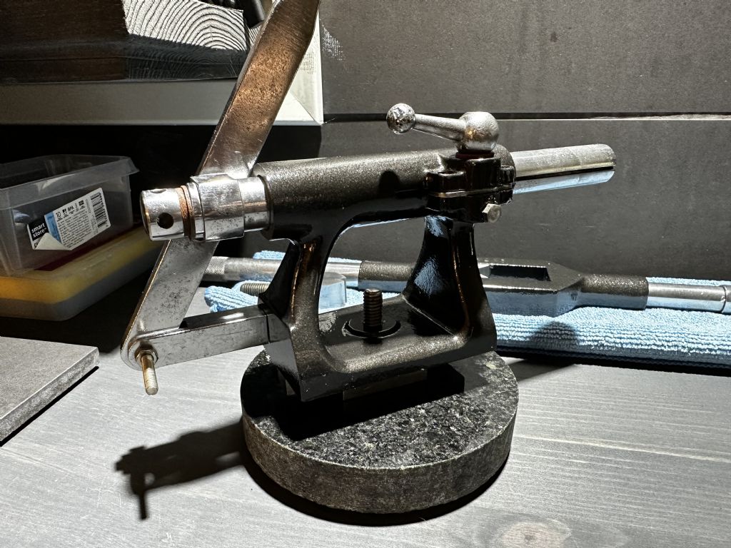

      and yes, i know i have painted the lever tail stock in a different paint. I just wanted to try something else, as i am not completely satisfied with the black colour that i have used on the rest of the machine.

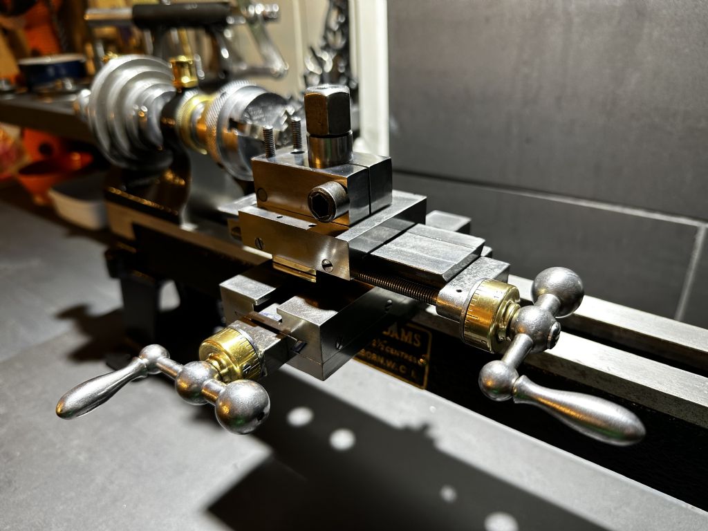

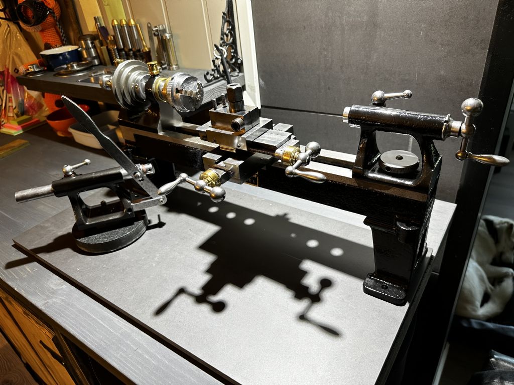

            Here are the photos of mine:
            #655081
            James Jenkins 1
              @jamesjenkins1
              That looks a smart lathe from here. Although you cannot really tell from photos, the bed doesn't look in bad condition. Have you taken any readings from it? Using a micrometer or a jig and test indicator?
              Plain lathes don't get quite the wear that a screw cutting lathes do on the bed.
              Do you have a straight edge? You can get a feel for major wear using a straight edge and a 1 thou shim.
              Obviously you would need a surface plate to assess properly or scrape – but these can be purchased reasonably from ebay, but condiiton is everything. I have a new inspection grade one that I know is right and then a couple of smaller ones from ebay for layout and workshop use.
              But as I say the lathe looks a good starting place to me.
              James

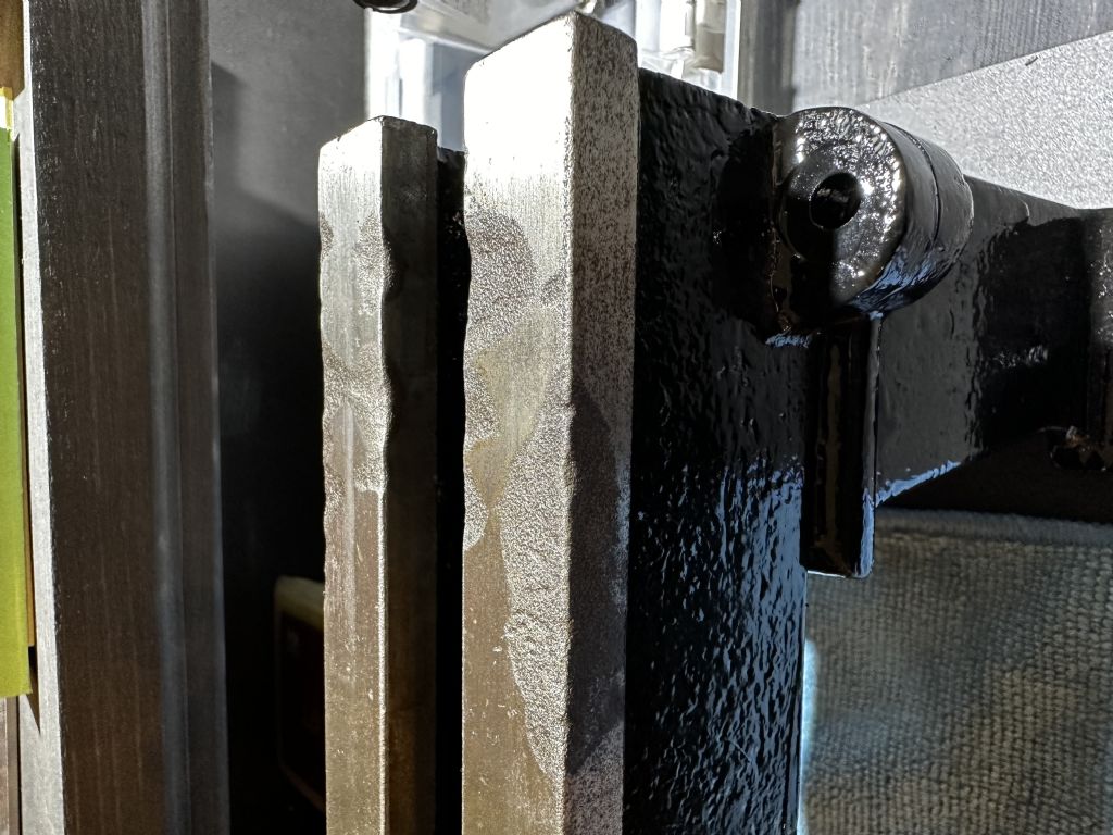

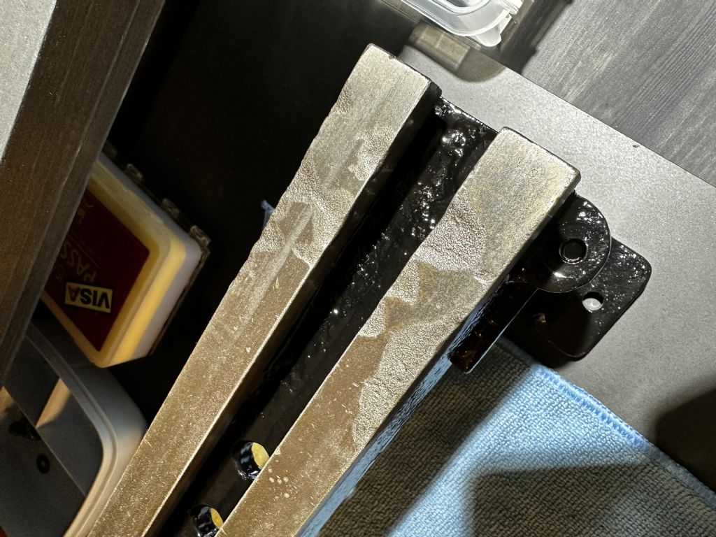

                The worst of it you cant see, as it is under the tail stock. But it has very large, and quite deep pit rust there. So the tailstock is basically just resting on the high spots. But no, i havent really measured it. I am pretty new to all of this, but i have invested an immense amount of time into the rest of this lathe, to restore it into what it is now
                #655124
                James Jenkins 1
                  @jamesjenkins1
                  Posted by Simon Rundsvoll on 03/08/2023 20:44:19:
                  As I say it looks amazing – huge congratulations on that.
                  Sounds like the next steps are to get it working as well as it looks. Try a couple of the things above (straight edge, micrometer) and see how far out the bed is – they'll give you an idea. If you look at Jan Sverre Haugjord's youtube channel you'll get lots of advice on checking a bed and then scraping it in. Rust pits aren't always a bed killer (they can be!), but so long as you have enough areas contacing the tail stock (20 ppi) some hollows won't matter.

                      Howard Lewis
                        @howardlewis46836
                        Backplates.
                        These are most unlikely to be availabe "off the shelf".
                        Recently, to enable a friend to mount a 4 jaw chuck on his small lathe, we had to make a backplate.
                        The nearest that we could get as raw material was a 100mm plate with a 26.5 mm central bore.
                        Having measured the bore, a plug was made to have a 0.00!" interference. This was fitted by the "Heat and Freeze" technique.
                        The backplate was then put into the 3 jaw chuck on a larger lathe to be bored ready to be tapped 3/4 x 10 BSW to suit the spindle on the lathe..
                        When this had been done a dummy spindle was turned and screwcut, before being finished with a die. (This entailed making a Die Holder for the 2" diameter Die! )
                        The backplate was then screwed onto this dummy spindle, tfaced and to reduce the diameter to 80 mm and to produce the register.
                        Fortunately, the backplate had been tapped M6 on the required PCD, so it was just a matter of opening up the holes to clearance, to enable chuck and backplate to be united.
                        You are going to have do somethinbg similar for your lathe. finish machining the backplate, once it has been fitted to your lathe.
                        Hopefully, the chuck will then hold work closer to true.

                            Wow – shiny. It looks like you have been polishing it on a buffing wheel. Didn't we have a thread on this lathe model a couple of months back when I mentioned I have never seen any spare parts on ebay for it. The spindle thread is unusually fine so not similar to any of the other small lathes.
                            There are loads of little chucks on ebay though so you just need to make a backplate. You need another lathe for that. Just make the threaded part initially in cast iron bar in case it doesn't come out right. Then solder on a disc and finish on you lathe to make sure it is true. Actually as the current chuck is poor why not remove it and true up the backplate in situ?
                            It is not a screwcutting lathe. Therefore the bed is only to hold bits together and you could use a bit of angle iron instead. It is completely pointless to regrind the bed. All the real work is done by the saddle/cross slide/topslide assembly.
                            It is a good lathe for clockmaking, model railways, small engineering up to G1, not just an ornamental antique except for the fact that it is so shiny.
                            Use an industrial sewing machine motor to power it; which also gives you variable speed.
                            That second tailstock is interesting – can you provide a better photo of just that please.
                            #655175
                            James Jenkins 1
                              @jamesjenkins1
                              The damage to the tailstock area is worse than I had thought. You're not going to scrape that out.
                              Whilst I agree that having a perfectly flat and aligned bed isn't essential on a plain lathe, for accurate, consistant and timely work it's nice to have. If I'm honest though I wouldn't spend the time on this bed getting it to that state.
                              I think the view that you should use the lathe and see where you go from there is good advice. You might find it does all you wan it to do, or else you'll out grow it but know what you want in the future.
                              James

                                    Machining a new one is currently out of my capabilities, as i dont have another lathe, or the necessary knowledge to do this well.
                                    but after having done some speculating, i decided to take the backplate off the chuck. And having that mounted alone in the spindle, i machined off the end, to make it level again. I did the same with both sides of the brass spacer that is fitted to the chuck.
                                    as i dont yet have a motor setup for this, i improvised a hand crank, and powered it manually! It did work, quite well actually, but it took eons to finish. And it improved the chuck wobble drastically. I didnt measure it when it was at its worst, but during the work i had to run a buy one of these measuring devices. Now i got the wobble in the chuck down to 0,03 mm. before i did this, i would estimate the wobble to be at least 2mm or so. It was huge.
                                    not being all that knowledgable, i dont know if 0,03mm is good enough. But to me it seems to be quite decent.

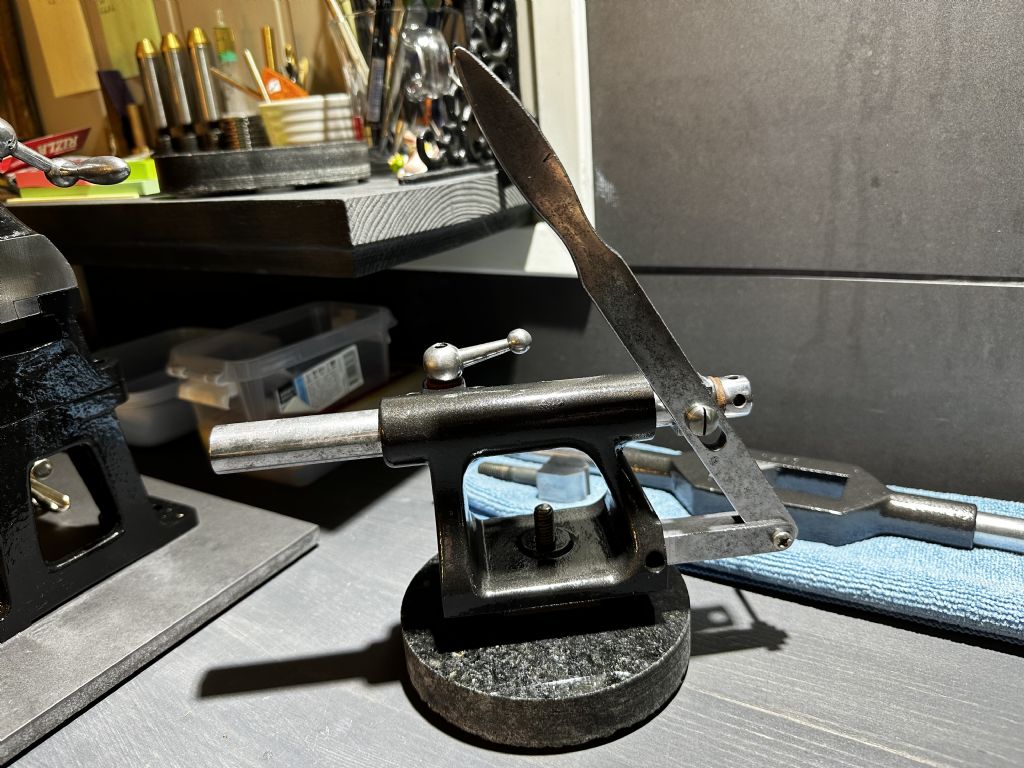

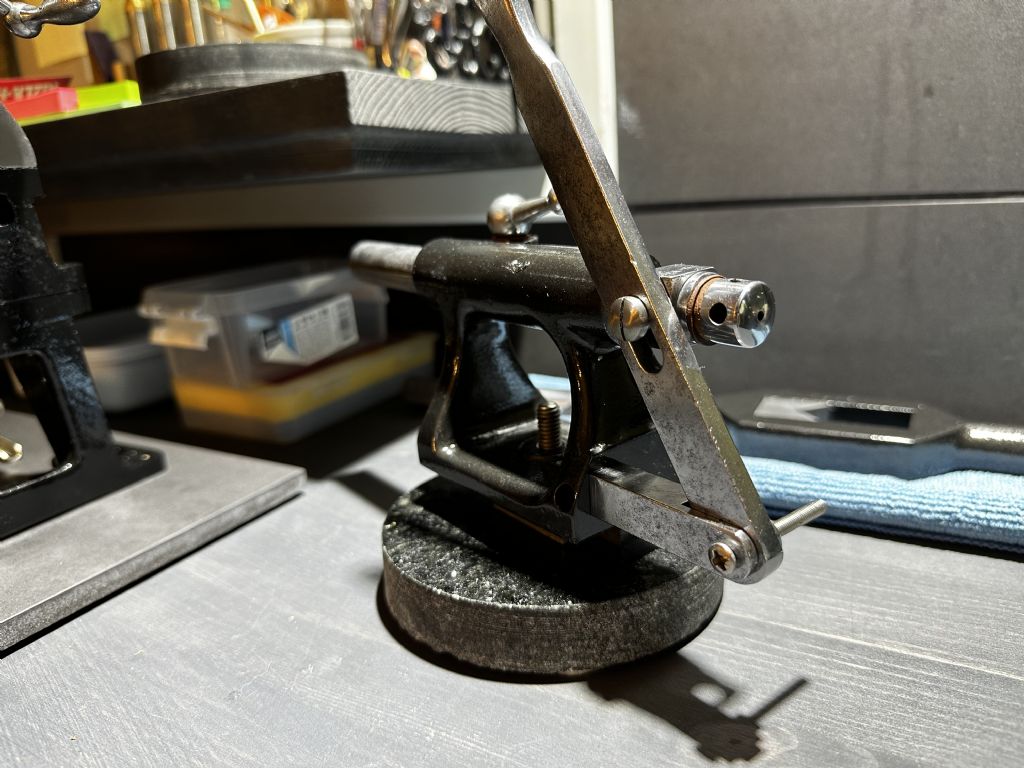

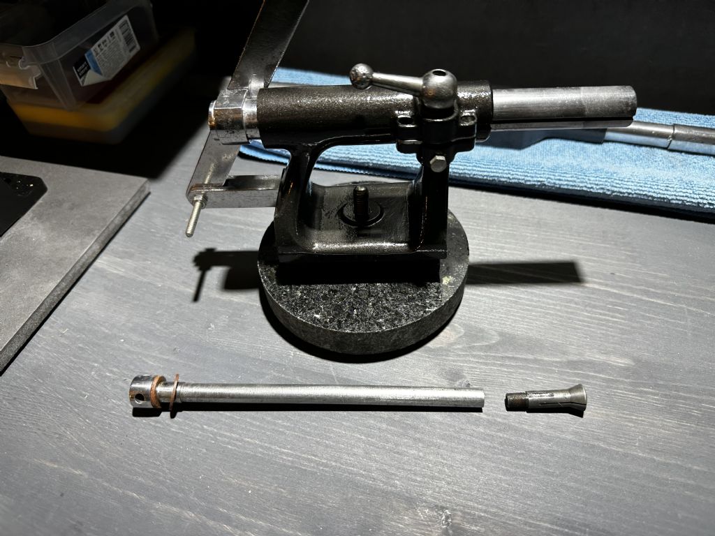

                                          here are some pictures of the 2nd tailstock

                                            #655291
                                            Bazyle
                                              @bazyle
                                              The catalogue picture linked by Vic shows the lever tailstock though it doesn't seem to have the round base of yours. I imagine it is a rather rare item.
                                              #655295
                                              James Jenkins 1
                                                @jamesjenkins1
                                                Is the round base not an added piece of granite or alike with a hole in it? I assume put there to protect it? Otherwise the cast piece looks the same form as the other tailstocks.

                                                  What's the underside of the tailstock like? If its in a similar sorry state you could machine it back and screw on a (say) 3mm plate. Turkite might work, a ptfe based polymer, comes in sheet form and you glue it on.
                                                  Edited By duncan webster on 05/08/2023 19:24:55
                                                  #655302
                                                  Simon Rundsvoll
                                                    @simonrundsvoll29363
                                                    The underside of the tailstock looks alright. It is not in the same state as the bed.
                                                    and yes, James is right, the 2nd tailstock I just placed on a piece of granite. It is not a part of the actual tailstock

                                                      By the sound of it, you may well have donethe correct thing; what is necessary to solve the backplate problem, by facing it (And the register? ) on the machine on which it going to be used.
                                                      Having the chuck located a few thou .further back is unlikely to be a problem, unless the backplate was already horribly thin..
                                                      Even if you decided later to machine a new backplate, you will be in a better position that when you started with regard to comcentricity and run out.
