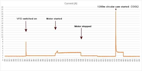

                              #791587
                              Stuart Smith 5
                                @stuartsmith5
                                The comments about VFD capacitor charging current made me decide to measure the one on my lathe.
                                It is a Warco Wm290v factory fitted with a VFD and 3 phase 2HP motor.
                                This chart shows the current when I switched the VFD on (approximately 6.4A) and then when I started the lathe motor.
                                For comparison, I started my circular saw which has a claimed 1200w motor. (starting current about 20A, ie about 4 times full load current)
                                The VFD charging current only lasted for about 50mS. (The time axis is in seconds)
                                Current charV2t
                                Stuart
                                #791595
                                Robert Atkinson 2
                                  @robertatkinson2
                                  Hi Stewart,
                                  Your chart didn’t come through for some reason.
                                  Your figures match what I would expect. Out of interest how did you make the measurements?
                                  Robert.
                                  #791608
                                  Stuart Smith 5
                                    @stuartsmith5
                                    The missing chart:
                                    07782291-49CD-4FA0-8A12-0A2ABCEB8237
                                    #791612
                                    Stuart Smith 5
                                      @stuartsmith5
                                      Robert
                                      I used part of this project:
                                      https://openenergymonitor.org/
                                      I made it a while ago to monitor my electricity usage at home. It was interesting but after a while, I stopped using it. It uses an Arduino shield and an Arduino uno with a CT round the meter tails and a plug in transformer power supply for the voltage sensing. This connects to a Raspberry pi which takes the readings and runs a web server so you can view the information in a web browser.
                                      For this measurement I just captured the output from the Arduino and put it in a spreadsheet to make the chart. It samples multiple times per half cycle and then calculates the values and outputs them via the serial port. For this chart I changed the default averaging to output the readings every cycle.
                                      Stuart

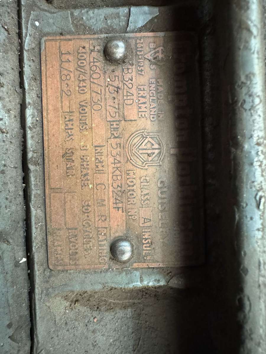

                                          #793397
                                          PutneyChap
                                            @putneychap
                                            Its a DSG 17 lathe motor – DSG has a clutch, so the start load will be light.  I don’t have the lathe yet – although I bought it.   Its looks like a STAR start, then Delta.    But not 100% sure on that – I attach a photo of the motor plateDSG motor plate

                                              #793401
                                              PutneyChap
                                                @putneychap
                                                So these motors were pre vfd.   Would a STAR connection, which is then (manually) switched to a Delta provide the 2 speeds? , which would be implimented in the switch gear on the control pannel – changing the path from star to delta – and back – or , would there have to be poles in the windings switched in ? 2 pole / 4 pole?
                                                I am no motor expert (clearly).    I am looking at 10kw genset, and hoping that the star no load start will only drop the voltage momentarily – and that once its running then the clutch will allow me to leave it running no load while I setup etc.  I could get a 30kw genset – the issue would be, idling generators at very low load is very bad for their longevity (so I am informed) – so that is why I started this thread – how close to the max motor running load  (5.5 kw) can I get away with.   It maybe that I get a 20kw 1500 rpm generator and just accept the reduced engine life
                                                #793407
                                                Julie Ann
                                                  @julieann
                                                  Induction motor speed has nothing to do with star/delta connections. The speed is controlled only by supply frequency and number of poles. Looking at the motor plate speeds, and a 50Hz supply, the motor is 4 pole/8 pole in high and low speed range respectively.
                                                  If the number of poles is doubled and everything else stays the same the motor output power halves; same current and torque, but half the speed equals half the power.

                                                  PutneyChap
                                                    @putneychap
                                                    Tx Julie – so you think – from the plate its 4 pole 8 pole – and its STAR (series) supply all the time, so the control switches would power the 4 pole – startup, half the torque, half the speed  – half the current?, then there will be a switch on the lathe electrics to add power to the other 4 poles (now 8 in total) -which both doubles the speed – and also doubles the power – do I have that right?
                                                    So – the power connection – to the genset in my case is always star (as per the motor plate) – and I need to size the genset to  start – 4 pole – and then switch to 8 poles – if I need to.
                                                    I will need to hire a genset say 8kw  – and measure the input voltage drop – for the current draw- and work out what I can get away with
                                                    #793411
                                                    noel shelley
                                                      @noelshelley55608
                                                      2pole is 2800, 4 pole will be about 1450, a 6pole is about 960, so 750rpm looks like 8 pole and 16 for 350 ?
