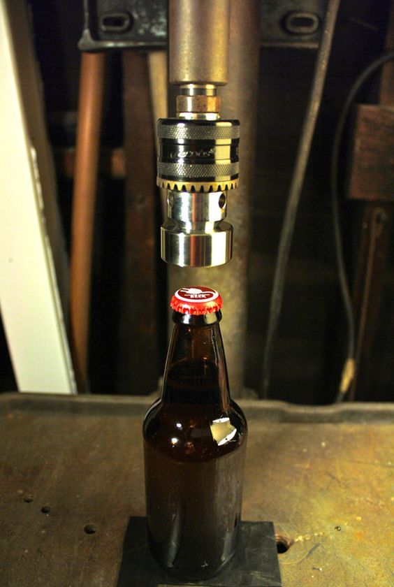

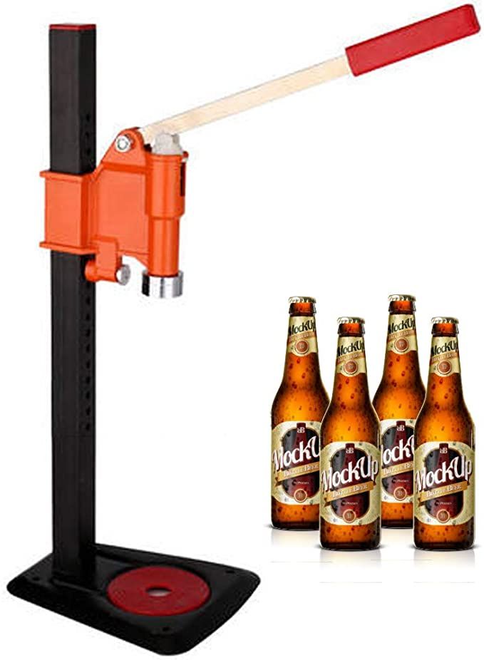

                  142kgf to is a small load. Some of us weigh that much. Hydraulics would crush the bottle ?
                  Whats wrong with the inexpensive hand press for capping bottles ? Quick, easy and available on ebay for about $30.
                  Or make an adaptor to fit the bottle cap and use a drill press.

                      Goog grief! I bought a small gadget from Boots with the closer on a small wooden handle sticking out the side, you put the cap blank on the bottle, the gadget on top, and gave it a smart blow with a mallet. Never broke a bottle, worked fine.

                                        I'd go for off the shelf bottle cappping machine, windscreen wiper motor and a spring. Have a number of spring attachment points on the lever to change applied force.
                                        You can even use the park switch on the motor to run a single cycle everytime you press a foot switch. Most will give a choice of speed too.

                                              Exactly.
                                              Mine was about £8 with 100 caps. Takes a couple of seconds per bottle and barely any effort.
