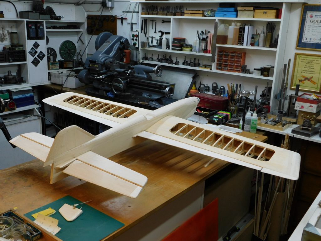

My 'achilles heel' has well and truly struck again – control line flying that is so I've been well sidetracked on these two control line aerobatic models.

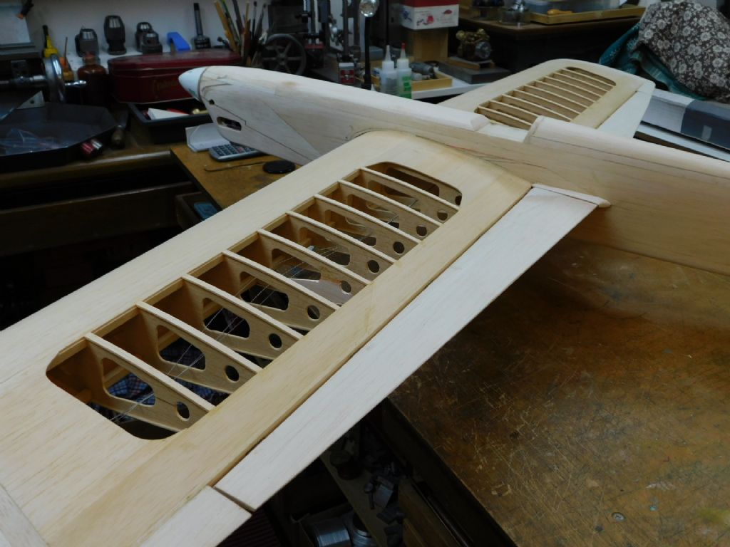

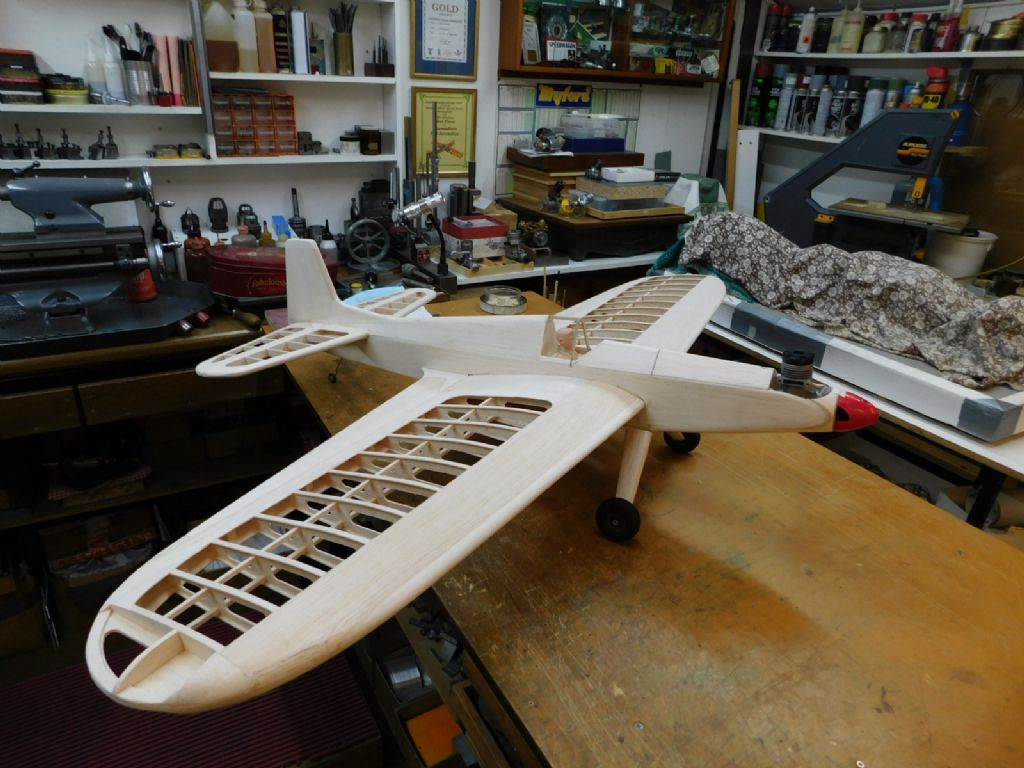

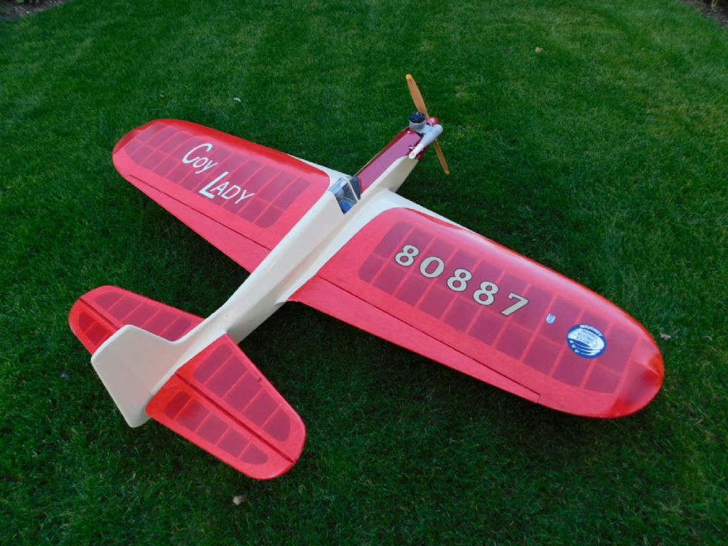

'Coy Lady' by Ray Brown. Featured in a 60's Aeromodeller and always a favourite 'Classic Period' British design it's only taken me near sixty years to get round to making one!
Still as yet to be covered and painted it's powered by a Stalker 40 glow motor

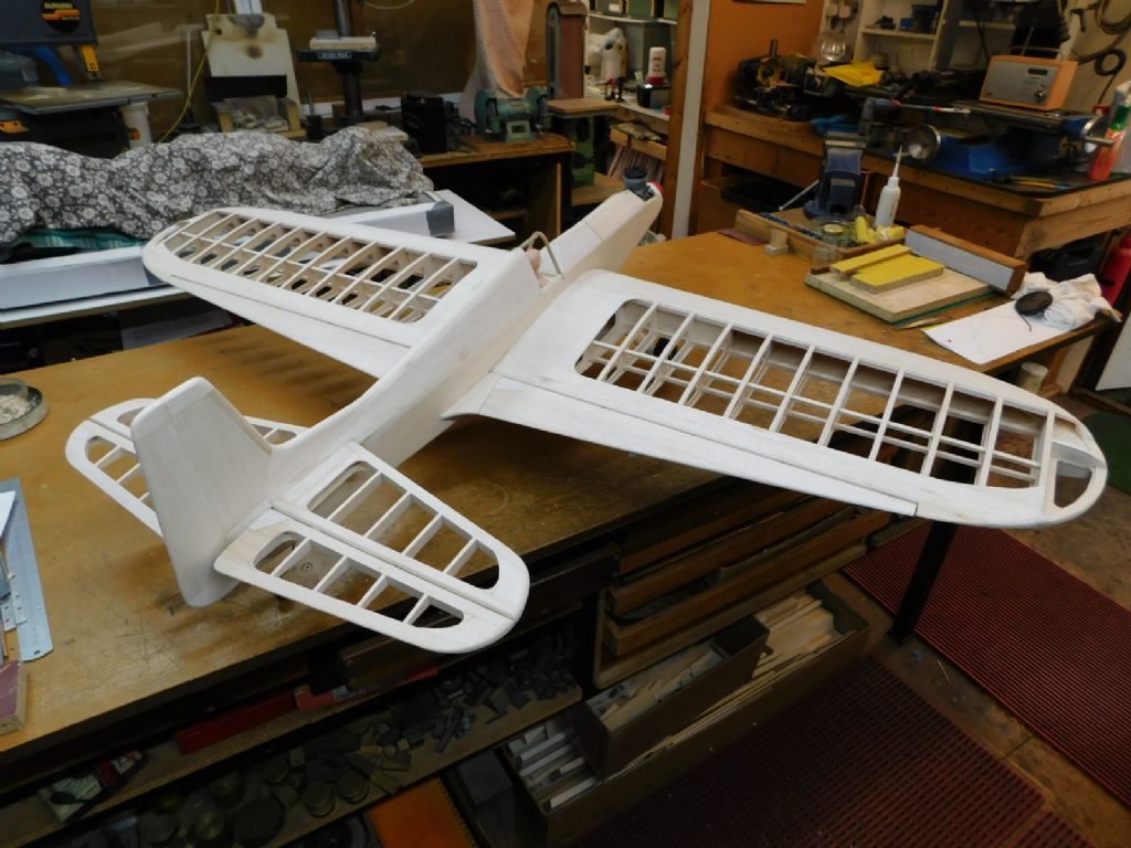

The last few weeks has been busy putting this together – a 'modern' design this 'Intrepid XL' is a much larger American design of 60 inch wingspan

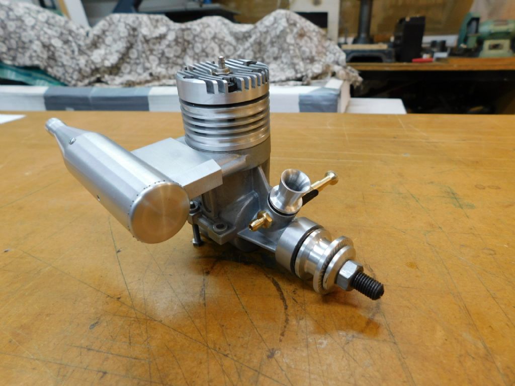

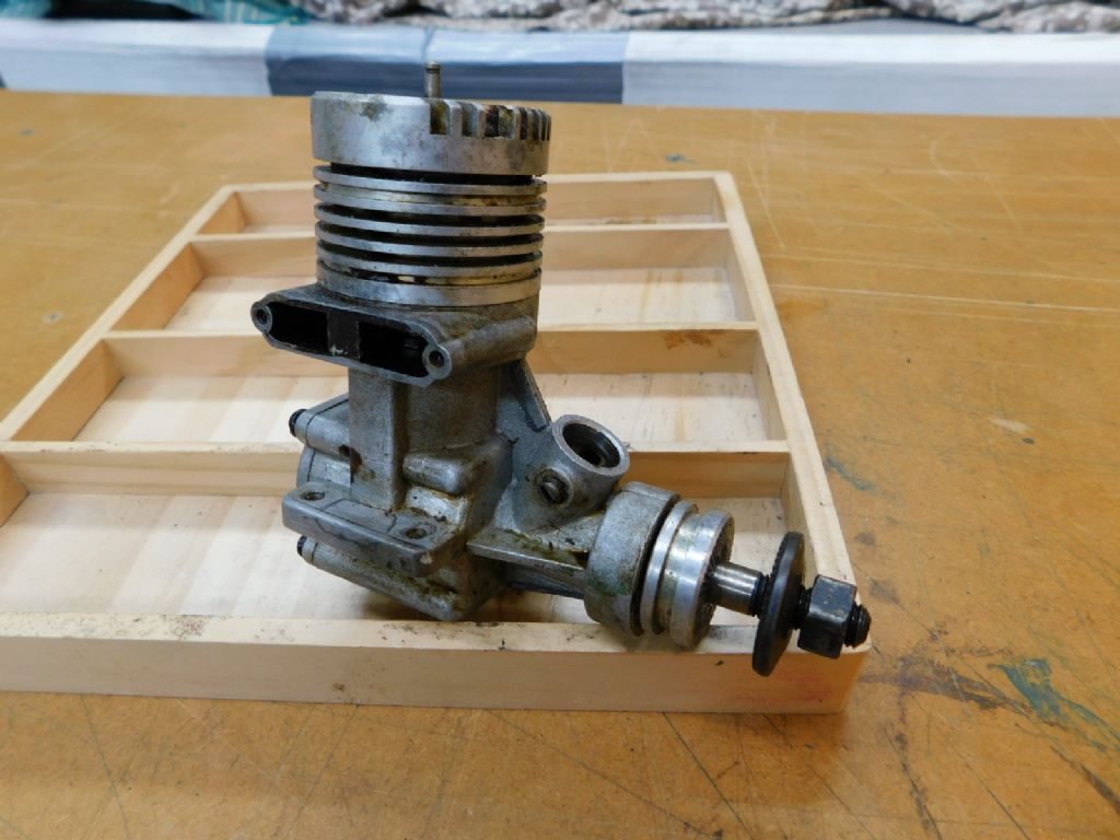

Powered by a recently rebuilt Merco 60 10cc motor this is the largest control line aerobatic model I've built over the years. Really noticeable in the workshop as it finds all the high spots as it get moved about.

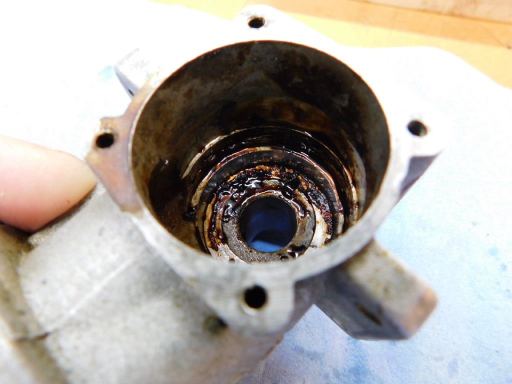

The Merco was a well used R/C version completely gummed up with old castor oil
But after a total strip down I machined the case to decrease the weight and fitted new bearings. The silencer is also home made in order to save weight
The piston has a single ring but no work was done on piston and liner at this stage save to thoroughly clean them.
Piston seal could be better but it didn't take long for it to bring a big grin on
Hope that's of interest to someone – certainly kept me busy this last few months. Hope to have the Coy Lady finished and flying in the next few weeks but the other one is going to have to wait a bit before I get to that stage
