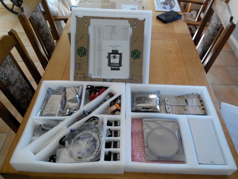

It took about three evenings to assemble about 500 parts. Some minor niggles with the assembly such as wrong size screws specified in places, square nuts used for assembling the laser cut acrylic frame too wide to fit some of the slots in the frame. The round rails for the x-axis wouldn't fit in the holes in the metal end brackets which had to be opened out with a rat-tail file. Nothing too taxing to correct.
