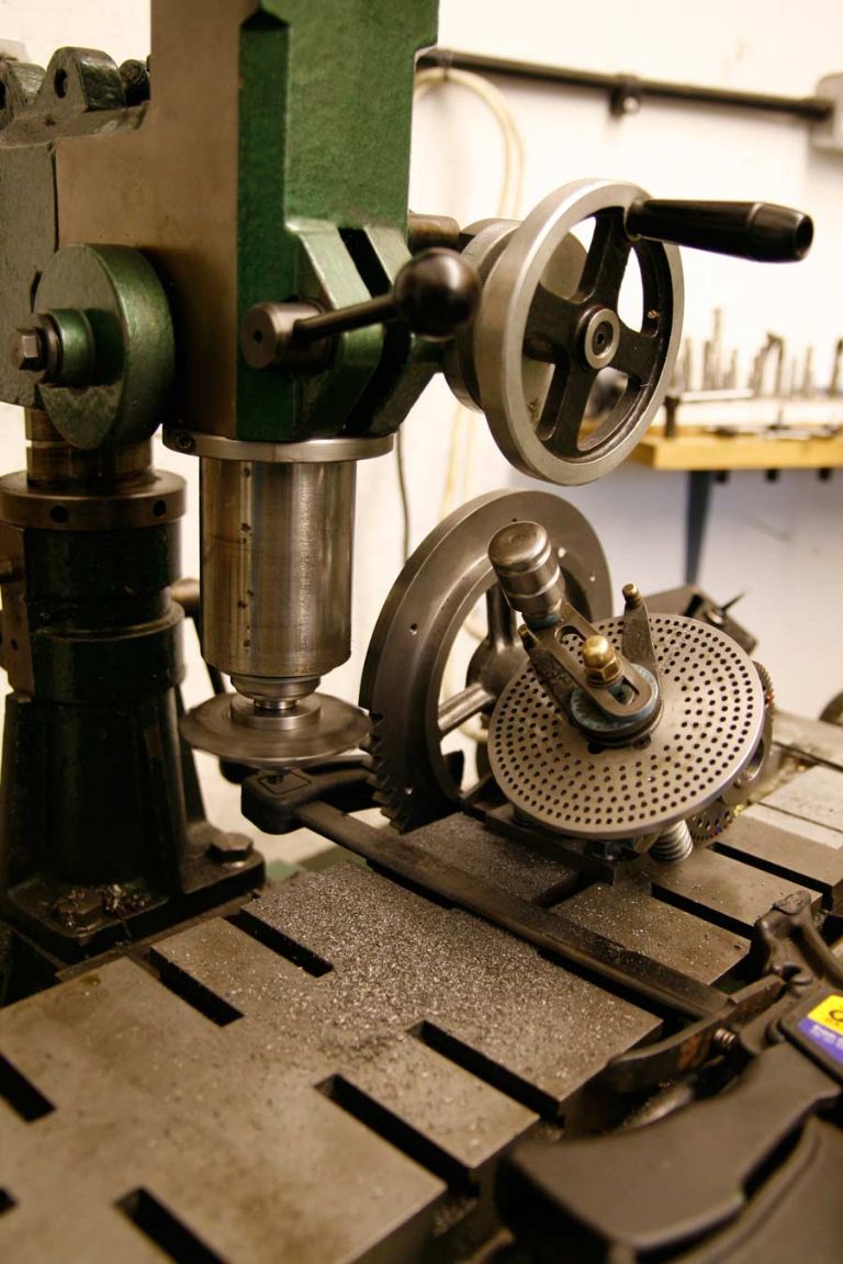

        Anyone done any gear cutting with a milling cutter. I did some proper gear hobbing in my apprenticeship days many moons ago but my workshop won’t run to that. Not found any supplier so far that does such a cutter.
        I have Tubal Caines hand little book and it states that the type of cutter determines the size of gear you can cut (or visa versa I suppose)
        Bill D.
        #46079
        mgj
          @mgj
          Yes- its quite easy. if you need good info, Ivan Laws book from the Workshop Practise series covers all we would ever need about cutting gears on a vertical mill.
          Tracy tools do cutters in DP sizes. They are about £16 each. You will possibly need more than one cutter because each cutter only does a limited range of teeth numbers.
          Buy the right cutter, set up on centre height against the dividing head, apply the infeed for that DP. Cut.
          This shows the Dore Westbury being stretched (nearly) to the limit on my Little Samson  Second motion gear. I had to hang the gear (and final drive gear which is bigger) over the edge, and then used a clamp to hold the gear against the edge of the table. So the dividing head did the dividing and the table took the cutting thrust. I forget how many cutters I bought to do the full range of gears. 3 I think.
          There is a driving dog in the arbour by the way.

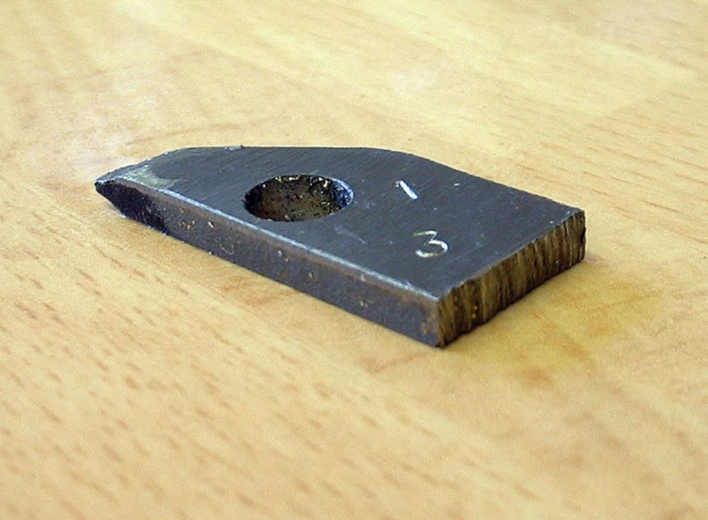

                    I’ve made single-point cutters using Ivan Law’s method. They worked 100%:
                    Tom Walshaw (Tubal Cain)  was a sceptic and took the approach of hand-filling a cutter to match another gear of the same pitch and similar number of teeth. When I needed a 63-tooth changewheel for metric screwcutting on my lathe, I tried this using a 60-tooth changewheel as a pattern. the result was excellent IMHO:
                    (unsharpened but hardened cutter filed from 1/8 gauge plate)
                    All you need for gearcutting success is the patience to understand the instructions, do the calculations and take your time with the cutting.

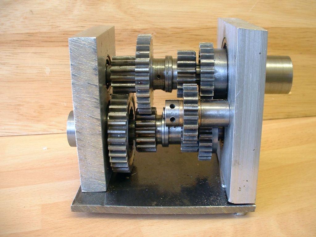

                      If you look at the pictures in my album you will see a myford gear box I am working on
                      All of the gears were cut on a vertical mill using 20 DP cutters I made on my lathe.
                      The cutters were made from gauge plate using the button method which is decribed in  Ivan Laws book.

                        Those cutters look enviably good. I keep thinking of making a ‘Eureka’ but your buttons don’t look like they were designed for one.
                        What method did you use to relieve them?
                        #48653
                        mgj
                          @mgj
                          They haven’t been form relieved have they ?
                          #48658
                          Tomk
                            @tomk39956
                            Bill
                                      The cutters in the picture  are relieved at the bottom is the mandrel that was used to relieve the cutters. The cutters are first turned as blanks using the buttons to ruff out the forrm.
                            The slots are then cut. The slots are used to time the the cutter on the mandrel. 1 tooth at a time is releived. You must watch the depth you feed each cut to ensure all the teeth are the same from the center.
                            The method I use for the first tooth is to put marking blue on circumference and relelieve this first when all the blue us removed note the reading and then rotatate each tooth and releive to that depth.
                            The second part is to set up the buttons and releive to the calculated depth of the form.
                            one tooth at a time.
                            I have put up 2 more pictures of the releiving mandrel that may help you.
                            One more point the diameter of the cutter is important, when relieving you must make sure that the tool does not foul the next tooth.

                                The relieving mandrel I used was designed for 2 inch (50 mm) cutters.
                                This link takes you to the information to produce gear cutters using the method I used
                                Tom
                                Edited By TomK on 14/02/2010 22:17:34
                                #48664
                                mgj
                                  @mgj
                                  Tom my apologies- thats very neat – by how many thou has each tooth been relieved.
                                  #48666
                                  Tomk
                                    @tomk39956
                                    Meyrick
                                                   I checked the dimesion on the cad drawings I did for this and it shows that on the cutters I made  from  the cutting edge to the trailing edge of the tooth is 0.021 inch clear.
                                    I used the cad rotating fuction to check my dimesions and it shows that the tooth clearance is ok. When using the cutters there is no sign of rubbing on the cutters.
                                    I have added a link to my previous post which shows a method of how this type of cutter is made. I just modified it from a 4 to a 5 tooth and used cad to work out the dimensioning
                                    One other point I have only used this mandrel to make 20 dp 2 inch dia cutters I have not checked it out for other DP size cutters
